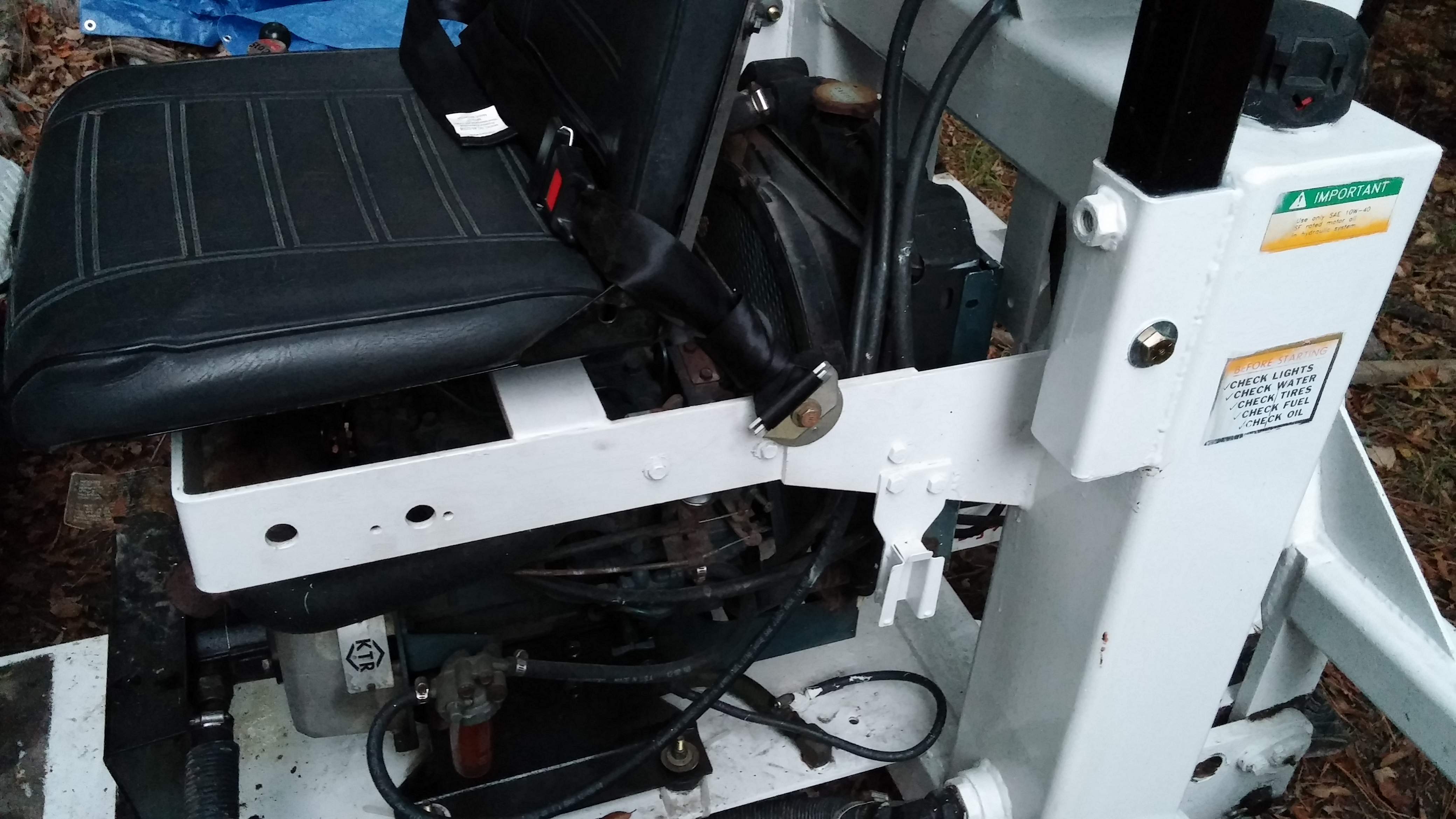

Over the past week we've got it to about 95% done. The mount that connects the bucket to the the cylinder was a little tweaked and my brother would like to replace it, so that'll be the last thing to get it going. Other than that we just need to clean it up, touch up some paint, weld the fenders on, run some lights, and put on the fresh decals.
Now we're interested to see how this little guy digs.
I'll post up some more pictures when it's complete.

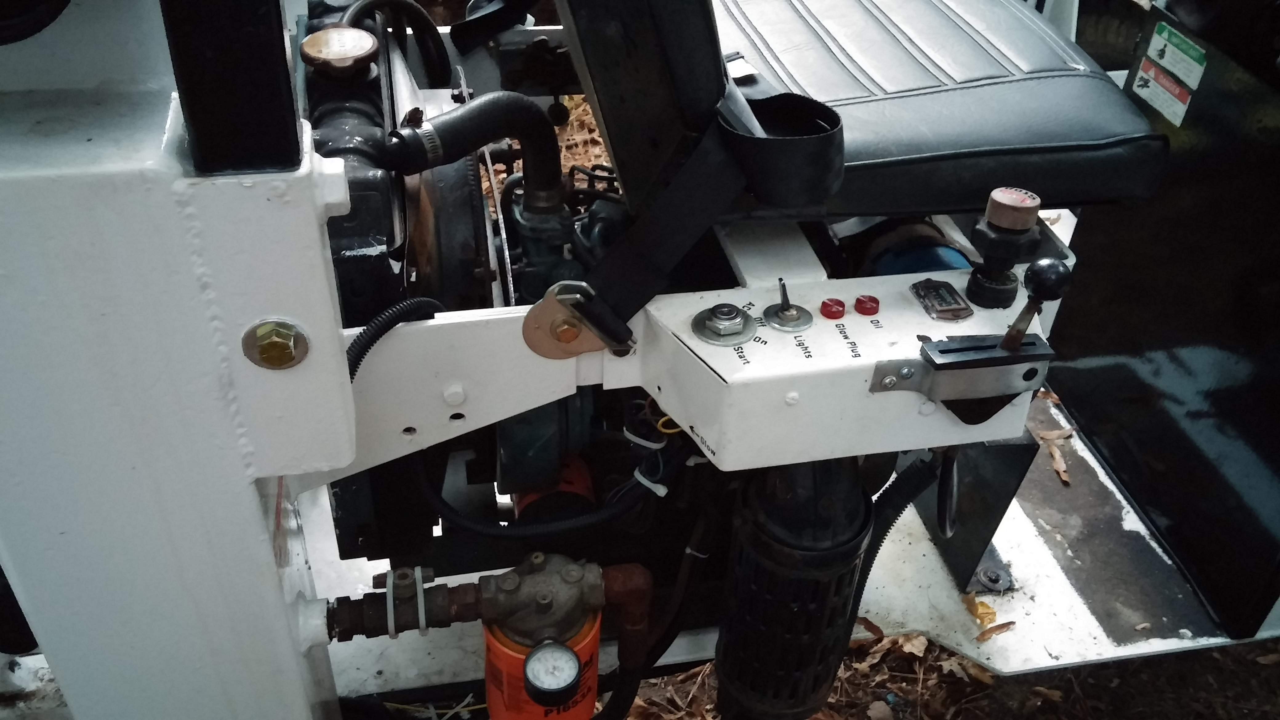

Attached are some pictures, only things left to do are wire on the led tail lights and put the hour meter on. This thing has been a lot more work than we thought when we bought it. We ended up replacing the front outrigger cylinders as well, they were seeping and we found a standard size one that worked with a little grinding.

The valve block we just used a wire brush and cleaned up. My brother opted for the multi control, it allows you to dig with just two of the sticks instead of 4. I'm not sure if your's has this but ours didn't and I could see it being very cumbersome to use in that configuration.

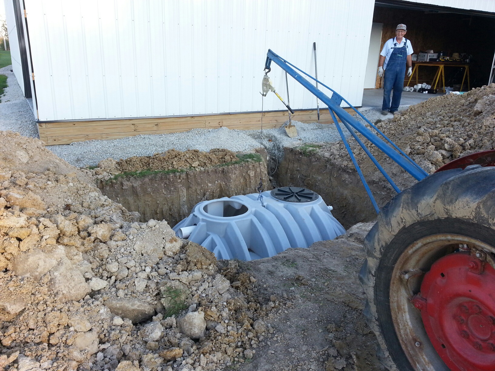

Here are some of the project we've used it for. The cistern was about 7' wide x 10' long x 7' deep hole. It took about 4-5 hours to dig. The hardest part about digging something like that is finding a place to put the spoils. It would have been handy to have another person on a skid steer moving the spoils out of the way.
