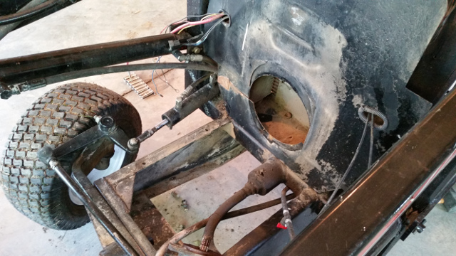

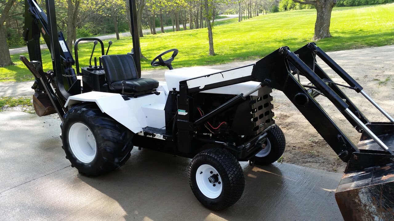

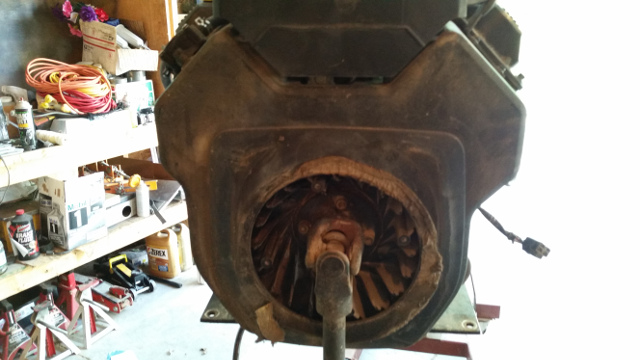

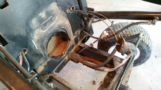

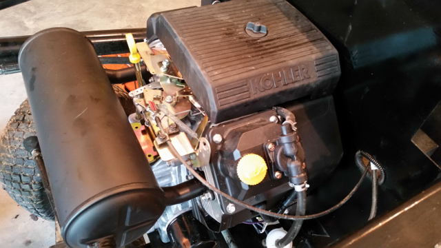

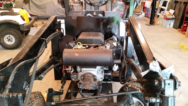

Got the wiring all done. The generic ignition harness was too short so I ended up purchasing new wire, terminations and plugs and made my own. Ended up being around 30" long instead of 18" I had a couple of wires backwards on one end of the plug. Found that out when I tried to start it and it would not do anything. I had the yellow(mag) and the red reversed. Figured that out by plugging the ends together and that is when I realized my error in ways. I thought I had followed end to end but some how I had screwed that up. So, new switch is in and all new wiring. Waiting on a new knob for the throttle as the new cable did not come with one. Ordered a new hour meter as well. The old one works but wanted to start over with the new motor. I moved a pile of dirt last weekend and she works like a new one. I have a hydraulic leak some where in the back boom but it is pretty small and I keep a drip pan under it. I bought my brother's half out so I am the sole owner now. Doubt at this point anyone will read this but wanted to pass on the latest. Great little rig if you ask me.

Congrats on the repair work and successful completion :)
/ dig it 198t transmition problems #23
Thanks. Put the new hour meter in last night. She is all ready to roll now.
Steve

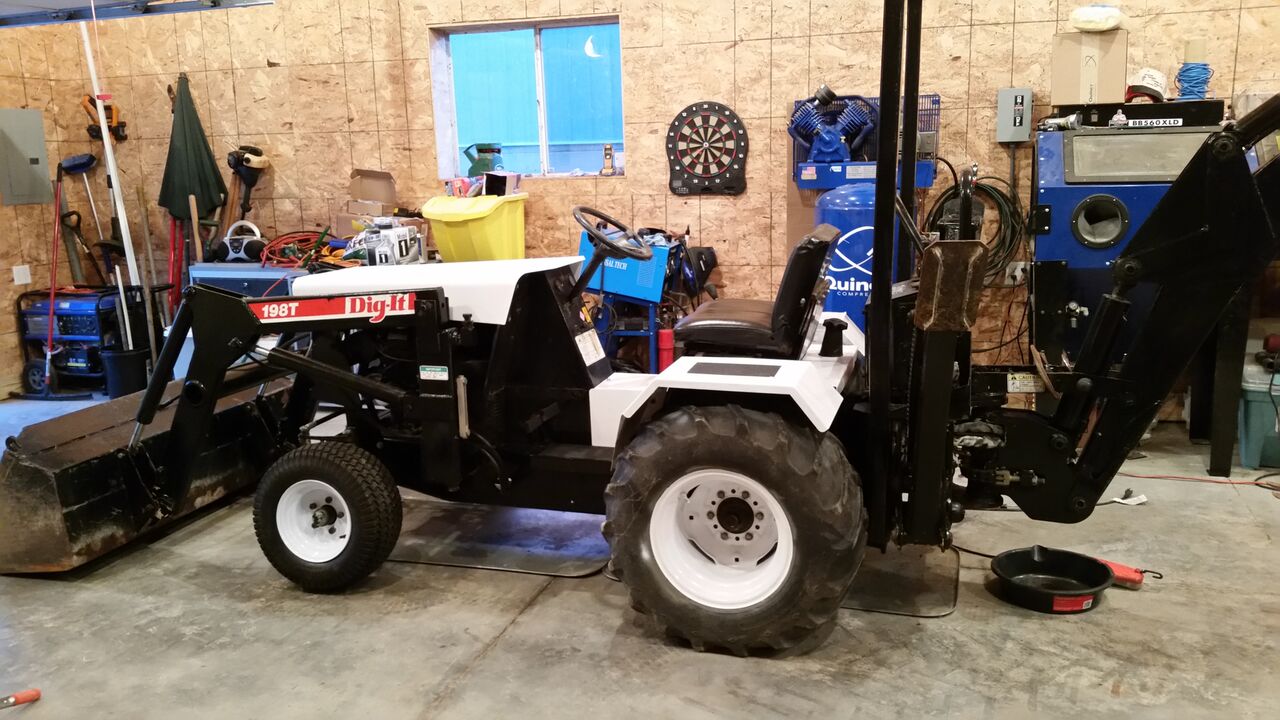

Still keeping this thread alive as my digit 198t is still going strong. I was digging a spot out to move a carport to last week and blew the seal on my dipper cylinder. I had one of the bucket cylinders rebuilt a few years ago and it was expensive. This one is bigger so I figured bigger means more money. I decided to tackle the rebuild myself this time. There were no scratches or nicks in the cylinder rod so I figured what did I have to lose? I used Heartland to source the new seal kit. You will need the serial number off of the cylinder so they can get you the correct kit. I could not find the serial number until I removed the cylinder completely. This cylinder has a gland rod holding the gland in place. You need to use a spanner wrench to turn the gland clock wise to extract the pin. The gland pin has a 90 degree at one end that fits into a whole in the gland itself. Once that is removed the entire cylinder rod can be removed from the cylinder tube. I had a bit of burring where the gland sits which made mine a bit difficult to extract. Once I got rid of the burr the entire assembly came out. On the back end there is a piston with a big nut on it. You will need to remove that to slide both the piston and the gland off of the rod. That nut was torqued to 240 ft lbs so I used an impact to remove it. I have a very big torque wrench that goes to 250 ft lbs for reassembly. Bought it years ago working on a Z car rear end. Carefully remove all of the old seals and keep them in order of removal. Most of the seals had disintegrated which is why I had a leak. Good idea to take a picture just in case. Clean the parts thoroughly and work in a clean environment. Reassemble the seals and o-rings just like they came off. I used oil to lube up the parts as that is what the digit uses for hydraulic fluid any ways. The inner gland seal is a single piece called polypak. You cannot get this seal in without a special tool. The seal goes in an inner groove in the gland and is bigger than the hole it goes into. This tool deforms the new seal so you can get it in the gland and pop it into the groove. There is no way you are going to get this seal in without damaging it. Get the tool. Once reassembled clean the snot out of the rod and slide the gland on first and then the piston with its new o-ring and seals. Torque the nut to 240 ft lbs. I actually temporarily hooked up one end back on the machine so I could torque that nut. I almost ripped my vice off of the bench trying to do it that way. Slide assembly back into the cylinder tube generously oiling as you go. It will be stiff due to the new seals. Line up the gland so you can see the hole the new gland wire hooks into. Insert the new gland wire and with your spanner wrench rotate the gland counter clockwise to roll the gland pin into its groove locking the gland in place. Reinstall on machine and hook up hydraulic lines. Top off hydraulic fluid and you are back in action. I am not afraid to rebuild any hydraulic cylinder going forward and I know I saved a ton of money. Thank.
