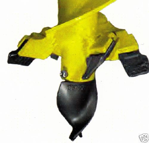

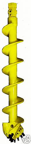

Are you using an aggressive starter bit like these?
My bit looks a lot like the center bit in your photo. My auger is not big enough to have the outer teeth like that one though.

Can you show us a good close up picture of the cutting bit.
