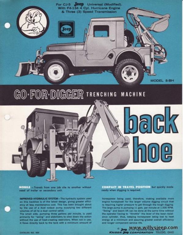

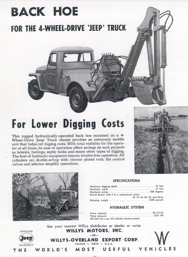

Track hoe is a tracked machine with a hoe, typically no loader bucket, but some times a push blade on 12 ton and smaller models. Back hoe term can be used for a rubber tired hoe/tlb/combination as well as for a track hoe; the "back" hoe term refers to the way it digs, back towards the machine. Excavator is typically used as a term for a track hoe, but isn't limited to a specific type. There are some odd machines out there, such as a crawler type tracked dozer with a rear mounted hoe, JCB I believe made/makes an articulated front end loader with a hoe. There are "Gradalls" that could technically be called an excavator or even a back hoe, but would normally be called a gradall. There are also "spyder" excavators, heck I think there was a jeep with a hoe at one time.
Power shovels dig up and away from the machine, typically used in a pit, digging at the walls as in a mine.

Yep, there was.
