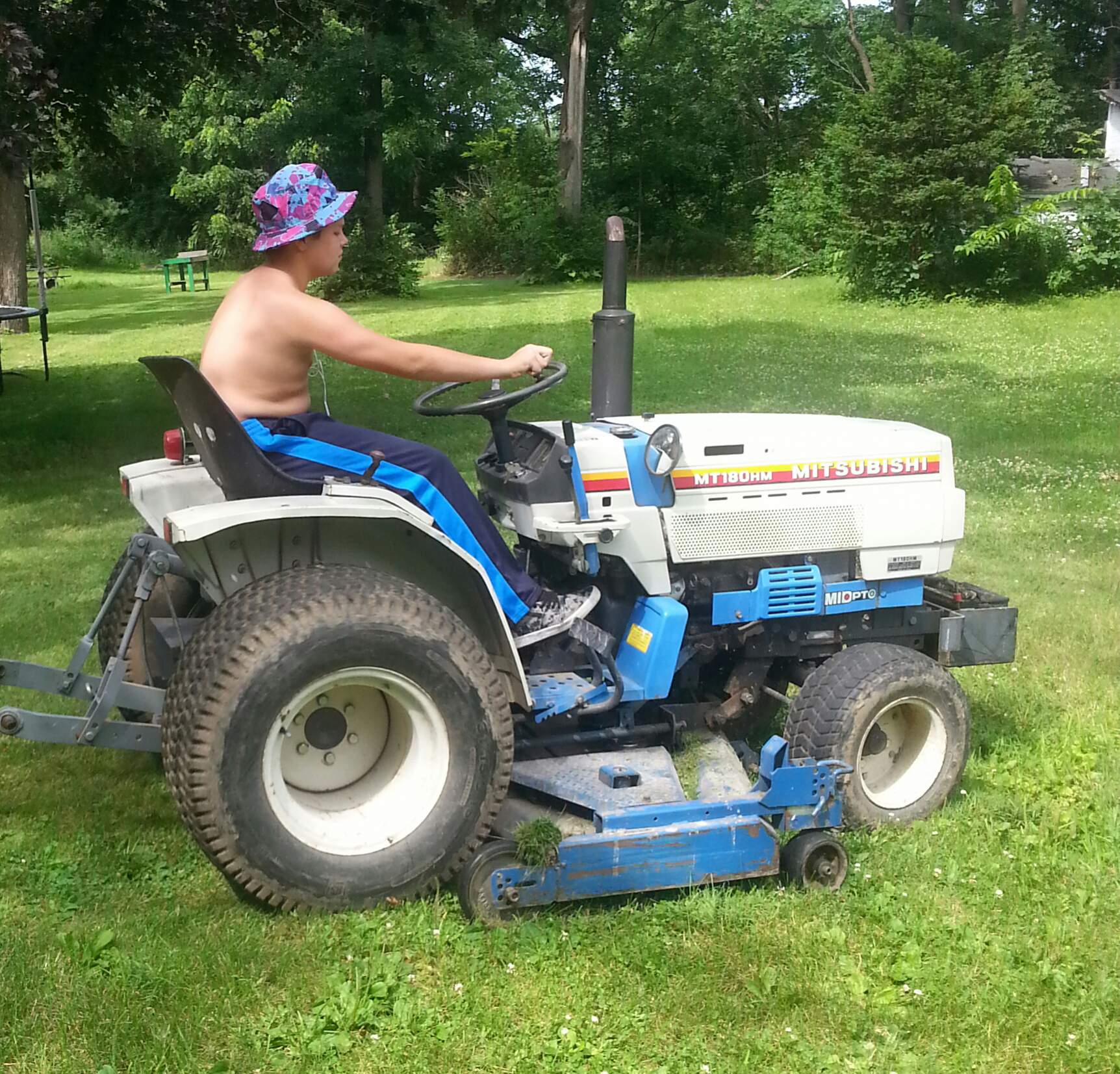

Yea, wondering why mine is labeled MT180HD.
It is two wheel drive and hydrastatic trans.
I have learned that "D" means 4wd, but not on mine.
I rarley see mention of an "HD"....but so it goes.
Mine goes good now you guys on this sight helped me
CooHead
/ difference between mitsubishi MT18 and MT18D #9
Correction:
I knew when I typed that "MT180HD" didnt sound right so I went and looked.
MT180HM it is.
NEVER hear that mentioned.
it is 2wd and hydro

HD means hydrostatic, it is different from the D designation. I am not actually sure there were any 4wd hydrostatic, my manuals do not indicate that there were.
/ difference between mitsubishi MT18 and MT18D #12
Nice pictures, wish I had a mid-mount mower.
