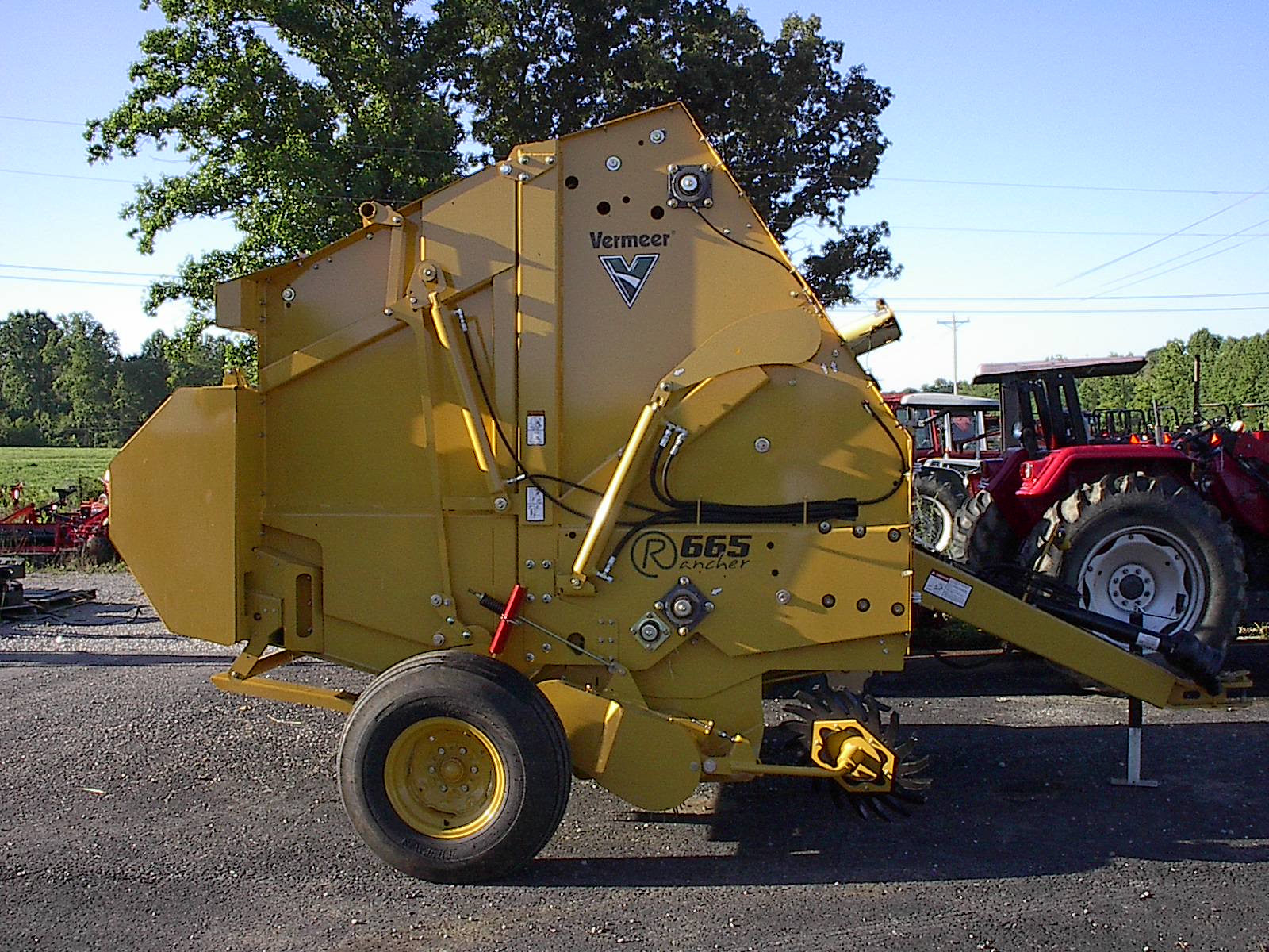

Absolutely no difference in time it takes to tie. Netwrap is the same and Vermeer 665m Rancher can fee 4 strings at once and the JD can not. We have a new one with 100 bales on it for $22,500. IM002283.JPG

To answer the original question, the Rebel 5500 makes 5ft wide, by up to 5ft tall bale and is designed for dry hay, the 665 Rancher makes a 5ft wide, up to 66" tall bale and can bale silage or dry, the 555XL makes a 5ft wide, up to 5.5ft tall bale either wet or dry. The rancher is newer by far then the rebel or XL.
