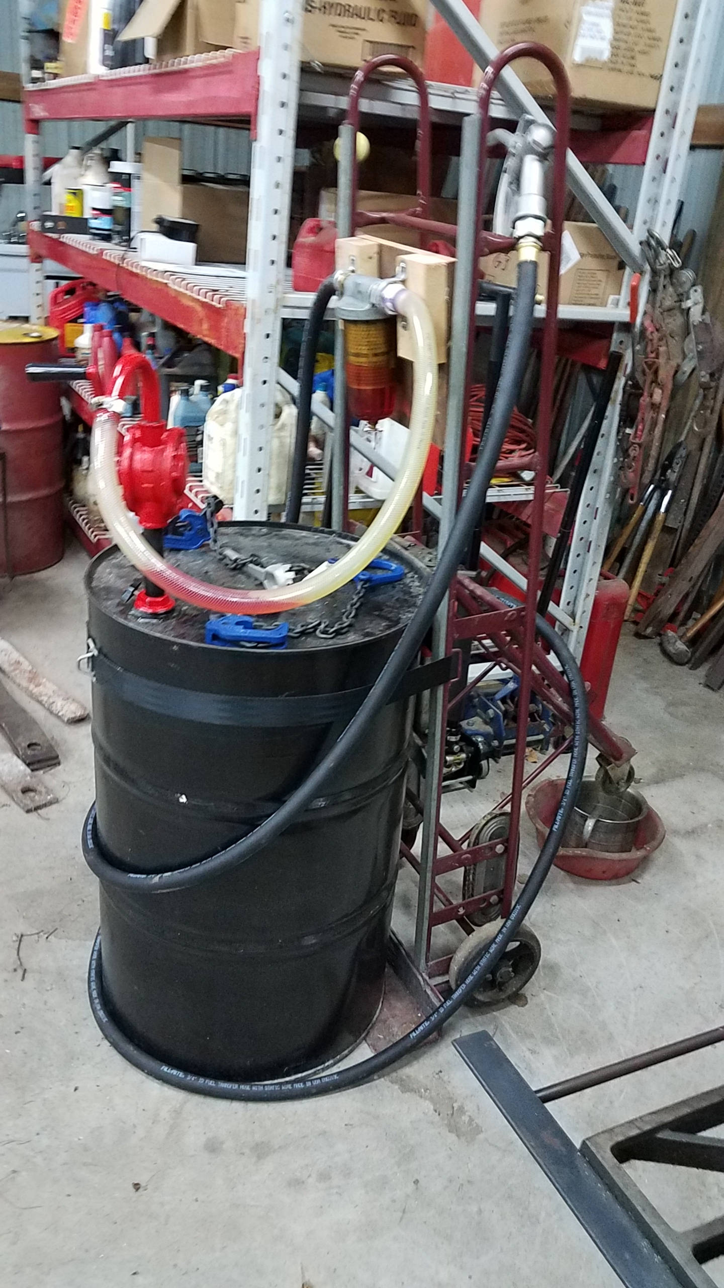

Personally I would rather use a 45 gallon drum with a barrel pump.

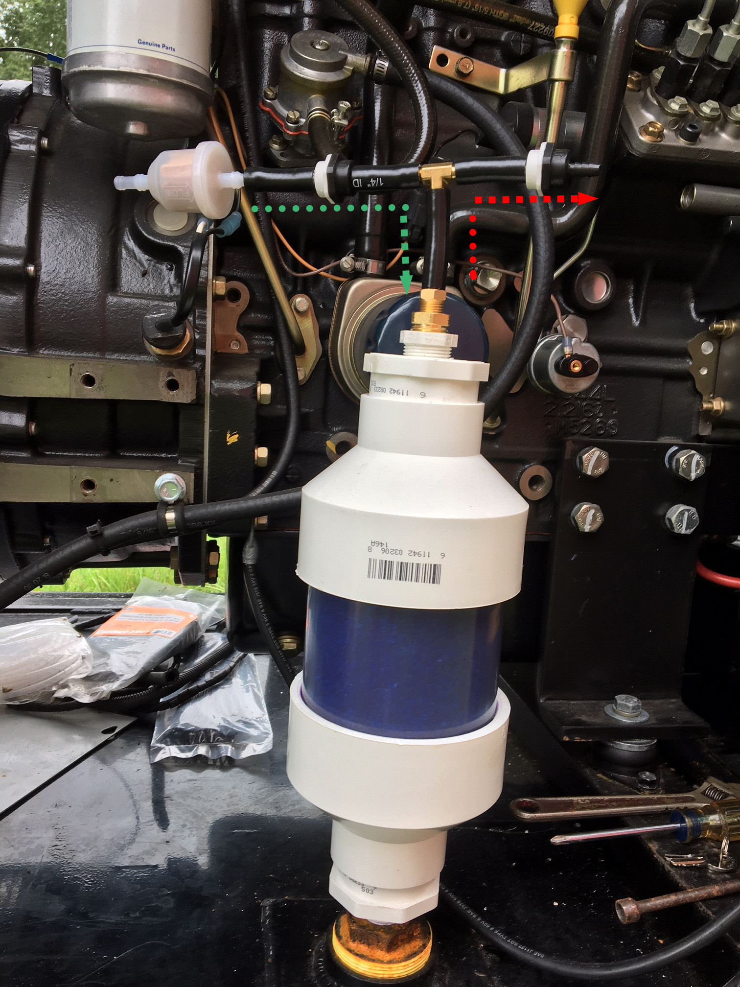

So you've seen lots of options. The most important is venting and temp control. The longer the fuel sits the worse the problem. The most critical is generator stored diesel, could get very old before needed, in those cases a check valve, drier breather vent is important

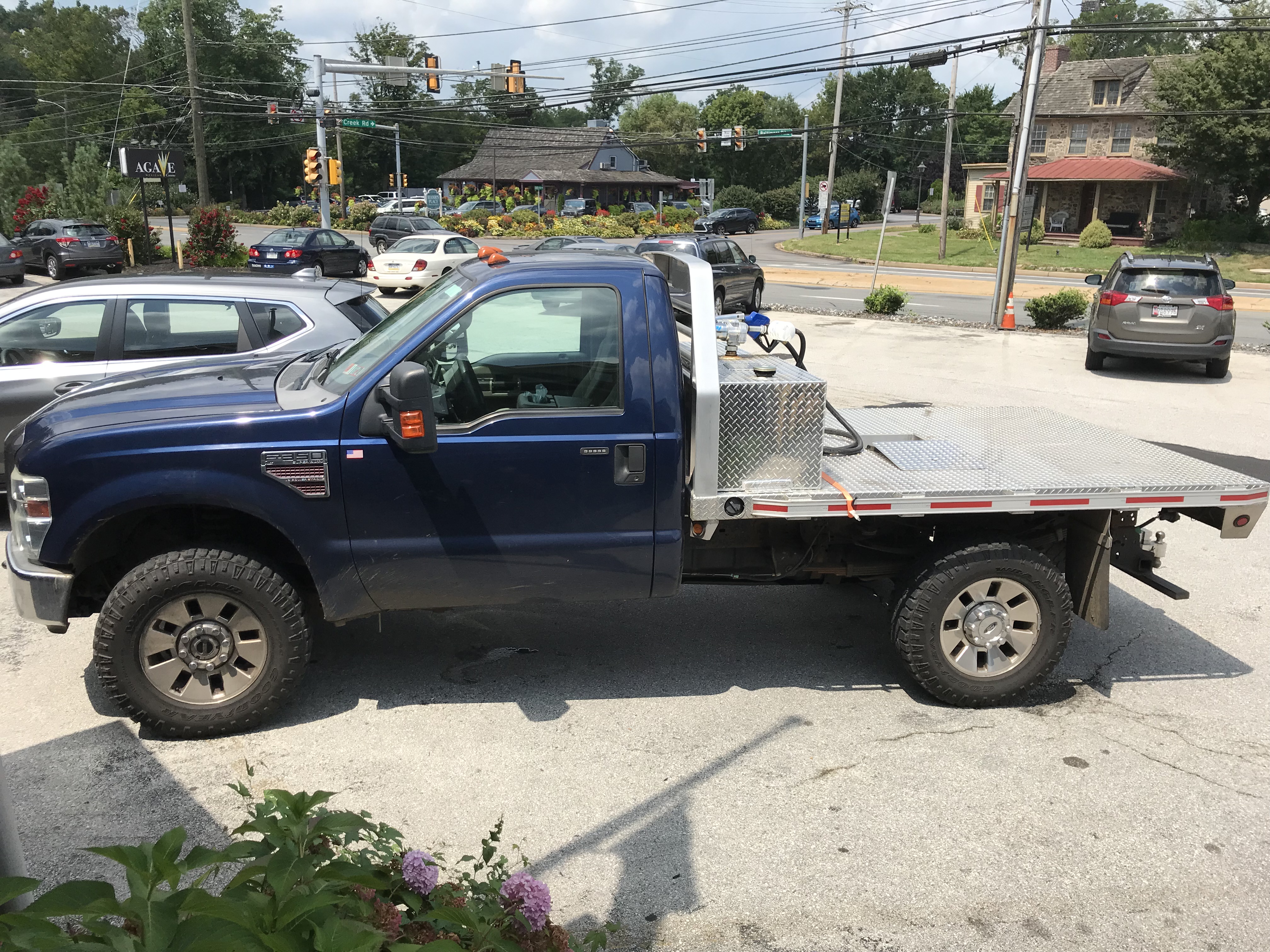

9 footer.
Martin aluminum diamond plate.
Truck is for sale.
