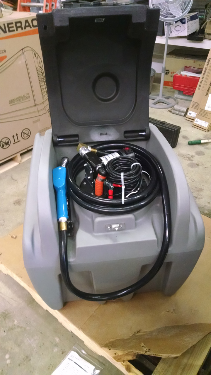

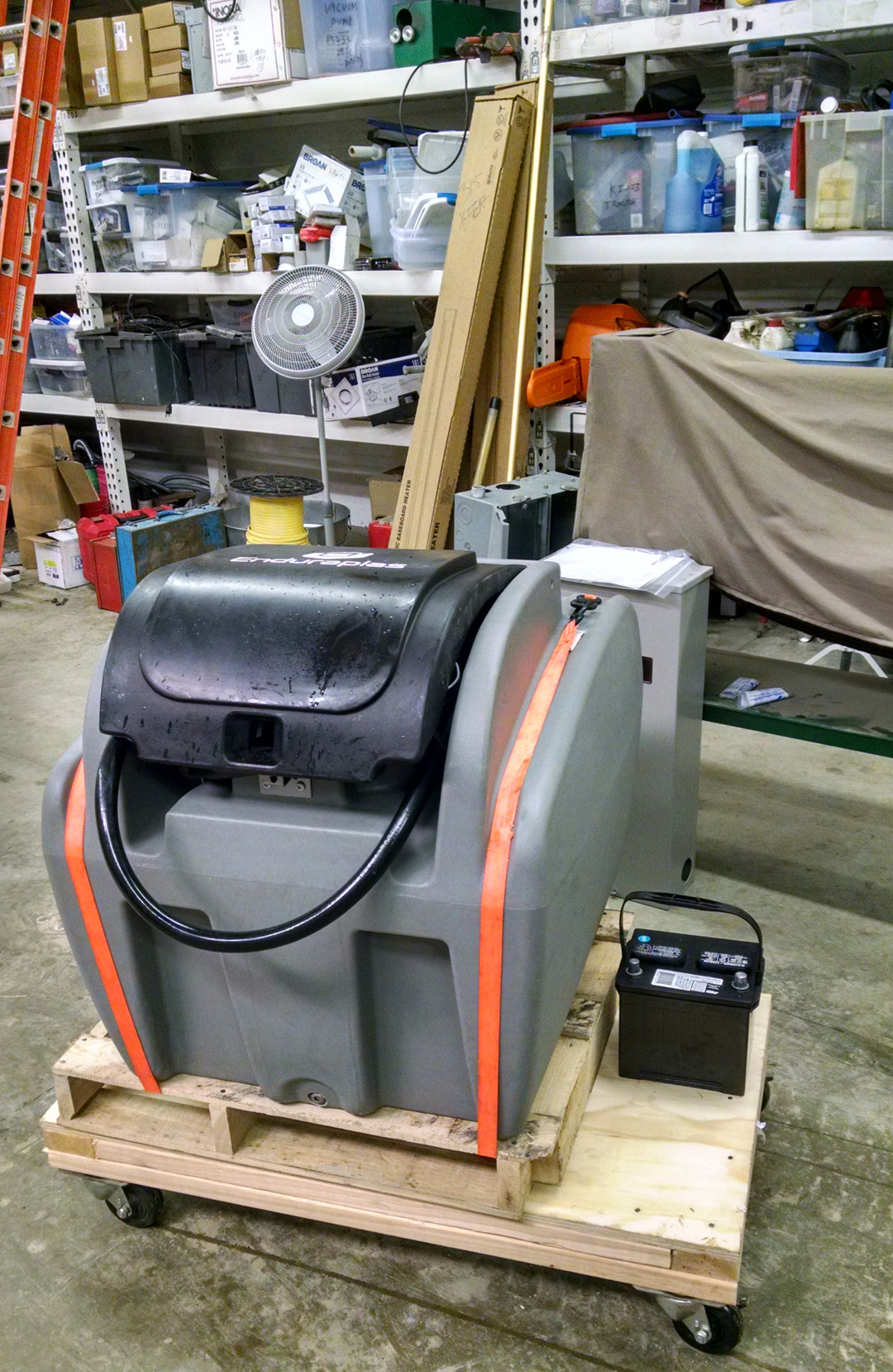

i have a poly 55 gallon tank myself. fuel 1.jpg fule 2.jpg. easy to offload onto truck to refill, in the shop the pallet is on wheels to easily move.

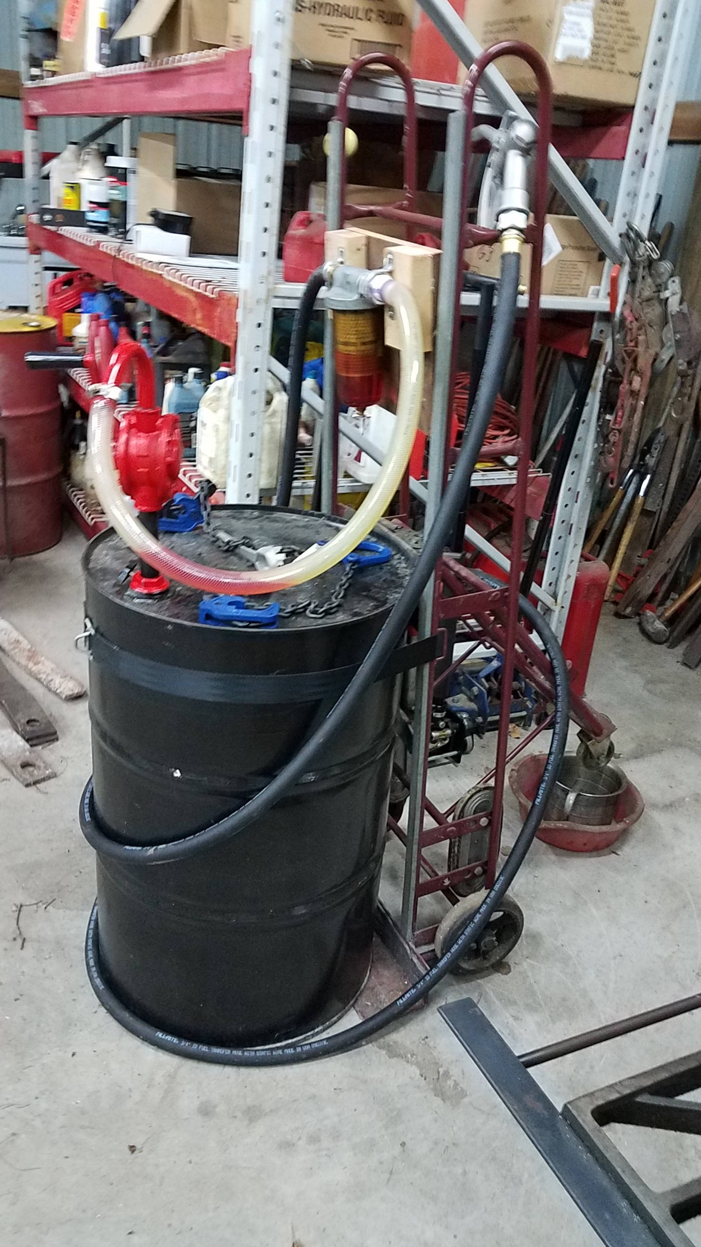

Using two 55 gallon drums here. I have off road delivered two or three times a year.
I go through about 300 gallons a year between the tractor, backhoe, and generator.
I use a $65 pump with hose and nozzle. The first pump ran great for 3 years before it started leaking. The replacement is not liking when I close the nozzle. I need to tear my original pump down and see if I can get seals for it.

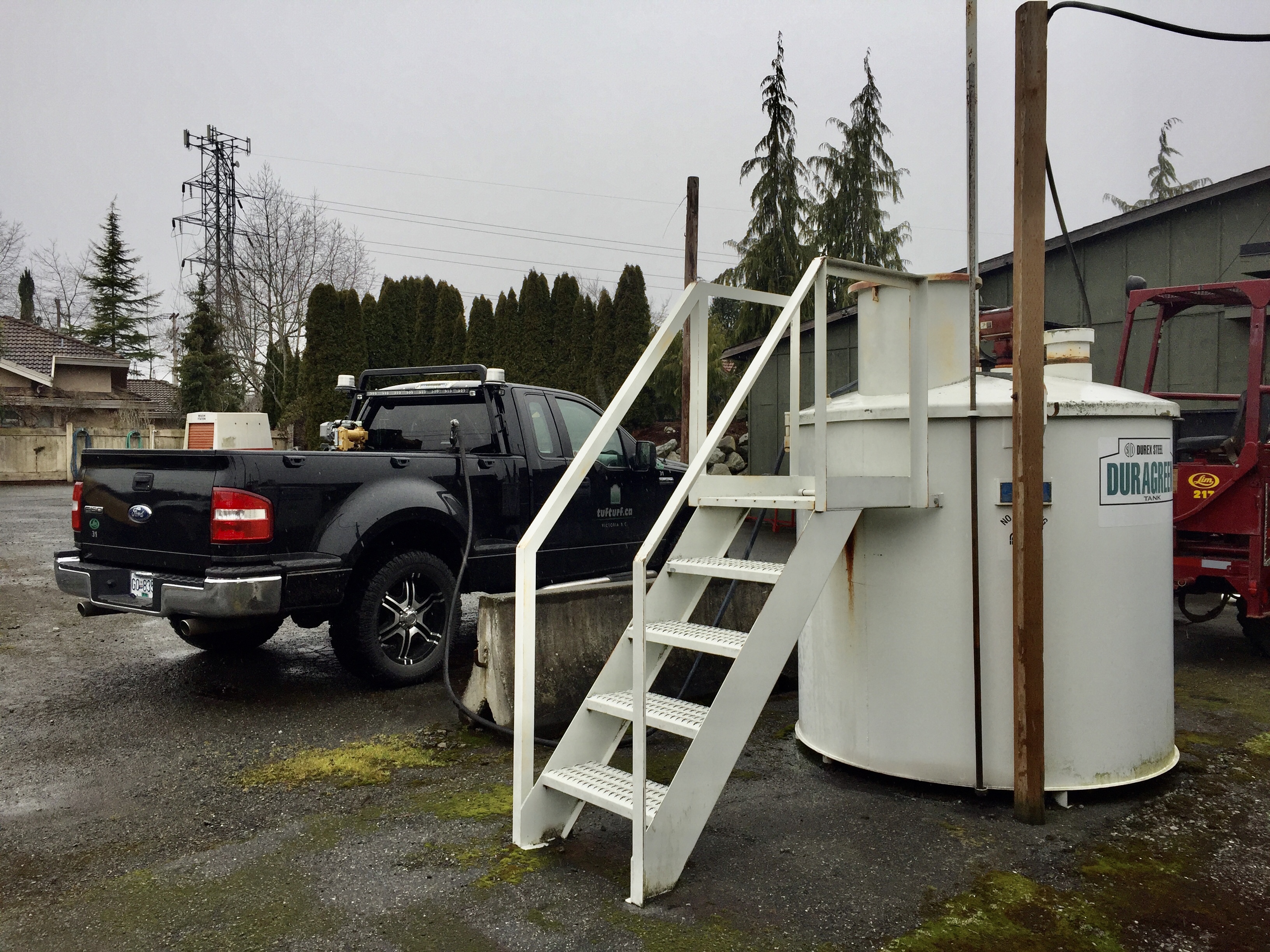

Here is my 2500 liter double containment with 110VAC pump, meter and filter.
/ Diesel Storage Tank
#16
I’ve been told, it the filler hole on the storage tank is too high, you must provide a ladder or something for the delivery guy.
Looks like you got that covered!

I am pretty sure my fuel delivery guy will refuse to fill a plastic tank.
"I am sure my fuel delivery guy will refuse to fill a plastic tank"
Of course!
It is Canada!
There is a law/rule/permit required, and/or inspection department, for....EVERYTHING!
In Nova Scotia, our garbage was inspected prior to pickup, to make certain it was "properly" sorted.
