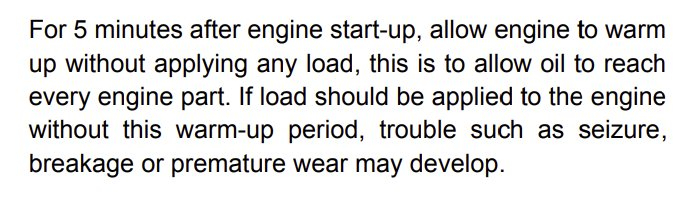

Here's what the owner's manual for my 2016 Kubota M7060 says about warmup:

I let my 5075M idle at 1100 RPM and John Deere says to idle it at that speed so.... I don't let it idle all day, I dont shut it off for less than 15 minutes of idle, I cool it down 4 minutes after mowing etc.I dont have DEF, its a 2013.
