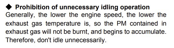

Can you please say more about this? I've heard similar things but never understood why. I have a pretty new tier 4 with about 60 hours on it, and still haven't gone through a re-gen cycle. It works hard some times, but usually it has a light load. And I'm also unclear whether by "idle" most people are referring generally to running the engine without a load, or more specifically doing that at low rpm. I think I've heard people use the word both ways.
What does your owner's manual say? The manual for my Kubota specifically states, in no uncertain terms, to keep idling at a minimum. That means keeping the rpms up so the exhaust stays hot.
Screen shot from my owner's manual:
(PM = particulate matter)

…what if you idle it unnecessarily, but then make sure to work it hard and hot for an extended period of time at the end of the day? Or every few days. Or often…often enough. It has to partially mimic a regen cycle.

Mine does not say much about this. It does say that when driving the tractor the "throttle lever" should be set for an engine speed above 1500 (though it's not a throttle). And it lists various RPMs such as min, max, and nominal in the table showing driving speeds for different gears. There's no reference to "idle" in the index and text searching only turned up the things I mentioned, and no advice on running the engine without a load. Also no mention on setting engine speed when the tractor is sitting still but working through the PTO or hydraulics (other than notes about what engine speed correlates to 540 RPM PTO speed).
Thanks! The explanation about exhaust temperature does make sense!
