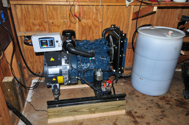

I agree with the group that you can use a much smaller genset. I have a 9.75 KW Kubota powered and I can run my entire house. I do shed the hot water heater. On a longer outage I switch off the heat/ac for an hour or two, switch on the water heater to get it back up to temp. Also we do not run the dryer or oven when on backup power. Other than that, 3 heat pumps (3 zones, one 2 ton and two 1.5 ton units), 2 refrigerators and a freezer, well pump and normal lighting, TV computers, etc. On a normal load over a day I use 0.3 g/hr. Except as mentioned no real change in lifestyle when running.
Diesel is the right decision. It is the lowest cost to run, especially compared to a propane fueled unit. Fuel does not "go bad" over time like gasoline, plus you are already a diesel user with your tractors. Just consider an additive to control moisture and algae. I got my gen from Central Maine and picked the 9,75 KW Kubota powered. I have a Kubota tractor so there is some commonality in filters and parts, which was part of my decision. I added a GSC control for engine start and monitoring. My box is a 200 amp, but as mentioned you should consider that you will not be drying, baking and cooking at the same time. Although I have a 200 amp box the utility transformer on my property (just feeding my house) is only 10 KW. The utility power has a high surge capacity, but continuous power is relatively small. A smaller size will save purchase cost, lower cost to run and less space and cost to install. A 12-15 KW should be more than enough for a normal household. Oversize will cost more to run.
Central Maine was good to deal with. They carry a number of brands and sizes. based on many comments and reviews, STAY AWAY fro the Chinese units. Low reliability, poor quality and hard to find parts are a big issue.
Paul

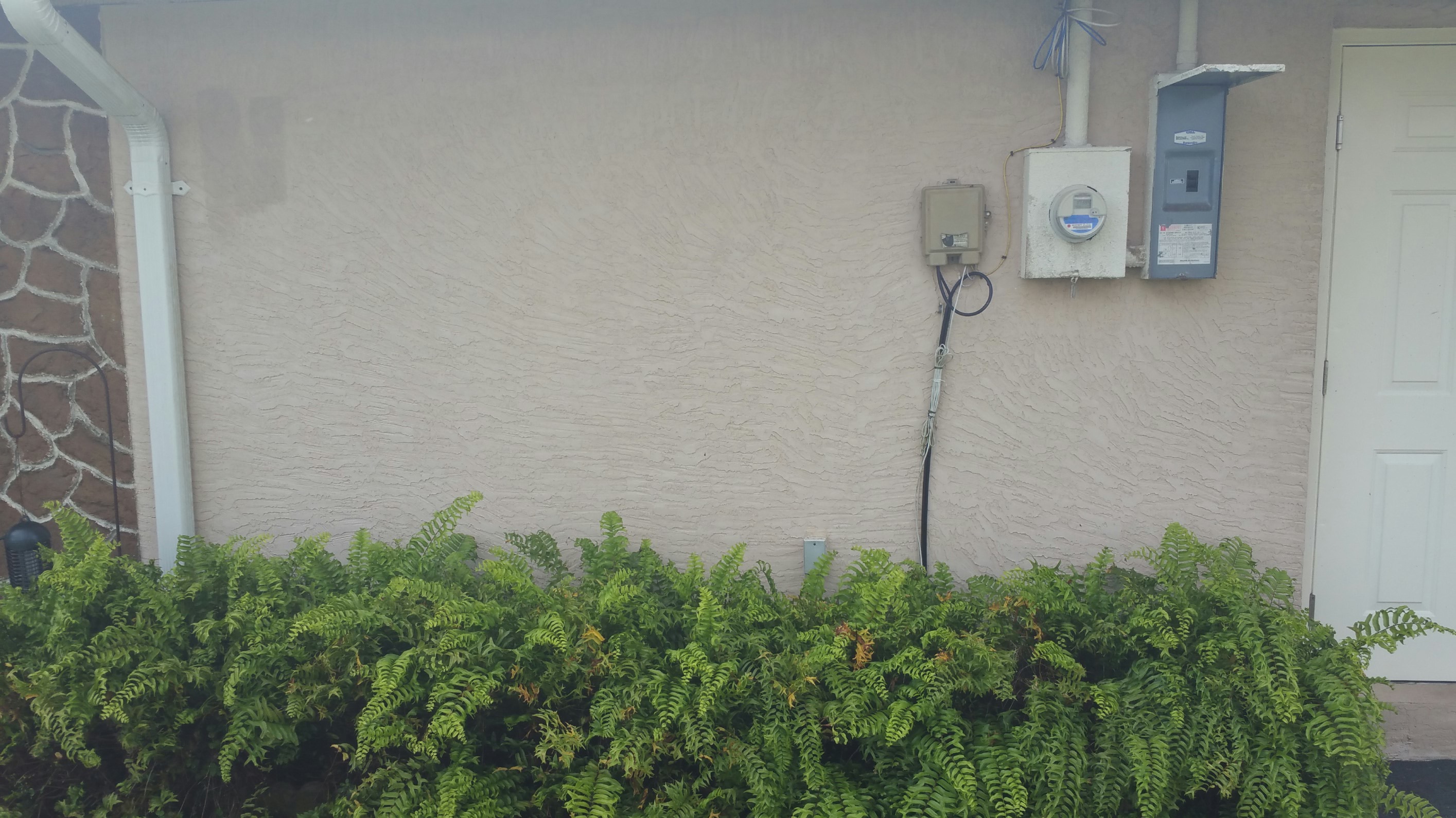

Here is where I have decided to place the generator. Its the far side of the house and there is a 200amp sub panel. The house is made from ICF's so there is 3 inches of foam with 8 inches on concrete sandwiched between. I am hoping that is enough to muffle most noise.
I am going to have a slab placed where the ferns are.
This is the inside panel. I am assuming the ATS will be wired in next to this panel.
View attachment 458057View attachment 458058
I would not put a diesel generator that close to the house unless you love the smell of diesel exhaust and want to feel and hear the engine running. Mine is about 25' away and it still sounds like a german panzer division coming out of the woods. The ground around my generator shed vibrates. I wouldn't want that noise or vibration right next to the house.
In addition, make sure you have a way to get the exhaust up and away. I have my exhaust going straight up, extended 2' above the roof of my generator shed inside a chimney. For extended runs I take the cap off the chimney so the exhaust can shoot straight up and rise with no obstruction. If leave the cap on -- which is like a horizontal exhaust, albeit one 7' above ground -- the exhaust is a lot more noticeable on the ground.
I am all in favor of diesel generators, but keep in mind they are not as clean burning as propane or gas, and they have a fair amount of vibration. Best to treat it like parking a medium size tractor running at 1800rpm non-stop. Would you want that parked right next to your house?

FWIW we have a Kohler 14KW propane fueled genset. I put it on the far side of the 24' garage, which is 20' from the house. It is rated at 67dB at full load: the Kubota 10KW is rated at 68dB.
I would not want anything louder, or closer.

Here is where I have decided to place the generator. Its the far side of the house and there is a 200amp sub panel. The house is made from ICF's so there is 3 inches of foam with 8 inches on concrete sandwiched between. I am hoping that is enough to muffle most noise. I am going to have a slab placed where the ferns are. <img src="http://www.tractorbynet.com/forums/attachment.php?attachmentid=458057"/><img src="http://www.tractorbynet.com/forums/attachment.php?attachmentid=458058"/> This is the inside panel. I am assuming the ATS will be wired in next to this panel. <img src="http://www.tractorbynet.com/forums/attachment.php?attachmentid=458059"/>
That looks like a great spot. The code will require it be I believe 5' from any Windows, doors or vents.
