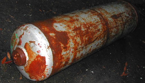

My new design uses a cut down 20-gallon propane tank that I acquired for
free. This tank is a little over 4-ft tall and 13 inches in diameter.

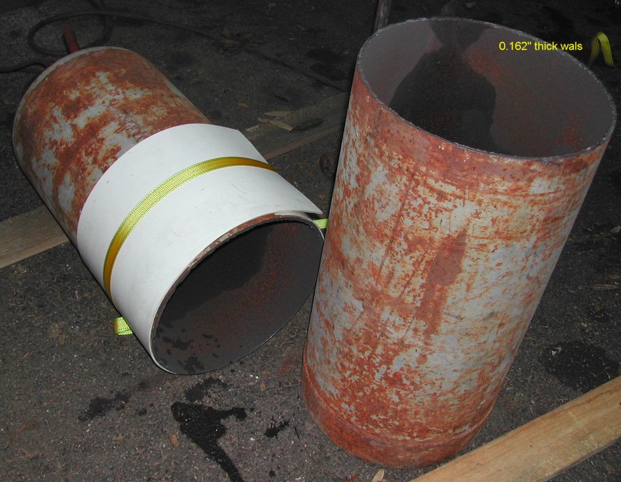

Cutting up old propane cylinder.
I used a plasma cutter, with a plastic guide to get as square a cut
as possible. I used a scrap of 3/16" flexible plastic with a straight
edge and bound it to the tank with a strap. Lining up the straight
edge assures a square cut. (This is a great trick for marking or cutting
any cylindrical material.) Photo D shows how tight the two cuts came
out.
Rolling the tank along wooden 2x4s allowed me to cut in one continuous
pass. This tank is nearly 3/16" thick! Two cuts were done in about
10 minutes.

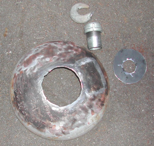

Now the top.
First I free-hand cut the existing top off. First photo shows the filler
plate and a chunk of 1.5 inch pipe and pipe cap. The nipple and cap will
form the filler hole, and the hook will be the handle. Voila, photo G.

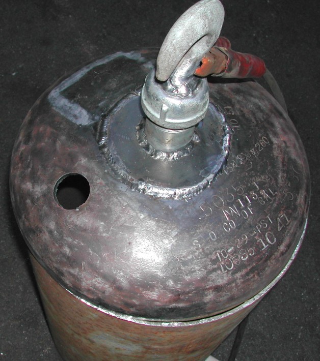

Next I needed a 1.5" hole and a couple smaller ones for a schrader valve
and a pressure guage. Photo H shows how I cut the big one, using my old
friend, the plasma cutter. First I drill a small pilot hole, then I hold my
aluminum template where I want the hole. 15 seconds later, you see the
hole in photo I. If I do not drill a pilot hole, the plasma cutter splashes
back for a fractional second until it penetrates the steel. That's not a big
problem if I am wearing a mask, but it can lead to damaging my template.
The big hole is for the fitting that will support the dipper tube and the hose
fitting for the nozzle.
Photo J...all done with the top.

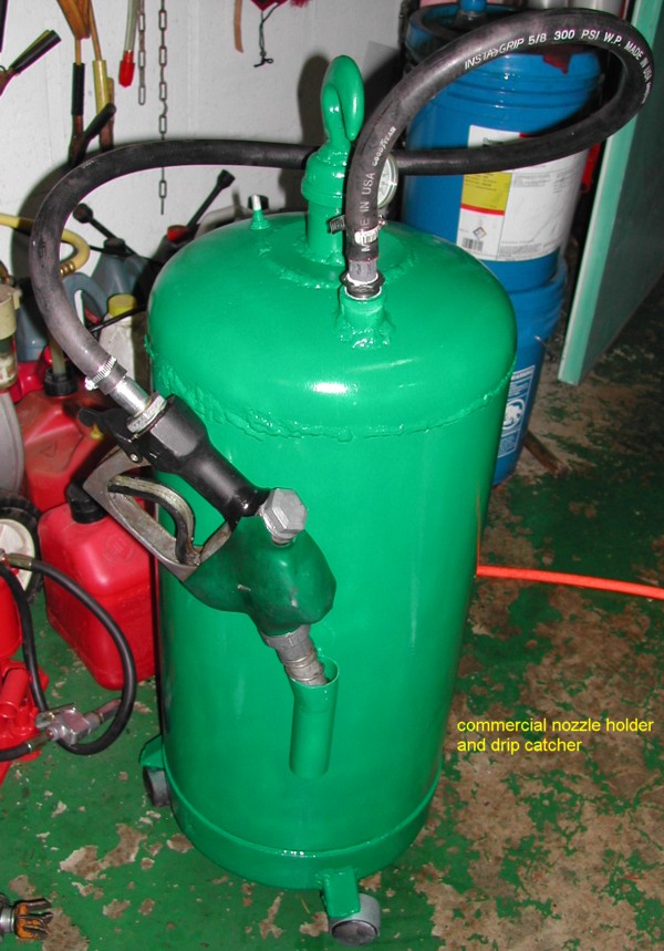

And here is the finished product.
I stole the hose and commercial nozzle from my previous filler system.
The hook filler cap allows me to get a good seal just using my hand to
tighten, as well as a way to lift the whole tank into my pickup.
The second hardest part of the project was passing the leak test. Since
I do most of my welding outside to avoid fumes, it is easy to get a very
slight invisible "micro-porosity" in parts of the weld. 50 psi of air finds all
of those. Small leaks are not crucial as all welds are above the fuel line,
but I eliminated all leaks anyway. I used a MIG welder (Hobart Ironman 210).
That is why some of my welds are as pretty as they could be (big).
Photo M shows the nozzle holder and drip catcher. This nozzle is amazingly
leak-free. Photo N shows my sight guage and guard. The fuel level will be
even more visible when I switch to red diesel.

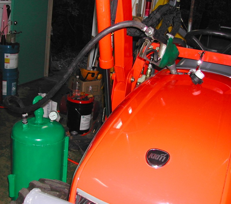

Fill R up!
This system works even better than I expected. I put about 10 gal
into it the other day. I pressurized to to about 10psi, which took about
10 sec. Then I added 5 gal of fuel to my tractor, which took about
15 sec. 3 seconds/gal. Sure beats a hand pump!
