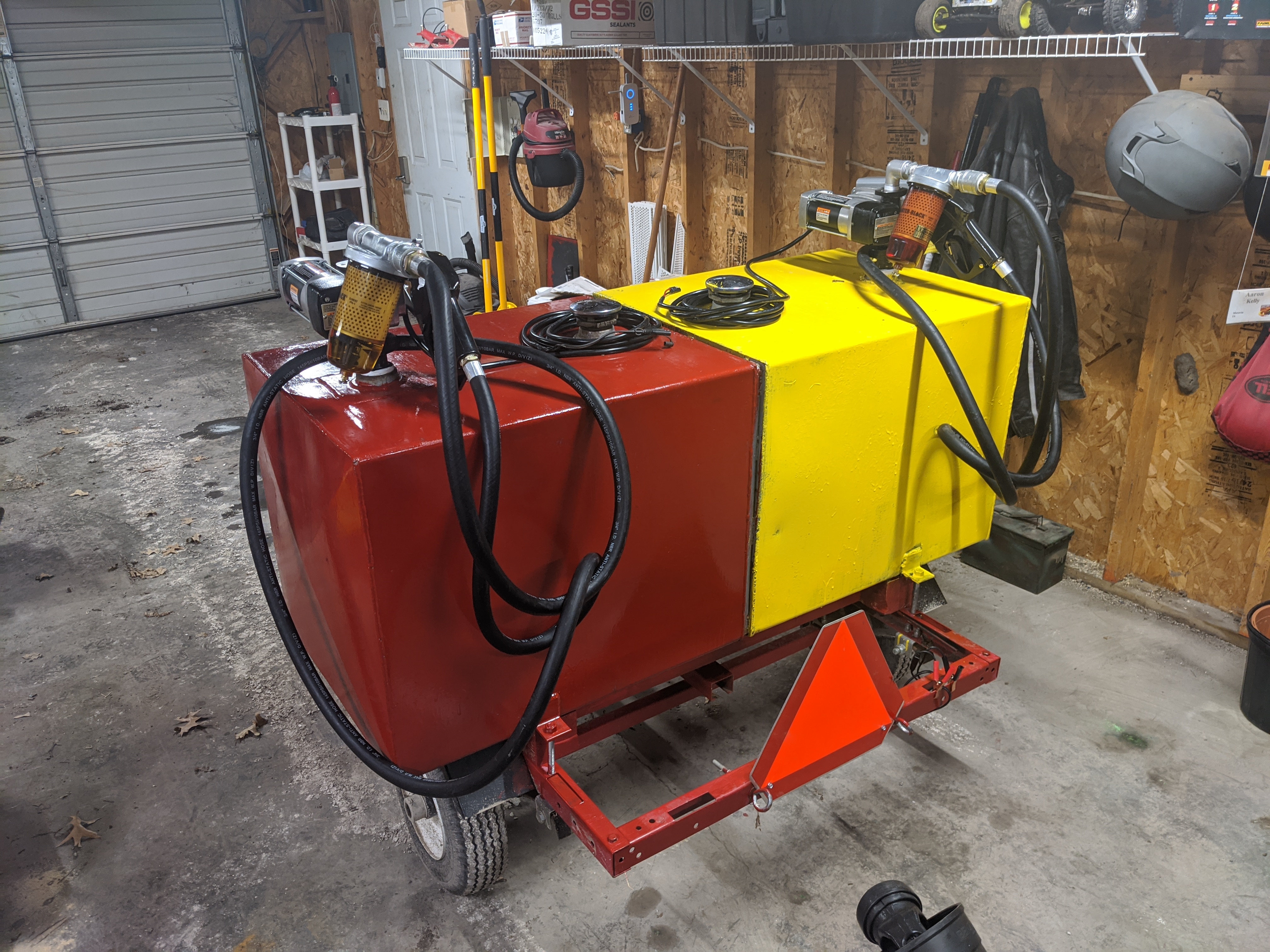

I *JUST* built something similar.
I put mine on a trailer. That way I can pull it the 1 mile down to Farm Service to fill it with my tractor or side by side. With the wheeled jack, even full it pushes around super easy in the garage. 75 gallons diesel, 75 gallons gasoline.
I put a battery tender end (2 pole plug) on the pumps. I have these on ALL my equipment so I can plug them in to keep the batteries in shape. So all my tractors, lawn mowers, side by sides etc already can power the pumps. In addition I also made a conversion plug/adapter that uses regular clamps so I can clamp them on any battery (ie a car or truck) to power the pumps.

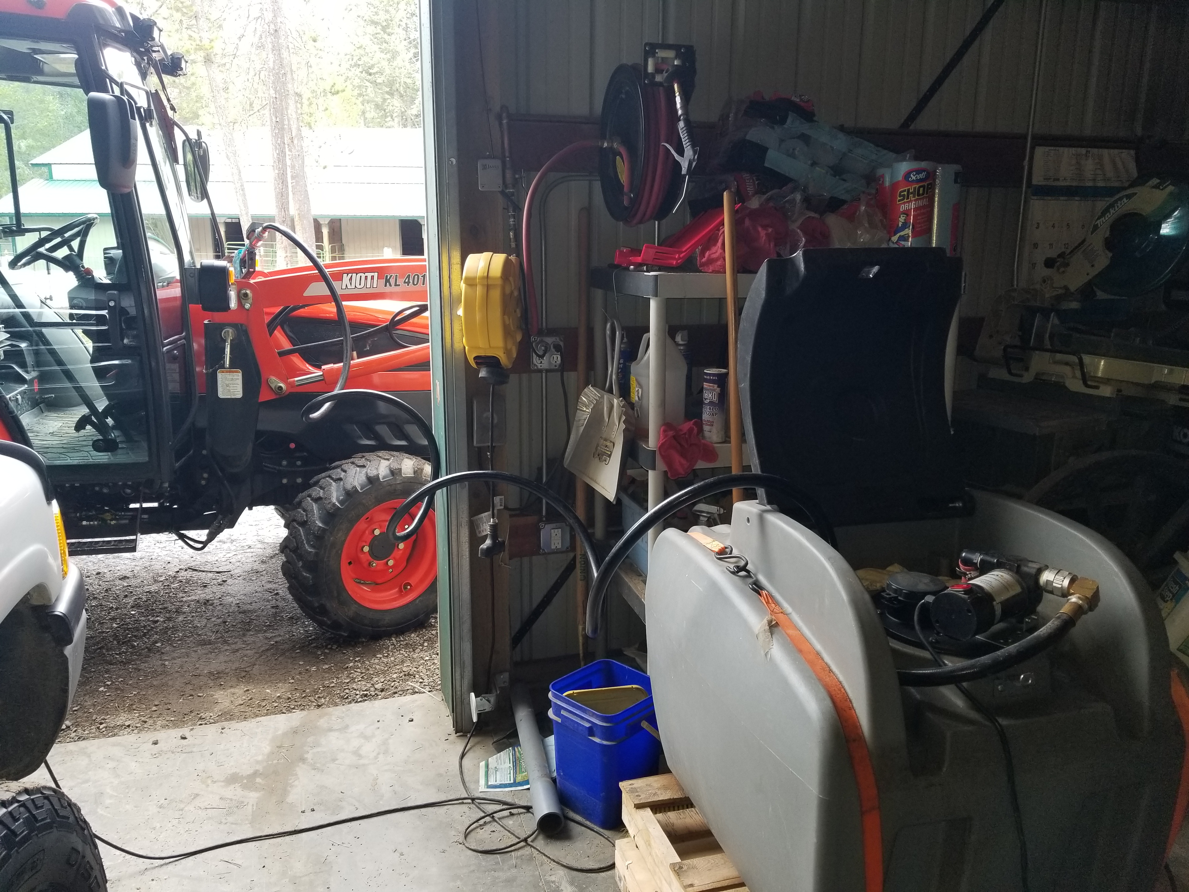

And when I fill mine, I use the 10 foot hose to fill tractor, so battery with tank is easier in my situation. E67C5E53-D7DB-4D65-8A2A-BD8E6BFD8370.jpeg. 57E01E16-D1AB-4085-8BF6-6ED5FD2E5C04.jpeg

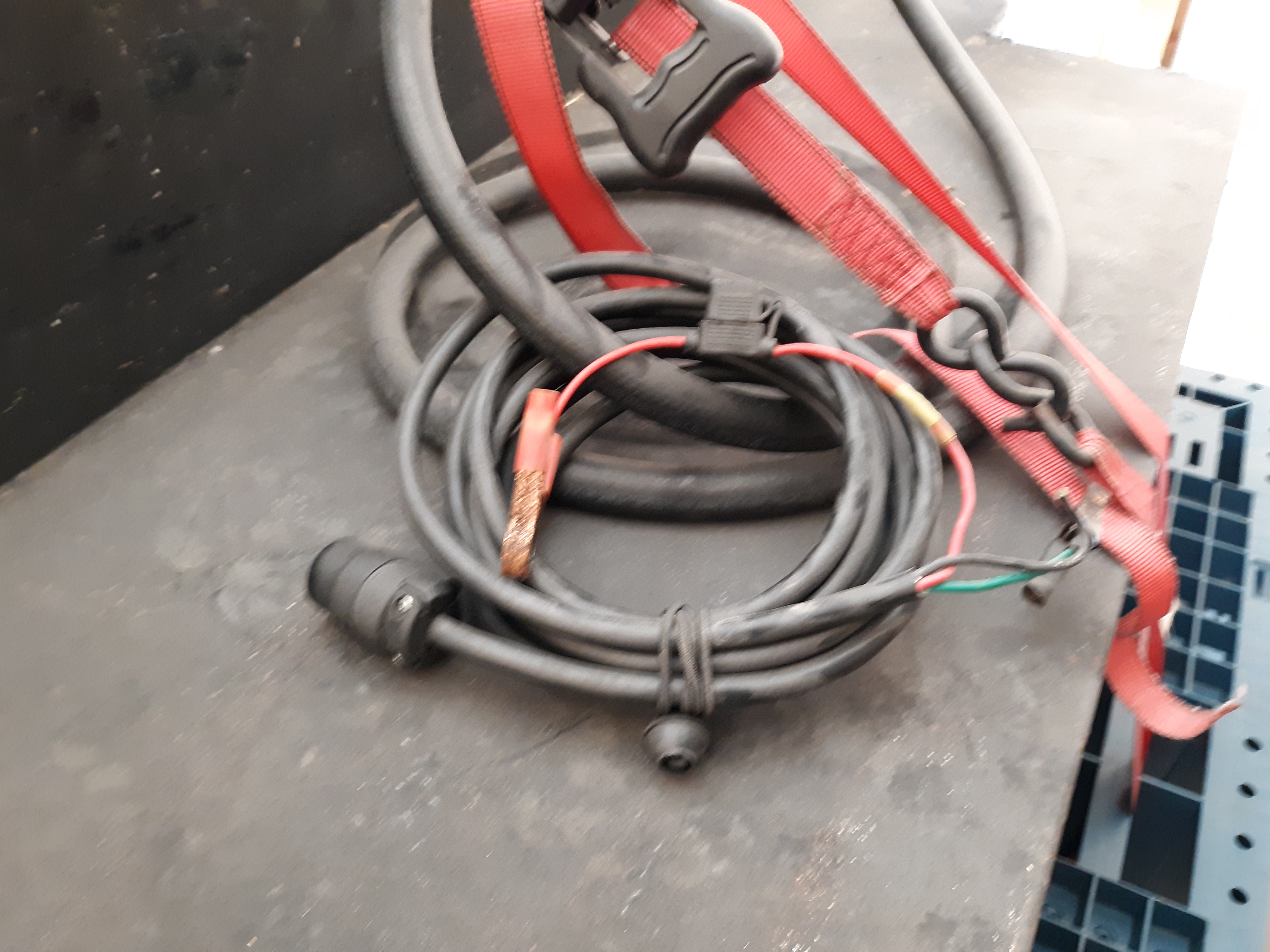

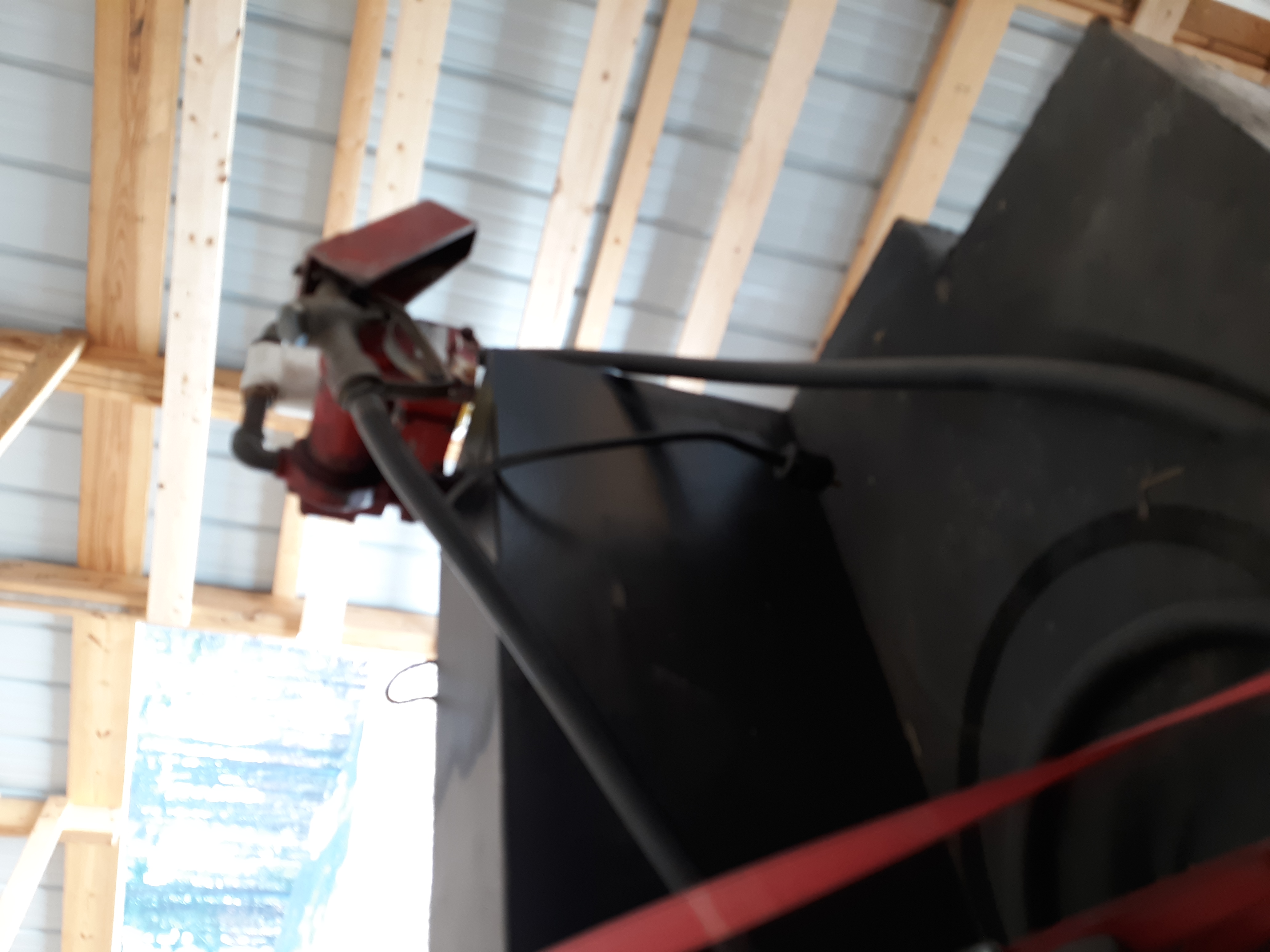

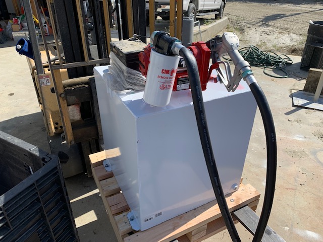

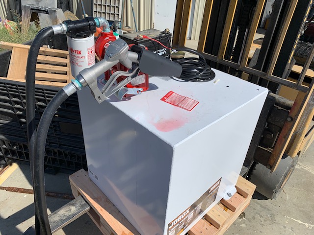

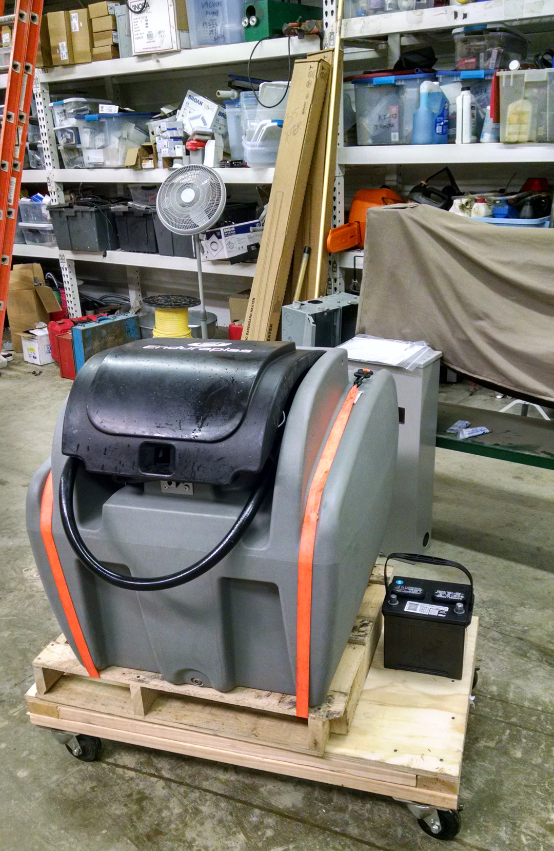

Got it all finished. Built the pallet, waited for some Gasoila Soft-Set Pipe Thread Sealant with PTFE Paste to come in.
Put it all together and just hooked up a small 12 V and she works beautifully.
Filler the tank up with 50 gallons of red diesel $1.84 a gal in Ca. whereas reg #2 is nearing $4.00 a gallon.
I first tried using the NOCO battery pack but the pump brew too may amp because the NOCO kept shutting off.
The small 12V battery worked fine.
At 15 gal a minute, I filled everything up and nearly drained the tank. In the past using 5gal fuel cans would be miserable.
Holding the heavy 5 gal tanks at weird angles because on the excavator the fuel area is hard to get at and I would always lose a gallon or so every time I filled up.
All in all the best money I ever spent.
I still need to maybe get a battery box and do a final attachment for the battery, but I wanted to see proof of concept and all worked
as planned. No real hiccups except for the NOCO battery pack not being able to handle the load.
