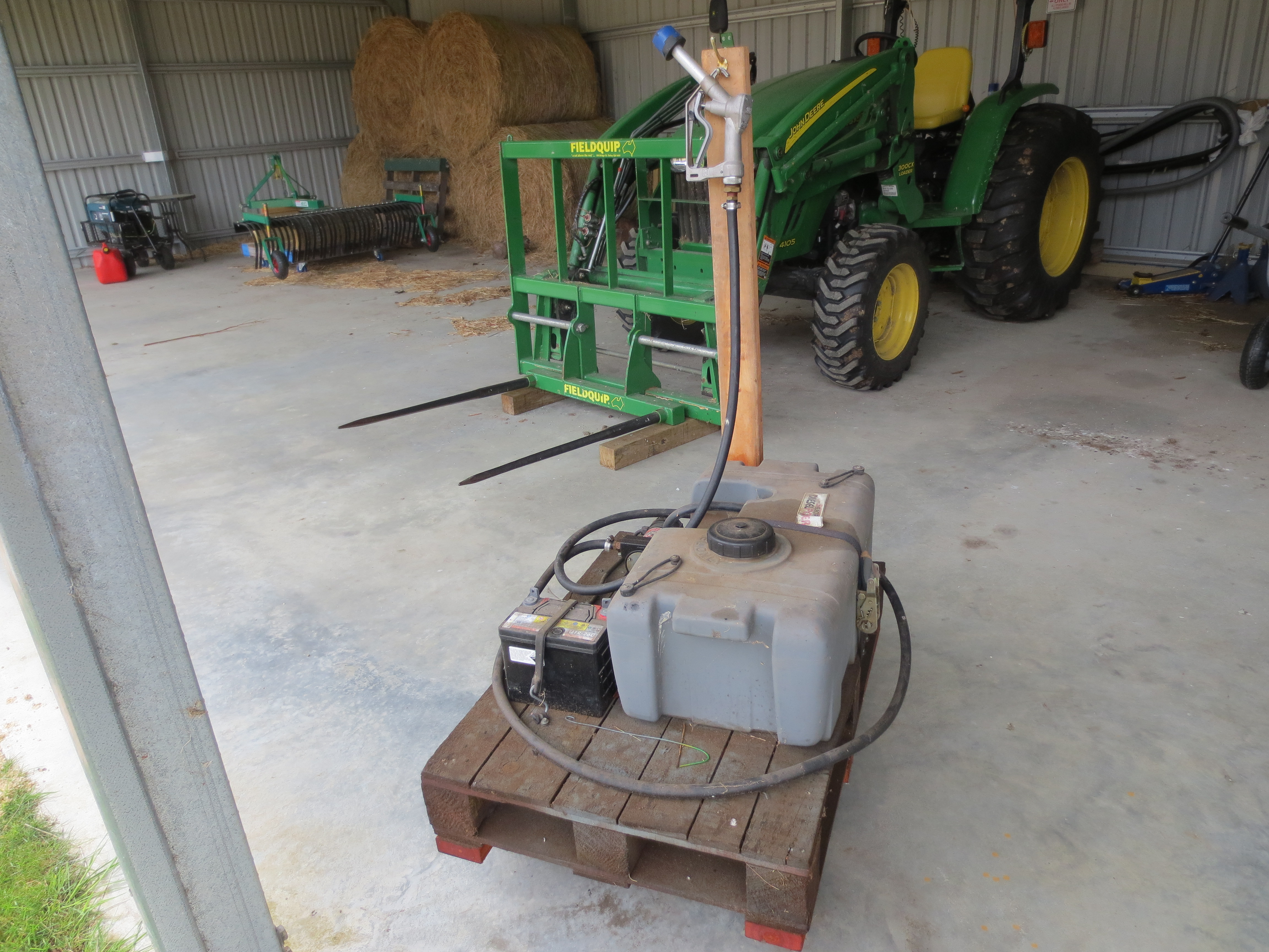

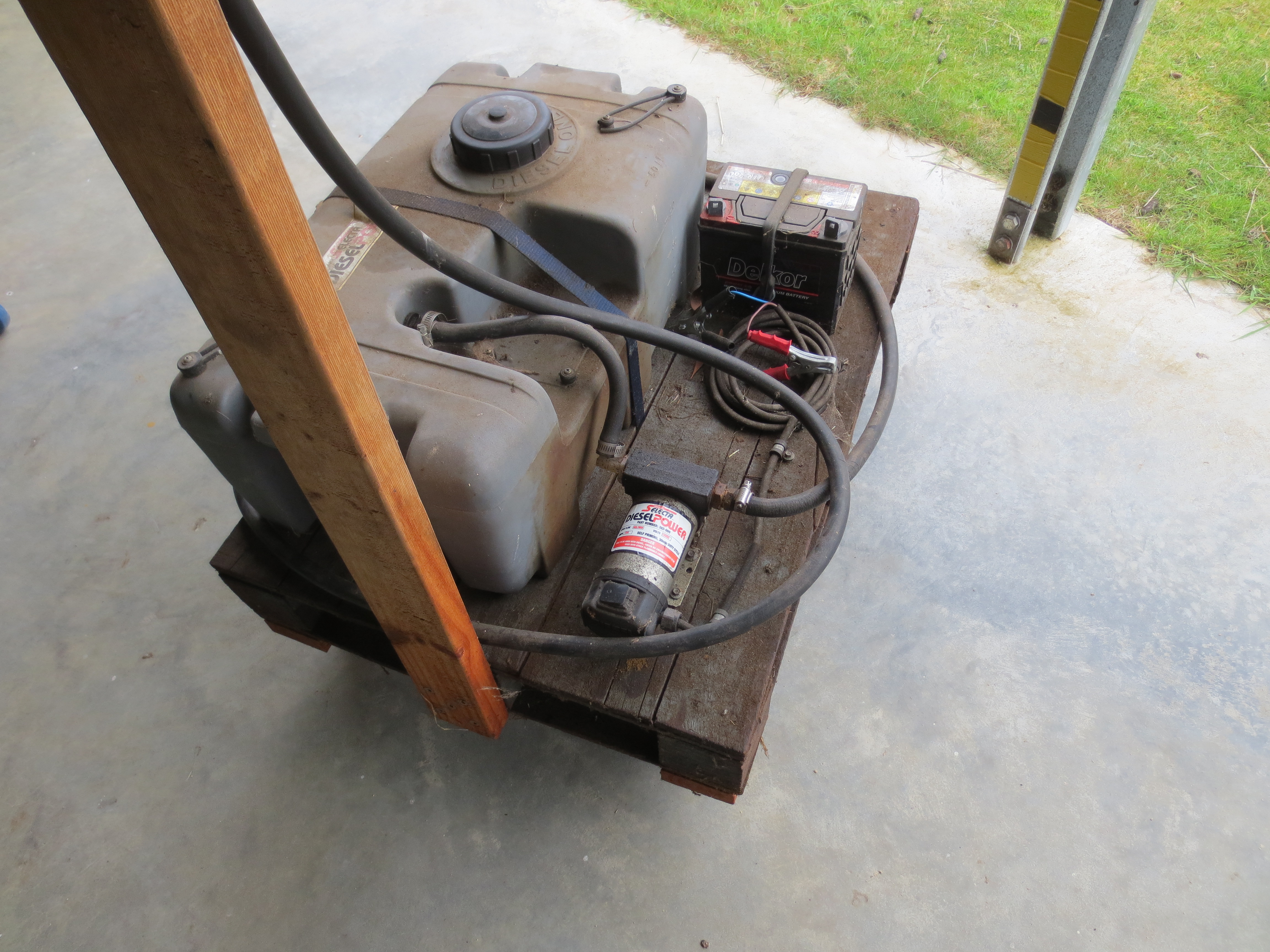

That's not a bad idea! I've rigged a 12VDC 'cigarette' power point to the rear of the 4105 for the occasional use of a ROPS mounted Amber 'whoop-whoop' beacon. My 50ltr diesel transfer tank has it's own, dedicated, marine 12 volt battery which I top up with a trickle charger... but I have to remember to recharge when it comes to to refuel.
Making up a new 'cigarette' lead/plug would eliminate the dedicated battery. :thumbsup:
Here's my fuelling station:

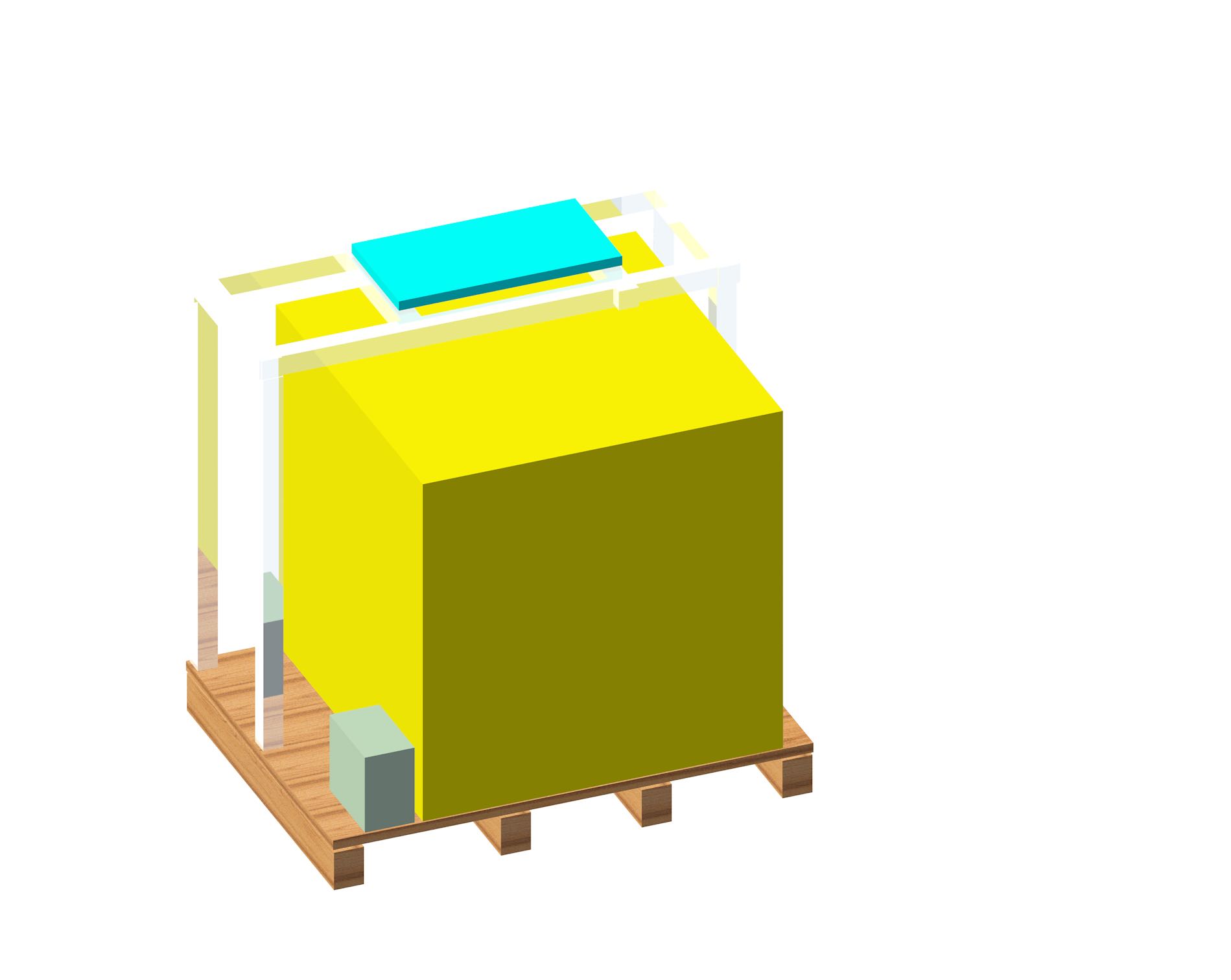

With what you guys added I did a drawing.
Pallet, battery and Tank on a pallet, frame over the tank to hold solar panel.

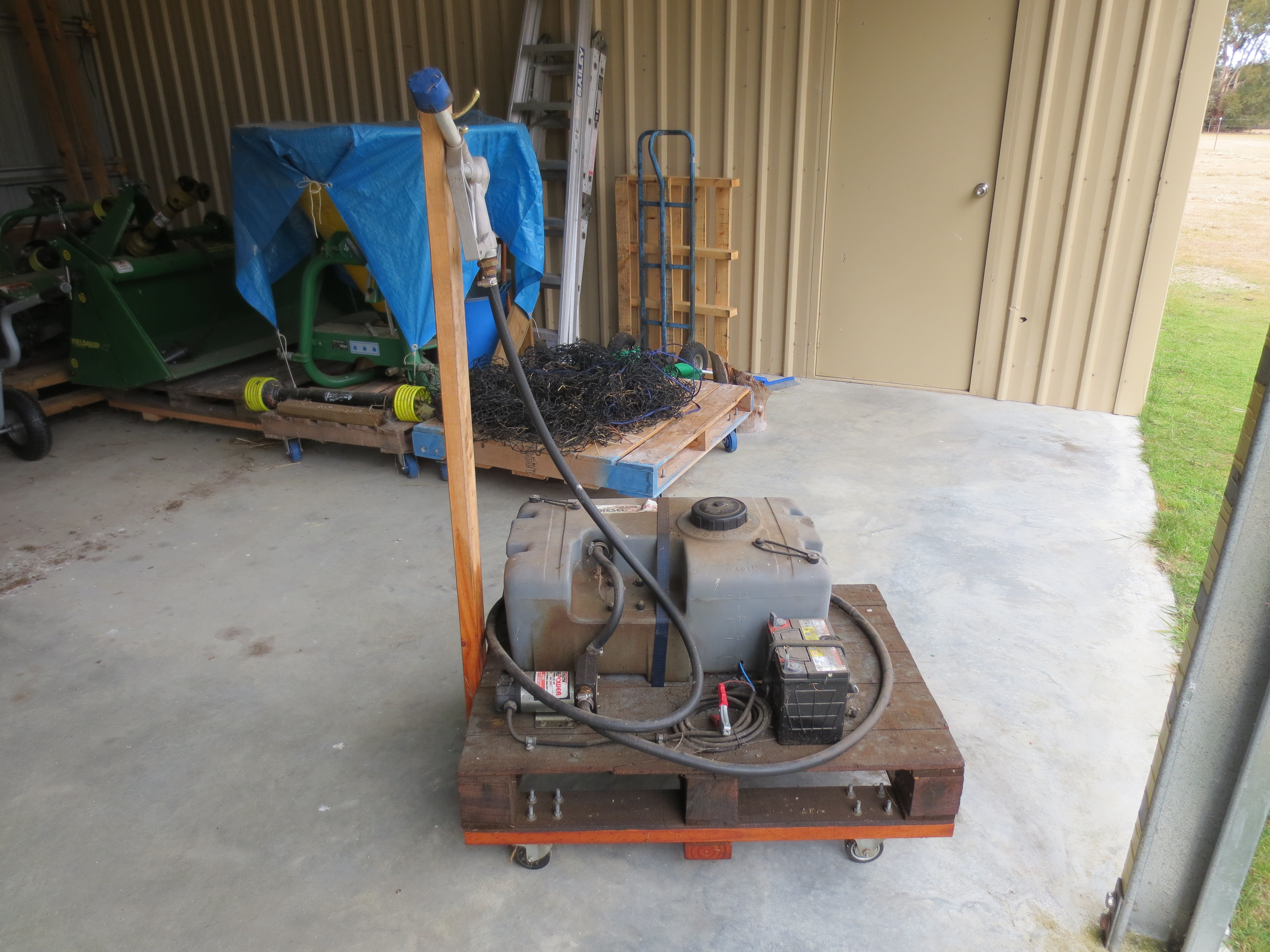

fuel 1.jpg. This is what I did. Pallet has wheels attached to lower section. Upper section lifts off to load onto truck to fill. Battery stays on unit.
I put battery on charger 1 to 2 times a year. Never fails.
