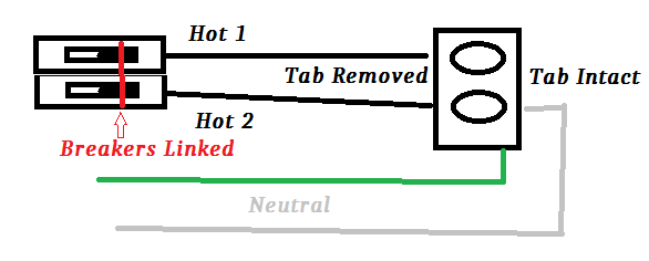

Ironically I have a home that was built in 91 and I am guessing it was wired by electrician.... I have two different sets of receptical where each half of the duplex receptical is served with a circuit breaker, one half of receptical is 15a for garbage disposal (switched), other half is 15a for dishwasher.... On other receptical one half is 15a breaker for forced air heater and other half is 15a for constant hot water circulation system.... I know not switched, but ground are down in both instances....
And both pair of breaker are pin together so if you want to shut down one circuit the other shared circuit in duplex receptical has to shut off also...
We still wire houses that way. But usually always pull 20 amp circuits for dishwasher, disposals, etc. break the tab and 2 circuits to one outlet, and always use a full sized double pole breaker to kill both at same time.

Ya, the double pole is the way to do that. I believe there was some kind of code change regarding this not all long ago but dont recall exactly. The old said,,, required if both poles were attached to the same yoke which is what you describe but especially with the advent of so much diy I think its a great idea to require it on all multi wire.

Shared neutral, that's what you guys are talking about?
   / Did you guys know this about outlets? I didn't! #74
If the ran 12-3 for the 20a circuits to a duplex receptacle (disposal on half and dishwasher on half) then yes it will have a shared neutral and only the hot tab broken off. If bot tabs are broken off, most likely 2 circuits ran. Grounds could all be tied together in the box. You pin the breakers together so that you avoid a hot wire in that box if work in required.

Something along this line. There may or may not be wall switches in the hots.

Yup, I ran into that last year, previous owner wired an extra outlet on it's own breaker, borrowing the neutral from another circuit, but on the same pole. I moved the break next to the other one so that they're on different poles, bonded them together.

This is a case the white wire really is a neutral.
By current NEC, white must always be neutral. There was provisions previously in NEC for white to not be neutral in limited situations (white to meet NEC had to have tape applied at any exposed ends).
