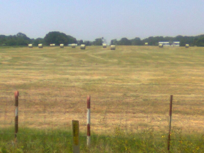

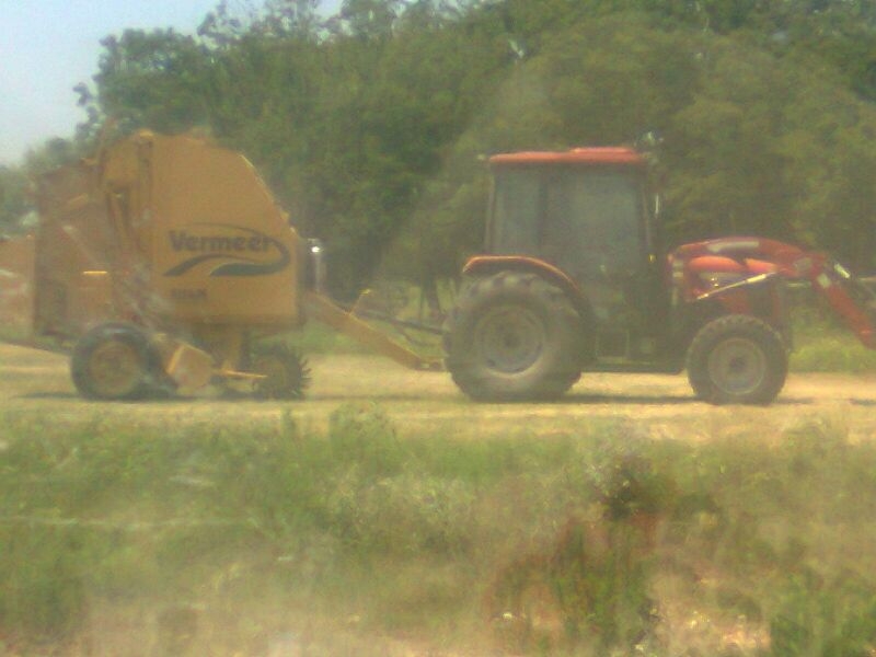

Hay is nice and dry...we are rolling today:
Blue, it's a 400AN Belarus.
Thats great ... the 400 AN is a strong stout tractor. I think its 57 hp and 51 at the pto

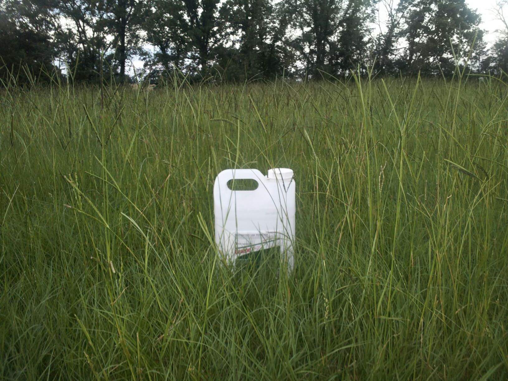

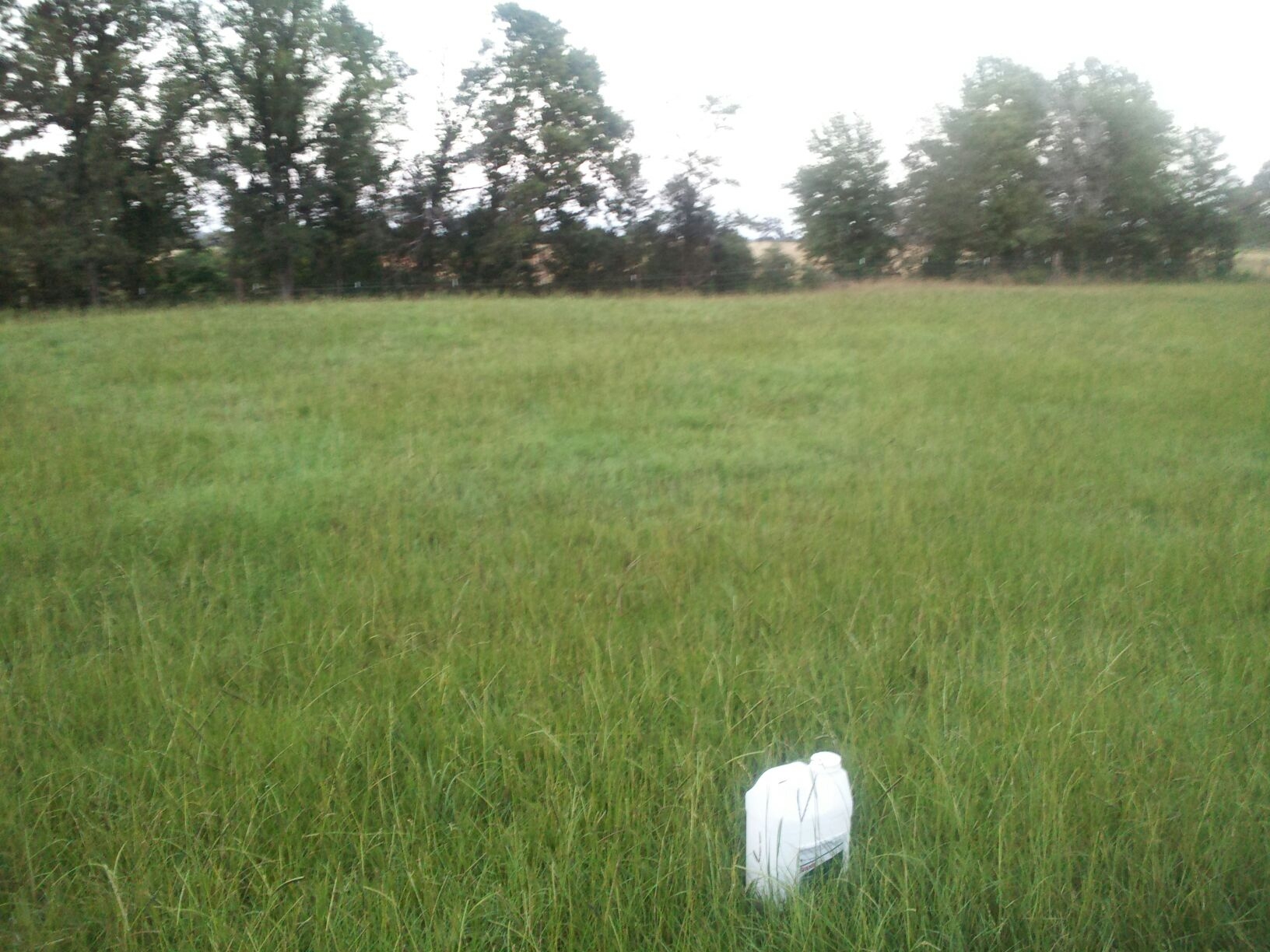

I got some photos of the small hay meadow at the house (2.5gal jug for Ref.)
