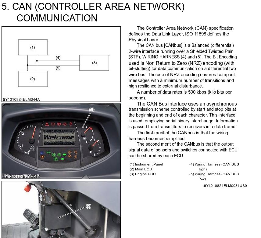

Anyone know where the diagnostic connector is on the l4060? Mines a 2023 model. Suppose to be one under the hood somewhere.

Probably attached to the ECM itself. It won't do you much good however as it's not OBD compliant and the only way you can access it is with a dealer's hardware diagnostic computer and even the dealers don't own that, Kubota leases it to them.
Do be apprised that fiddling with it or the inside pins can cause issues with the ECM and that isn't a cheap date either.

Im just needing it for the can bus wires. After my warranty is up im making some changes.
   / Diagnostic connector #7
This is what I found in the WSM online:

That helps a lot. Thanks. Def know now that it does have a high and low for the CAN. Do you have a pic of #4 and #5? Thatd show exactly where the connector is. Pretty sure i found it though. Its to the right of #2 in the pic.
