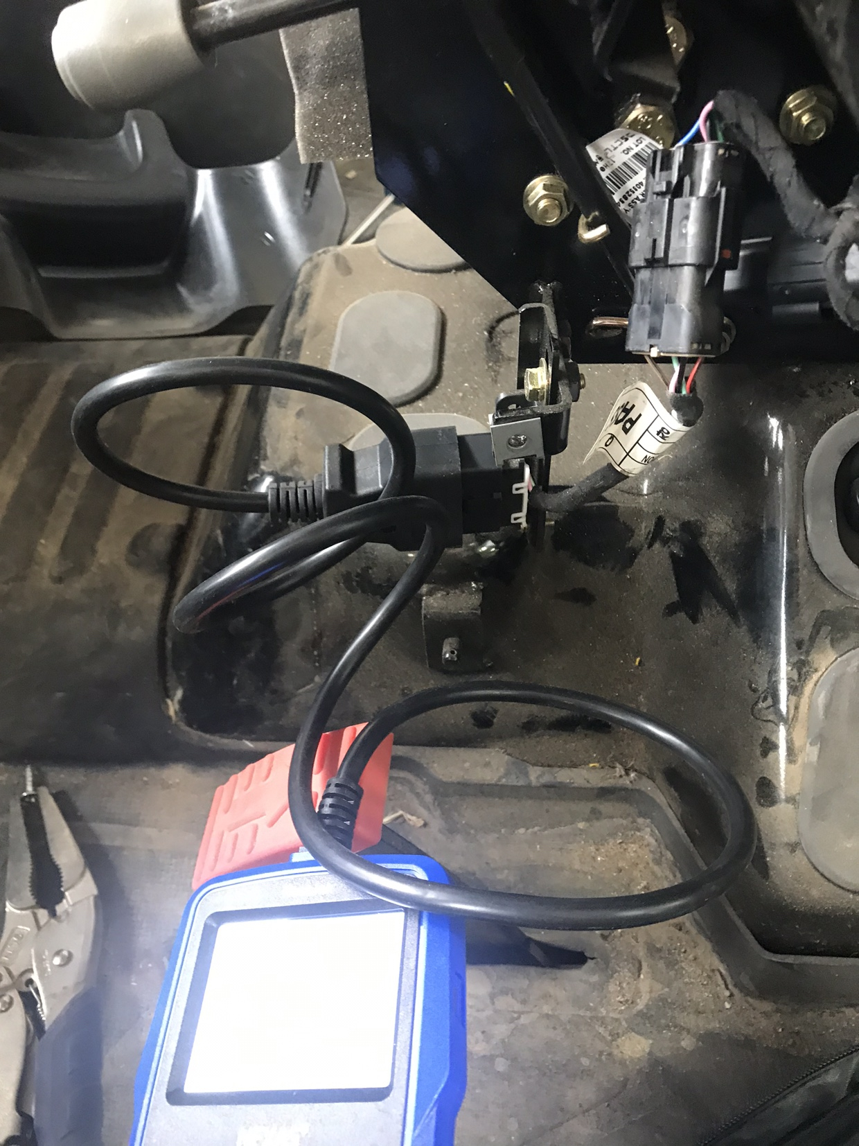

Trying to check codes on 2015ish 3037h. Got a ELM code reader. The J1939/obd2 cable I purchased looked correct but will not insert into the round port on tractor. The center pin on the cable has a key on it but tractor port does not? Anyone know what cable I need?
Just now joined so I could comment on your adapter.
I bought one of those on Ebay and ran into the squared key issue as well but simply used a slender new sharp long utility knife blade to shave off the key and then it plugged right in just fine. (A slender Exacto holder with blade will work fine too). But, unfortunately, when hooked to two different standard OBDD11 readers for the automotive industry, neither was able to locate the tractor. Perhaps you will have better luck.

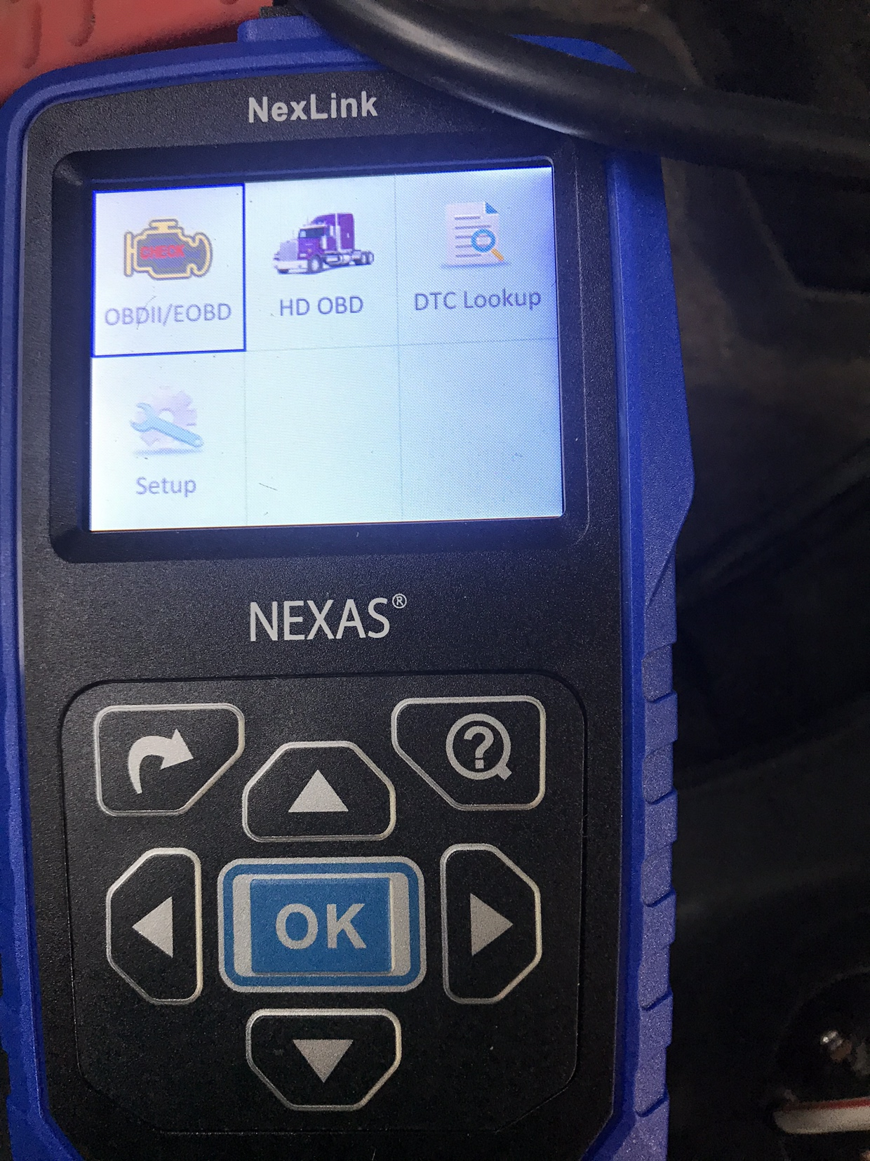

Finally got a chance to hook it up. Connected fine- don’t have any codes so nothing to read or clear. Will try to get some live data tomorrow to confirm it is reading engine data.
