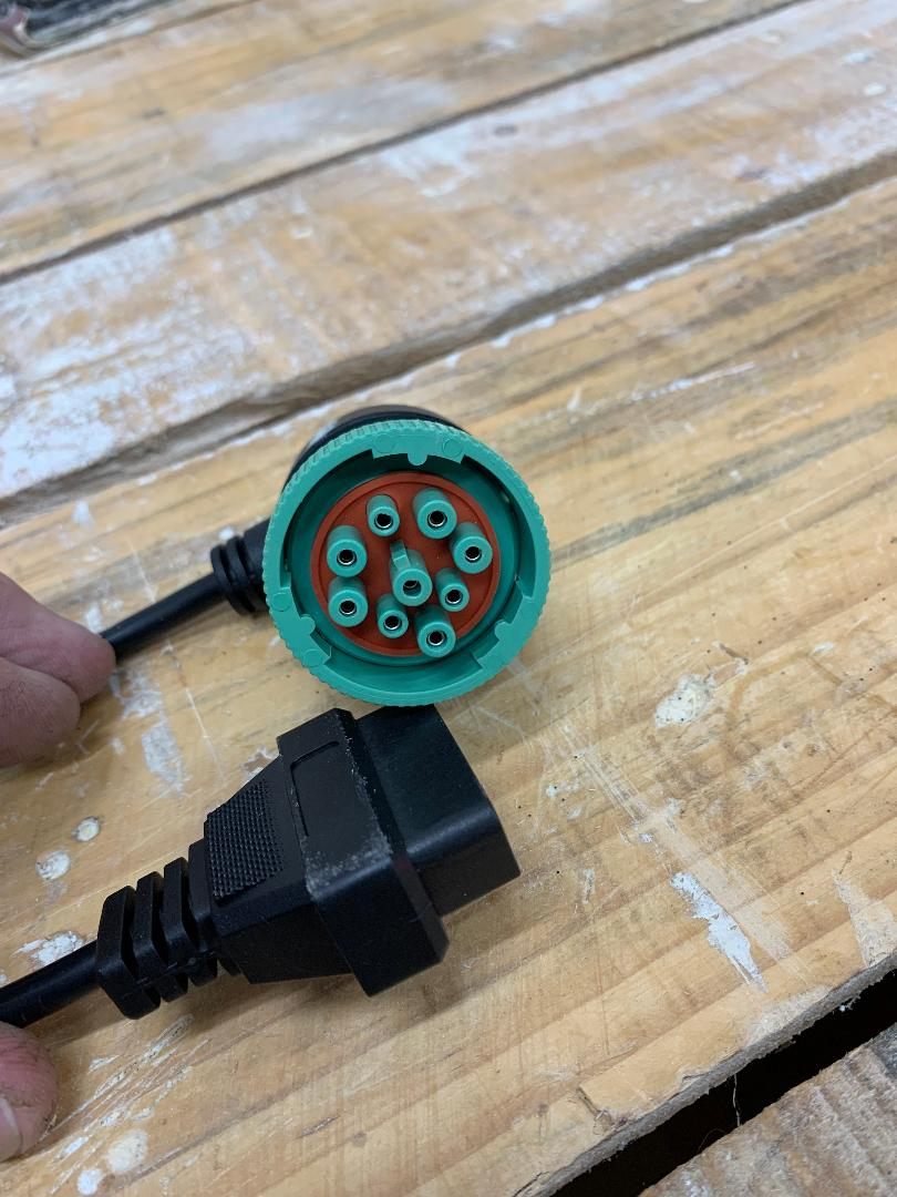

Trying to check codes on 2015ish 3037h. Got a ELM code reader. The J1939/obd2 cable I purchased looked correct but will not insert into the round port on tractor. The center pin on the cable has a key on it but tractor port does not? Anyone know what cable I need?
See post 1
