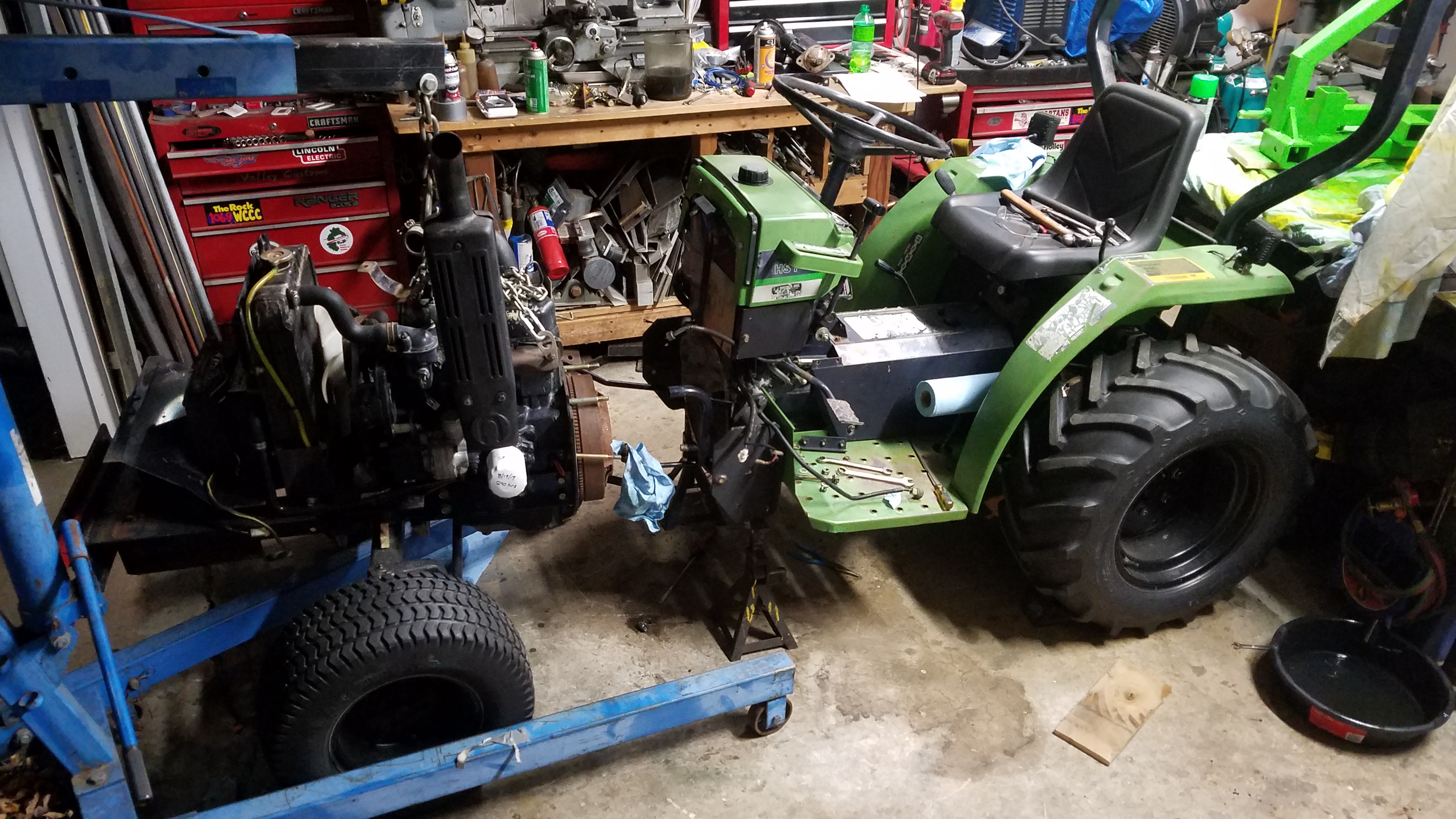

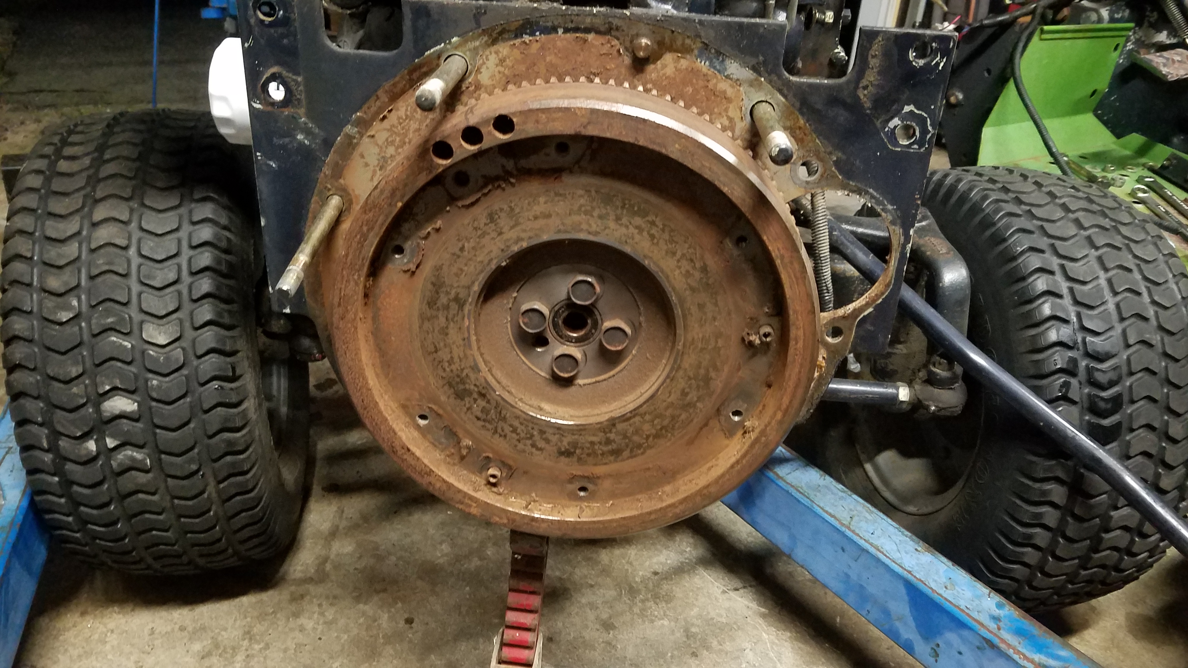

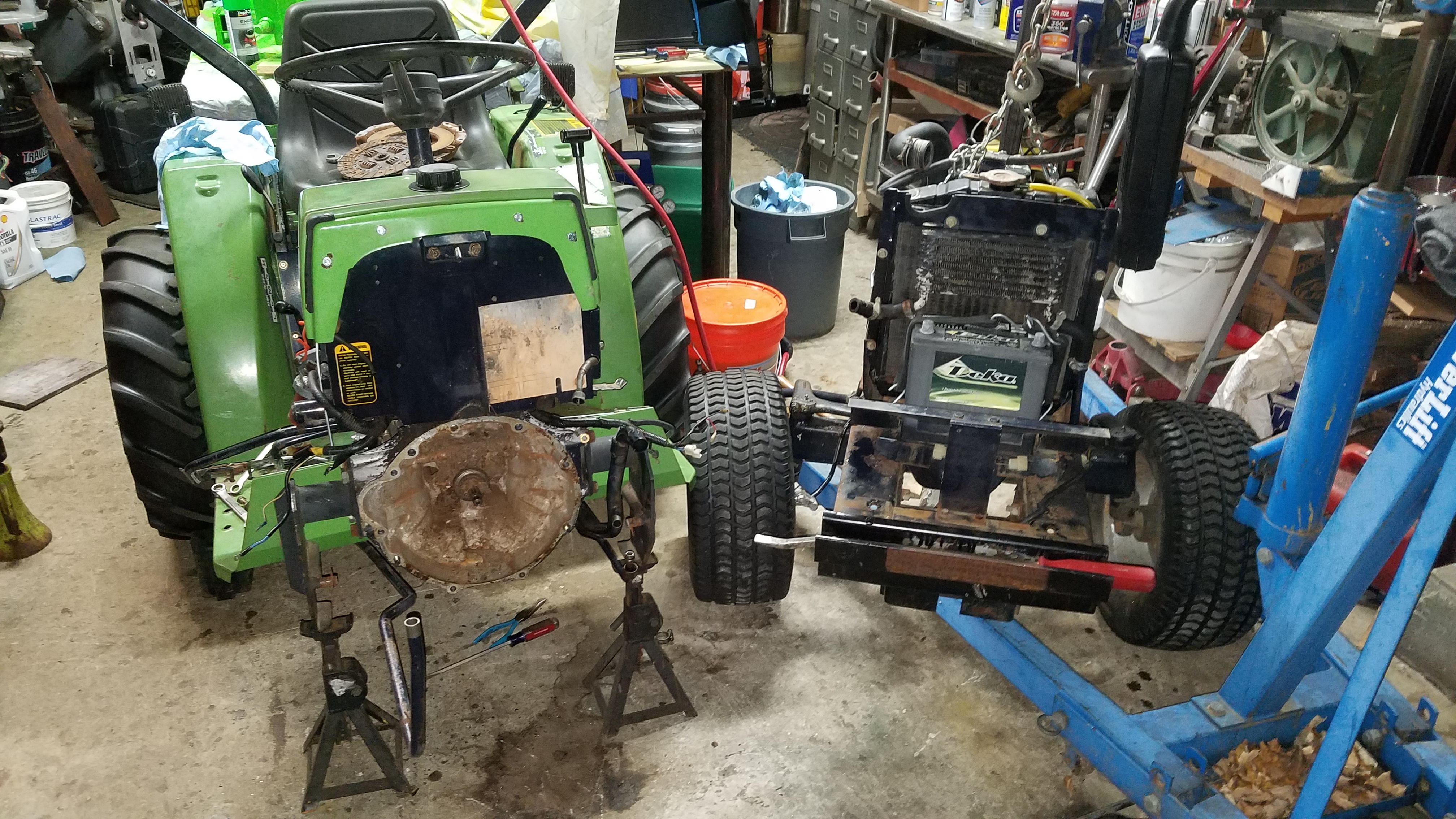

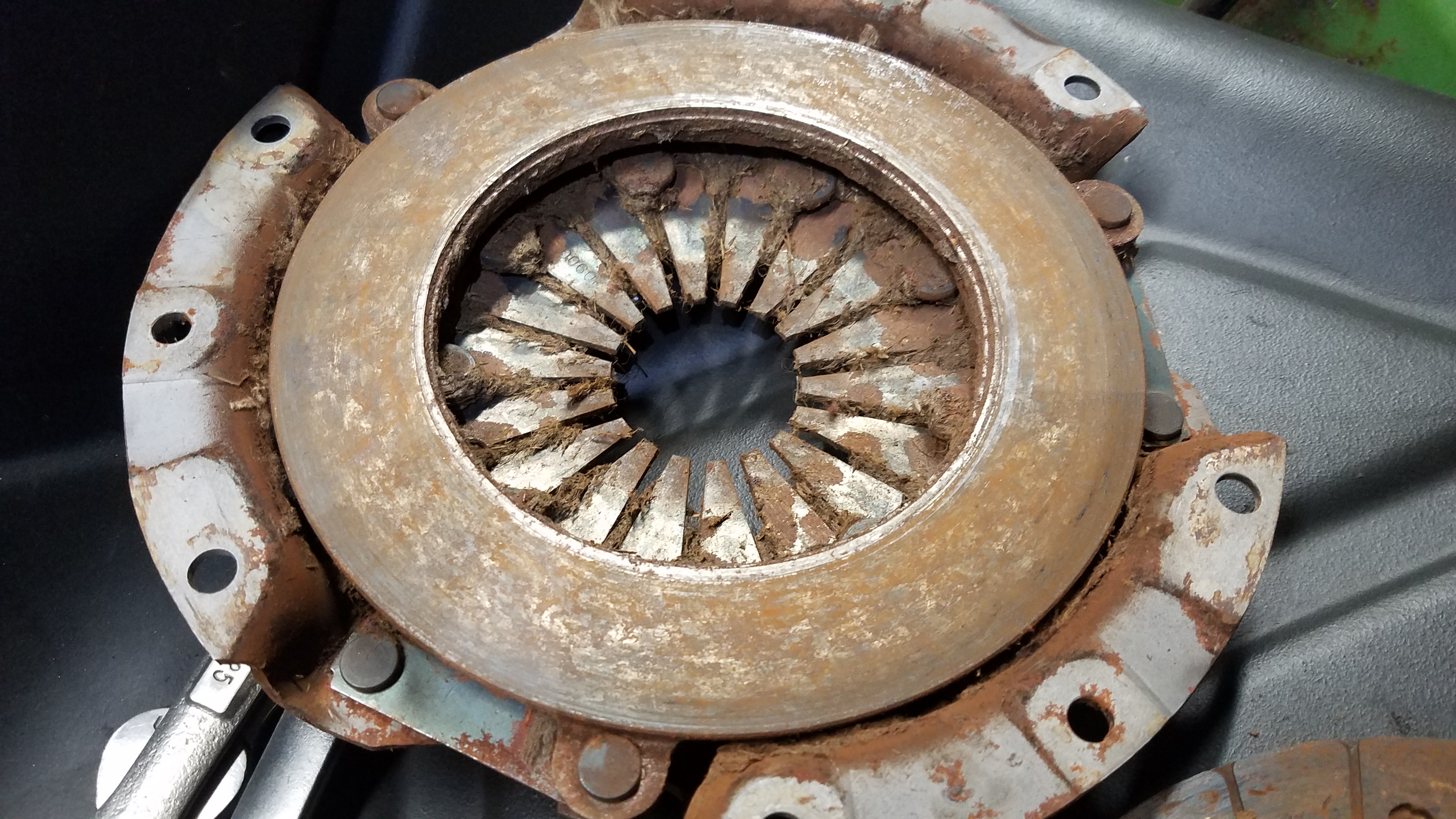

The Split:

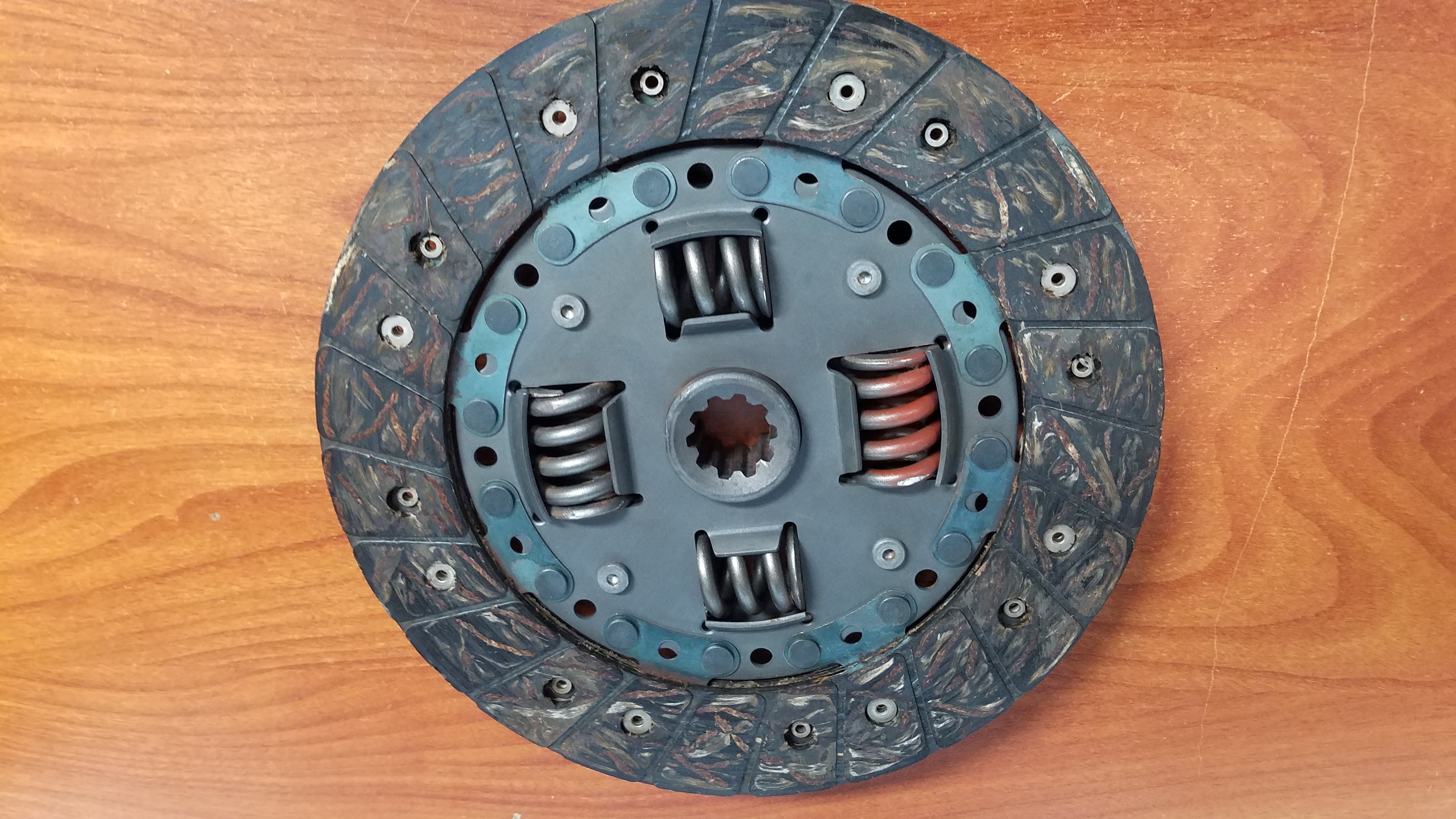

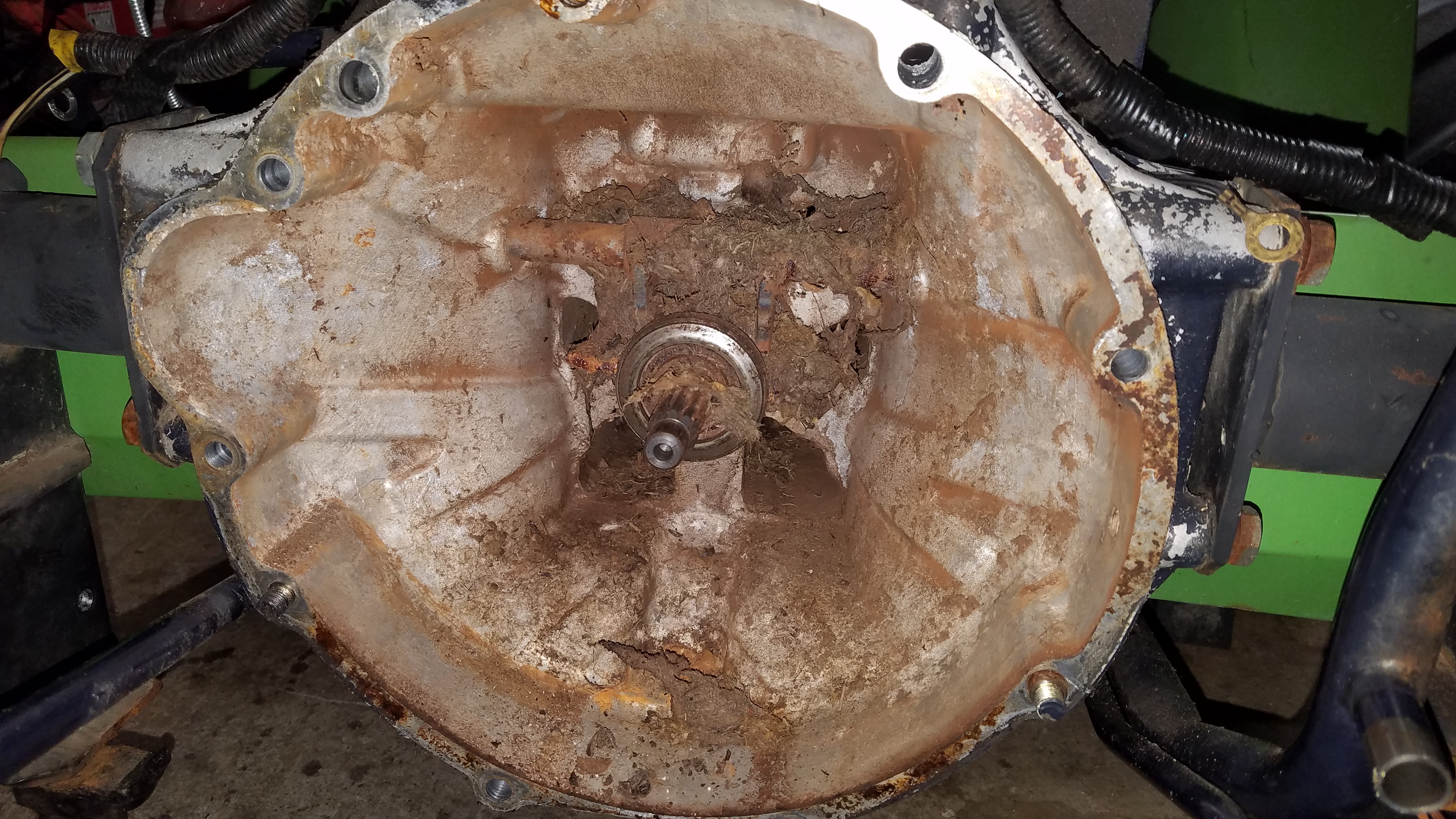

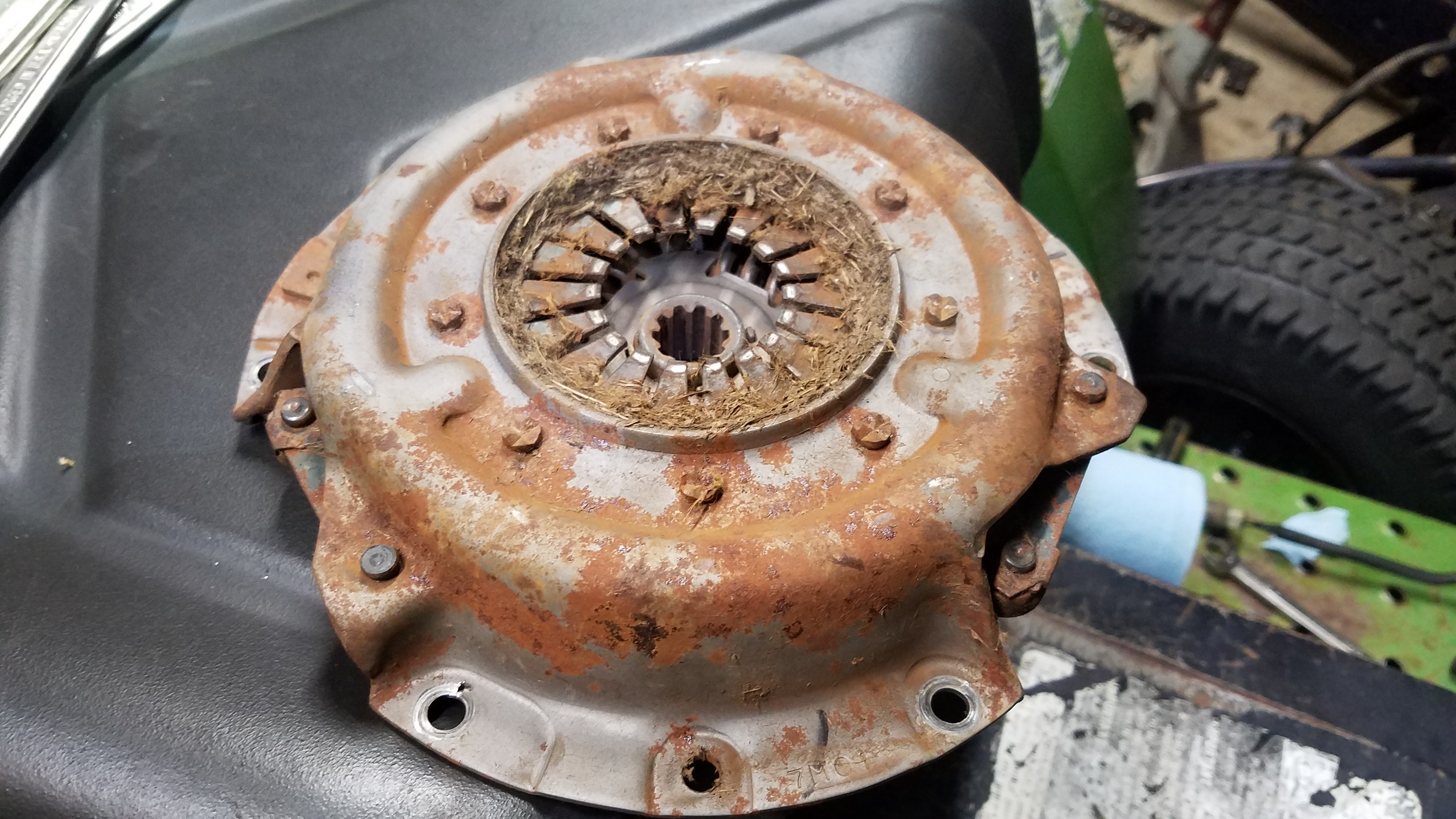

I followed the 25 "simple" steps in the service manual and split the tractor between the engine and clutch housing. Whole thing took 2.5 hours, most of which was digging the engine crane out of the shed. I discovered the clutch and pressure plate littered with grass, mouse debris and god knows what else. While it's foreign material I don't think it was enough to throw it out of balance. Regardless I will clean up the area and move on to the next layer of testing.
Next Steps:
I plan on test running the engine (without disk & pressure plate) while the tractor is split. This will confirm or eliminate the vibration in the engine as all the other parts have been removed.
I've also chosen to reuse the factory clutch disk as it cleaned up well and meets the service requirements outlined in the manual. I will however be purchasing a new pressure plate because cleaning up the old was isn't work $60 bucks.

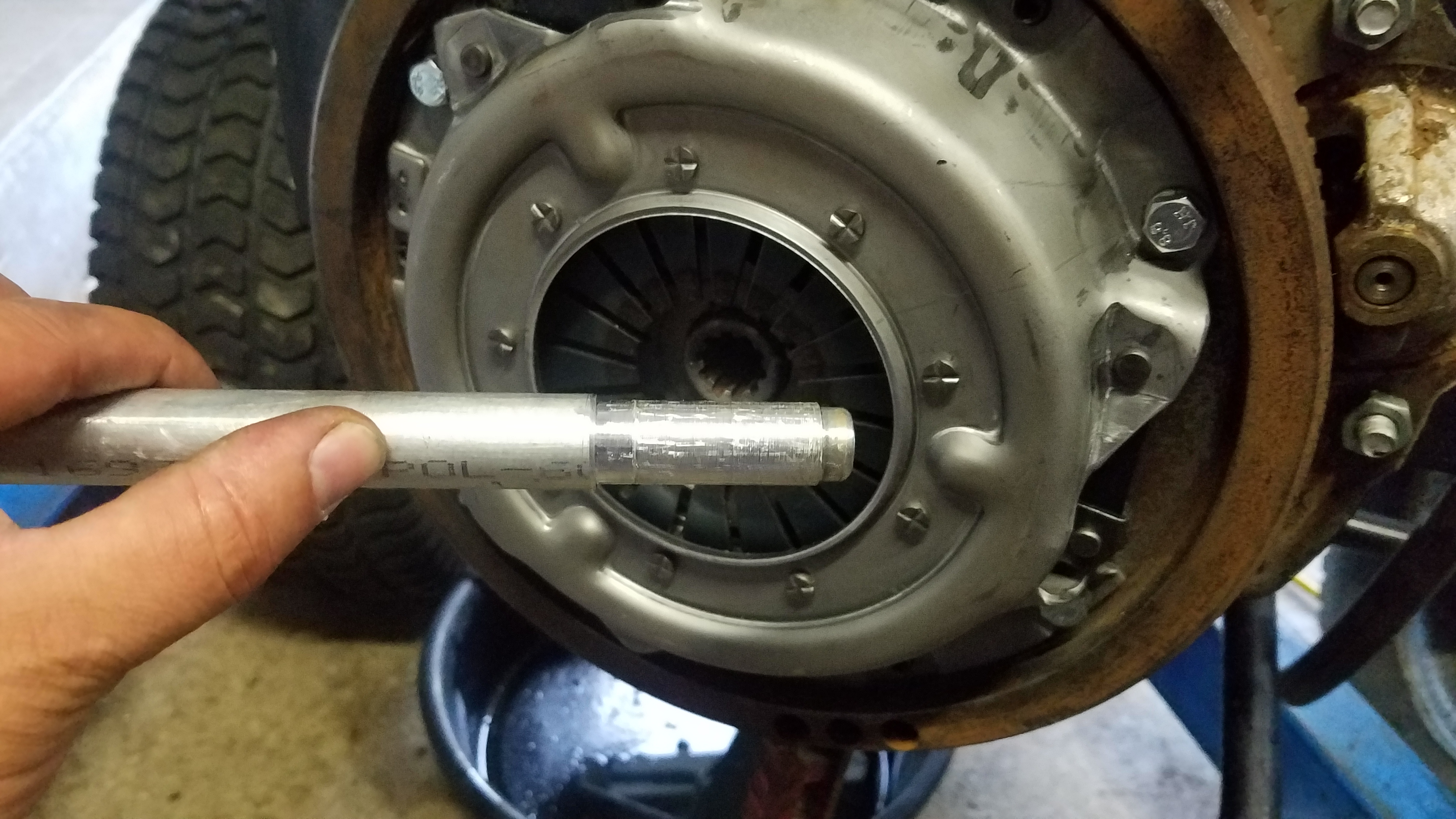

I picked up a clutch from Hamilton Bobs on ebay and was excited to install it this past weekend. That was until I came home to find the box damaged and empty. USPS was kind enough to leave a note saying it was empty upon delivery. Thankfully Hamilton Bobs stepped up and sent me another one ASAP. Wish all my customer service inquires went that well.

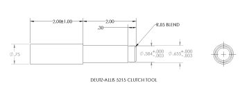

Since the factory clutch tool is unavailable I machined one myself. I'll provide a detail drawing at some point.
The frustrating part of the disassembly / reassembly instructions was told me to scribe the pressure plate and flywheel and reinstall them in the same orientation. Well, what if your installing a new pressure plate? The pressure plate is weighted in 2 areas. At first I thought this was just balance weights, but they are the same on both the new and old pressure plates. What if the original pressure plate was installed incorrectly? In any case I decided to try it in all 3 clocked positions and test run the motor. I found one position to have the least amount of vibration and installed it there.
Teardown / Install Note. While it looks like you can't get the top 2 nuts off without taking the entire dash & pedal assembly apart YOU CAN. It takes a little patients, but a 17mm wrench can be used to loosen both nuts without removing any of the surrounding parts.

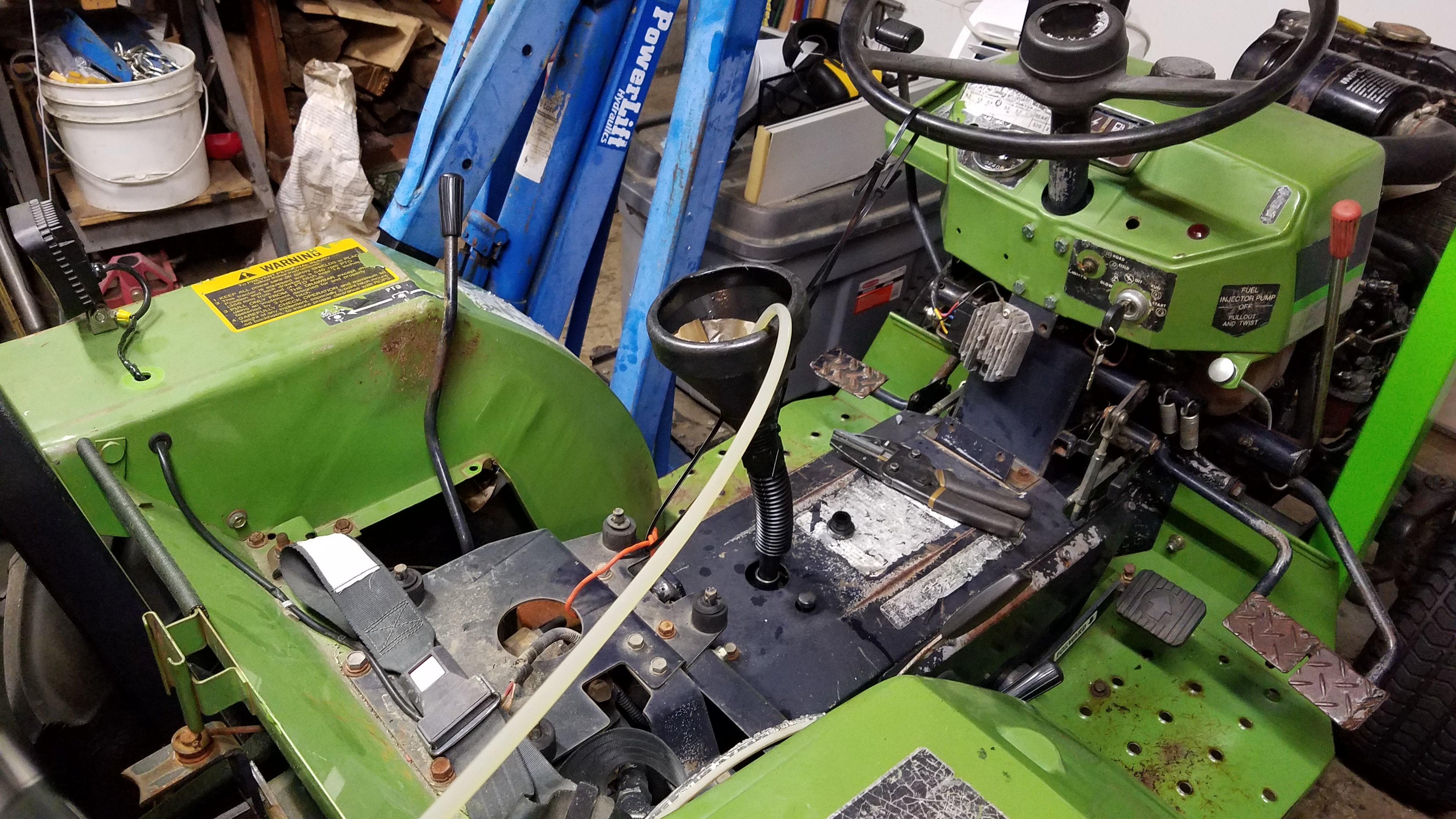

I rejoined the front & back half of the tractor and began filtering the trans fluid last night. The siphon tube is only .25 ID so it's going to take awhile.

Clutch Tool Drawing
Should fit
Hinomoto 172 & 174
Deutz-Allis 5215
Massy Ferguson 1010
