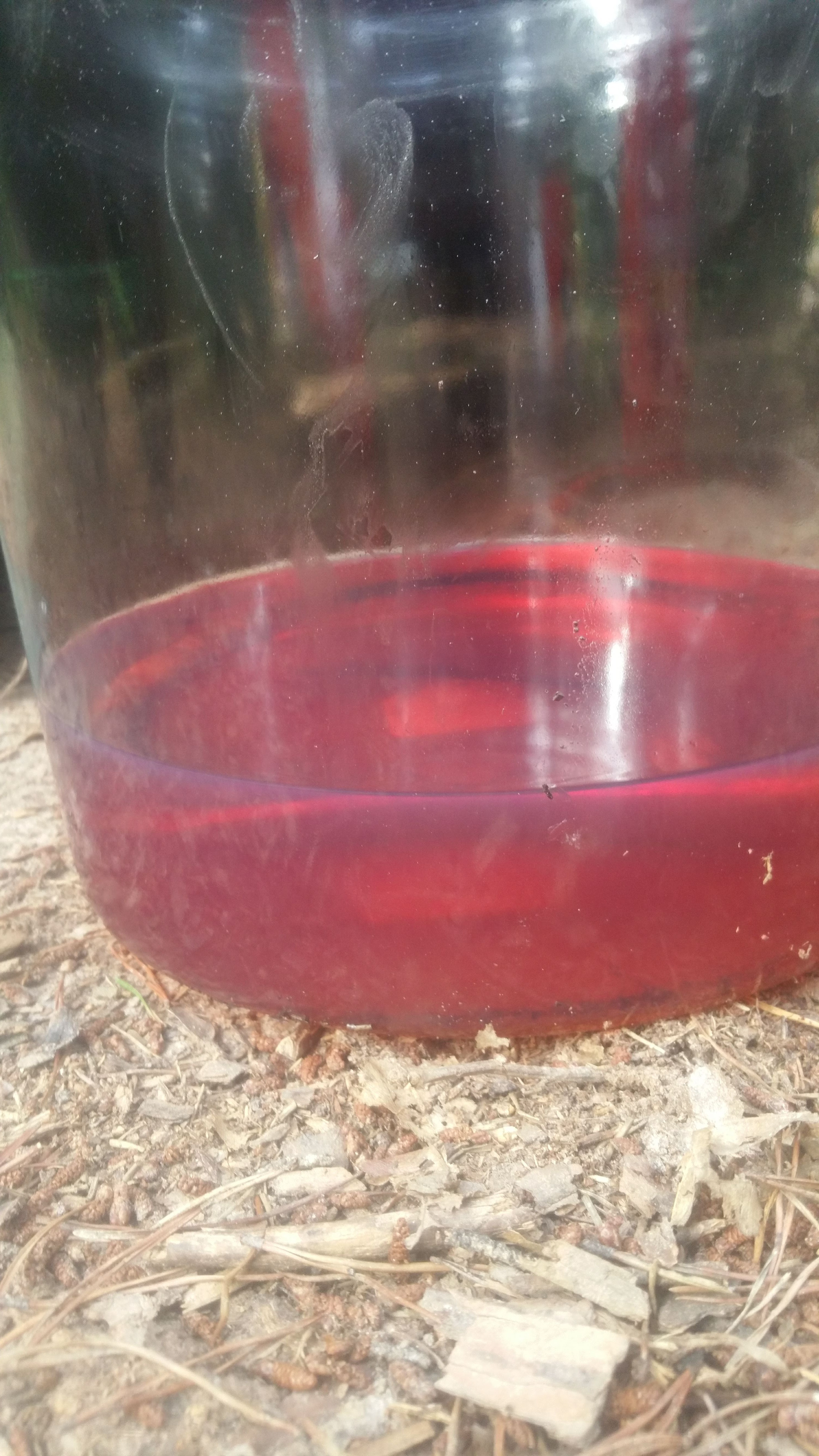

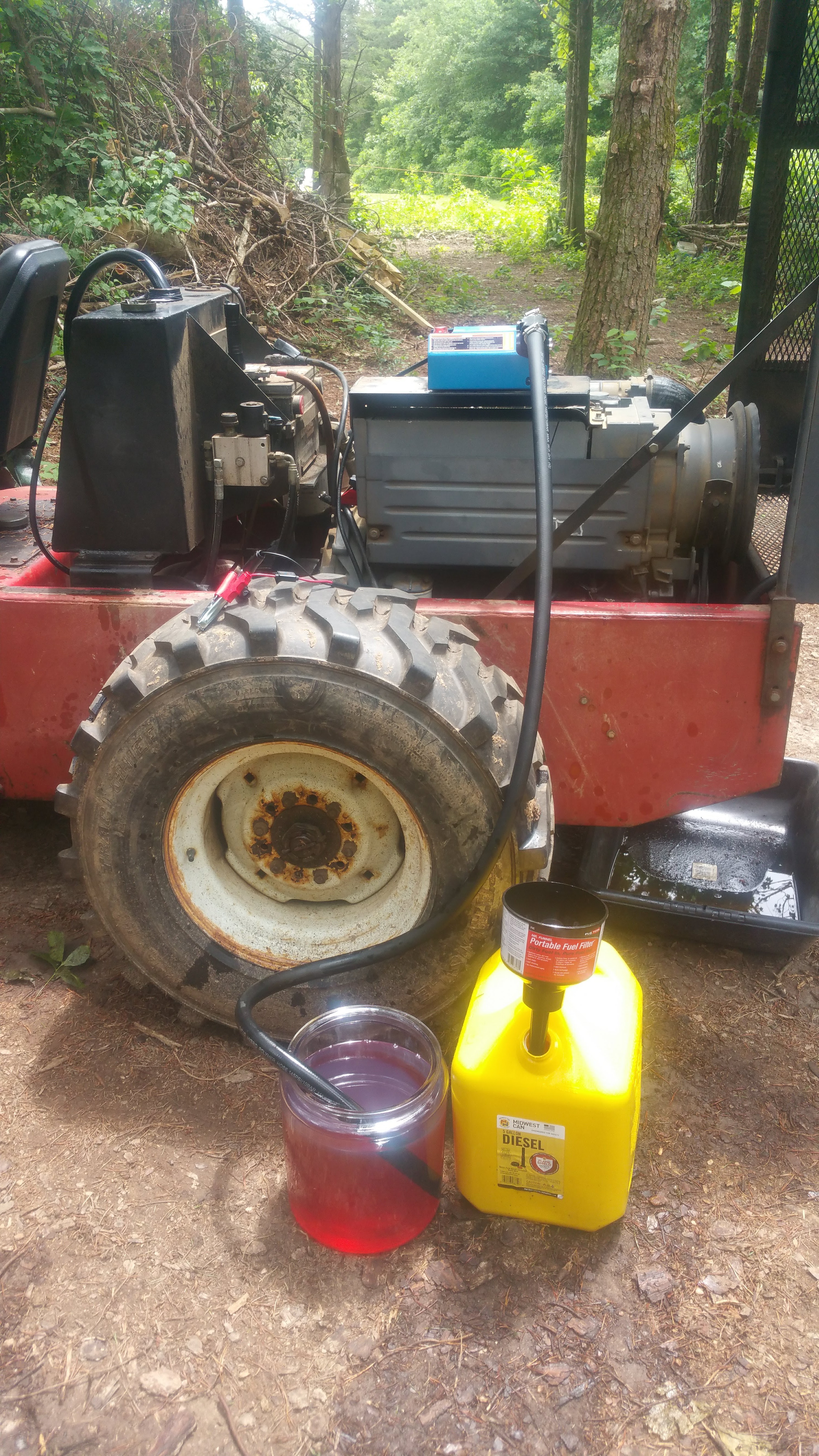

Pumped out the fuel because I couldn't see the bottom of the tank with a flash light to see if there was gunk in it or a clogged strainer. Pumped some of the fuel into a clear jug to check it out.
Pretty clean inside tank and no strainer in my tank bottom at fuel exit port. A little rusty and some dots of little brown funk here and there on the walls. Could be rust or fuel bugs? Not extensive and tank was actually way better than I expected it would be.
Changed fuel filter at engine, checked prefilter again (clean) , 5 gallons of new gas with additives and injector cleaner in tank and fuel filter.
Cut last few inches of fuel line off that looked like air might be getting sucked in due to age cracking in fuel line at engine fuel transfer pump.
Let old fuel sit for a couple days in clear jug and no water in bottom of clear jug, perhaps a little cloudy when pumped out and what might be a very thin layer of something a slightly different color on top?
Started machine and it starts immediately. Oil pressure between 60 and 70psi. Engine sounds perfect.
The start/stop manual shutoff lever stays about in the middle position. I wired shutoff lever in the run position to try to bypass the shut off solenoid? Don't know if that actually does anything without actually taking out the solenoid lever inside engine.
Ran it for 5 minutes and no issues.
Couldn't run it for any longer as I had something else to take care of.
Hopefully, it's fixed. Cant really identify specifically what was wrong with it?
Fuel doesn't look bad to me and there was no settled water in the clear jug after a couple days? Can the fuel still be bad without any obvious signs/water in it?
