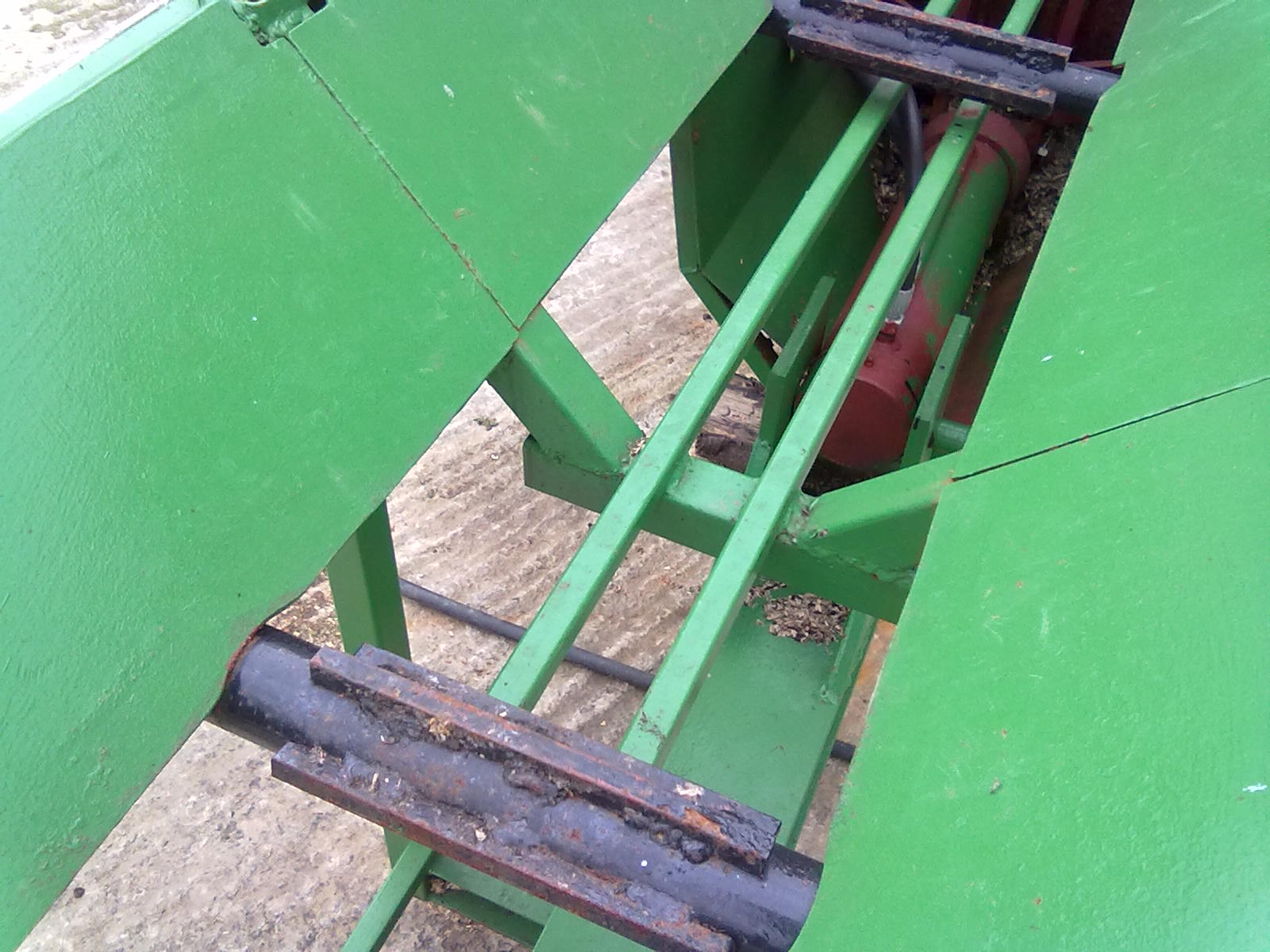

Hello:
I am new at this. I am not an engineer . I want to build a firewood processor. I read several books on hydraulics and am now trying to design it.
I have a question on calculating motor requirements . If someone could review my calculations I would sincerely appreciate it .
I want to be able to move a log 10,000# 2 feet in 10 seconds ( = 12 feet in one minute). This is where the log would be brought up so the chain saw could cut it
I want to figure out what size motor I need to do that. I am ff a model calculation in a book
The log will be moved by a motor with a 3 in sprocket hooked by chain to rollers with 3 in sprockets
1.) Horsepower Required
HP = F x L / t x 33,000 → 10,000 * 12 * 60 / 60 * 30,000 = 3.6 HP
2.) Number of sprocket turns needed to move 12 feet in 60 seconds
n = d / ∏ * diameter → 12? (3.14*3/12) = 15.2 turns
3.) RPM required to achieve 15.2 turns of the sprockets
N = n/t → 15.2 * 60 / 60 = 15.2 rpm
4.) Torque Required
HP = T1 * N1 / 5252 → T1 = 5252* 3.6 HP / 15.2 → 1243 lbft ft
First question if the motor had a smaller sprocket than the rollers than I would need more turns of the sprocket on the motor and I could reduce the torque required Correct?
5.) Torque Reduction
Ok SO now this is where I get confused in the book I am looking at there is a torque reduction N tm/ Nt → rpm motor / req rpm -
I guess I don稚 understand this
Its going to require the same force to move the log no matter what the rpm of the motor is so why does this get reduced ?
IN my instance if I chose a motor with 1000 rpm then the torque reduction would be
1000/ 15.2 → 65.7 reduction so that would be 1243/65.7 = 18.9 lbft-ft
this seems like a tremendous reduction
6.) Motor Flow rate required
assuming 2000 psi
Qm = p * Q / 1714 where p = pressure and Q = HP required
Qm = 2000 * 3.6 / 1714 = 4.2 gal / min
7.) Displacement of the motor
V = Q/N * 231 = 4.2 / 1000 * 231 = 0.97 in (3)
So to move a 10000 # log 2 feet in 10 seconds (12 in one minute) I would need
1.) 3.6 HP
2.) Output torque 18.9 lbft-ft
3.) Flow rate at 3000 psi of 6.3 gal / min
4.) Motor displacement of 0.97 cubic inches
Ok so now pulling out my handy dandy surplus center flier I note a hydralic motor that is $119 Its 4.5 cubic inch Char-Lynn 1044 in- lbs ( 87 ft- lbs) with an rpm of 760 at 15 gpm
I would have to recalculate torque reduction to 760 / 15.2 = 50
1243 / 50 = 24 ft lbs .
so that would still meet the requirements? Now to look a this little munchkin motor and to think its going to move a 10000 log is hard for me to imagine.
Are these calculations correct?
Also I have bee trying to research what motor I would use for the chain saw. The chain saw must go at about 9000 rpm at 5 HP. It seems the faster the motor the lower the HP. Is it possible to get a motor that goes that fast wiht that HP or would I have to mechanically increase the speed and if so that would seem way too fast to use a chain and sprocket ?
I really appreciate any help as does my back ! lol

For the chain saw finding motors that will operate at 9,000 RPM is a challenge. I think Rexroth makes some that are in the 8,000 - 9,000 RPM range. Look at their (A)A2FM series.
On your motor calcs for moving the log the one thing that is difficult to calculate is the inertia factors. I.e. getting 10,000 lbs moving and then stopping it.
Another thing to consider is the efficiency of the Char-Lynn motor. For the model you mentioned I would guess 50 - 60% efficiency. You may want to go the Eaton website and do some looking at the catalog specs on these motors.
Roy
/ Determining Hydraulic motor size #3
I would just use a bigger drive sprocket on the chain saw to reduce drive rpm requirement. What is the hyd delivery and pressure capabilty of your prime mover?
larry
/ Determining Hydraulic motor size #4
MSN56
For moving the log I would look at keeping the motor RPM's lower by using a larger displacement motor. These motors are called LSHT (Low Speed High Torque) and are designed for just that. This should help reduce the start-up time and stop time by reducing over running torque that would be created by a gear reduction system that turns into a gear increasing system during stopping. Flow input should remain similar for the same load.
On the Chain saw part I agree with SPYDERLK on using a larger drive sprocket. What you need to do here is figure torque at what ever chain speed you require. Then start bag figuring motor size. Personally I would probably look real hard and a axial piston style motor for this application since the speed will vary less with load changes due to having an efficiency around 95% and they are rated to higher RPM"s than gear or vane motors. NOTE: Using a piston style motor will require a case drain line that goes DIRECTLY to tank with less than 10 PSI back pressure.
Roy
/ Determining Hydraulic motor size #5
You seem to be talking hyd motors, and using a chainsaw to run something. What about the hyd pump?
You will lose some efficiency from the chainsaw to the pump, and then another 85% to the hyd motor.
To pump 2 GPM at 3000 psi, will require about 4 HP starting out, and then you will lose some HP at the pump, and the hyd motor.

Hi Guys!
Thanks for all of the great input. I ma sure I am going to have more questions when it comes to making up the circuit. IN the meantime I have done a lot of reading and have gotten the calculations down especially the torque reduction. I agree that using a high torque low rpm motor makes the most sense otherwise I would need to do significant mechanical reduction of the rpm which would not be efficient. For the time being I am using the Char lynnn motor for the calculation as that's what I did the math for but the math would work for any motor. I will look at a high torque low rpm motor later and post a calc for that as well
This may be helpful to someone else so I am going to post it here
Determining Hydraulic Motor Size:
I recently posted some calculation in determining how to size a hydraulic motor and I had some confusion in my mind over the torque reduction . I think I have this figured out at this point and would like to post it for anyone else that may want to figure out how to calculate what size hydraulic motor you need.
First just some basic definitions which I found were very useful in helping me understand what we are talking about.

How much torque would need to apply to move that log assuming that you had a 1" shaft with 1/2 " nubs welded to it?
(see this pic https://lh3.googleusercontent.com/-...AAAAGc/4Q1qSxRuMbw/s1600/firewood-processor-l )

To determine the rpm we have to know what size bar will be moving the log. If you note in the pic its a 1" bar with nubs welded to it. Lets say that its diameter is 2"
OK so how many times would the 2" bar need to turn to move the log 12 feet in one minute
C = Pi * D ---> 2 * 3.14 = 6.28 inches per turn
144 inches (12 feet) / 6.28 = 23 times
SO that bar in the picture would have to turn 23 times in one minute to move the log 12 feet in one minute (assuming that each time it turned it turned the log that much)
OK and what torque would that bar moving at an rpm of 23 need to apply to move that 10,000 lbs ?
We know that torque = 5252 * hp / rpm
Torque= 5252 * 4.2 / 23 = 959 ft lbs - seems like a lot

Hey Mudstopper I like that idea :thumbsup: use the cylinder to move the log - could just use rollers on pillow bearings . I am trying to envision this. I could weld a rod hinge system on the plate of the splitter cylinder then have two arms that come up and connect via a horizontal piece that has teeth in it to clamp down on the log. This would need a hydraulic cylinder to push that horizontal var down and hold it there and that holding cylinder would need to move with the log
/ Determining Hydraulic motor size #10
I am trying to envision the clamp you are suggesting, but I cant see any need for it to move with the log. Not sure I can describe what I had in mine. I'll just throw out some made up measurements that can surely vary according to actual needs.
Suppose your trough that holds your log before being sawed, has a bottom width of 8 inches and is 16ft long. You could purchase a 8"X??"X16ft metal band. This band would lay in the bottom of your log trough, maybe on rollers as you suggested. One end would be attached to the push plate on your splitter cylinder. On top of the metal band material, you could weld a series of teeth, (large key stock could work). These teeth should be big enough to grap the log and pull it forward, yet shaped (quartermoon) so that as the metal band slides back under the log, so they cant grap the log to pull it back when splitter cylinder is retracted. As for the clamp to hold the log, this should be designed to grap the log and hold it in place to be sawn when the proper cut lenght is reached. I would suggest maybe make the clamp a couple of vee shaped fixed plate or stough bar material that actually will lift the log slightly as it holds it in place.
To take this one step further, suppose that you use a electric control valve to supply power to the hydraulic cylinder that clamps the log. If you did this, you could use a limit switch to be tripped when the log reachs a pe-set or pre-determined measurement for the wood to be sawn. As the log is advanced by the splitter cylinder, the logend would trip the limitswitch, activating the clamp cylinder, grapping and holding the log the same lenght for every cut. This is the reason I suggest that the clamp lift the log slightly when it clamps the log, this would ensure the log wont be pulled back as the splitter cylinder is retracted.
I can see (in my head) my design plainly, I think it will work, I just dont know if I described it well enought that you can figure out what I mean.
