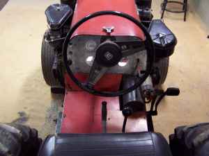

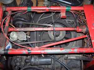

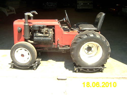

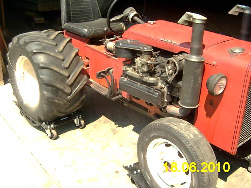

I already have the Corvair engine. I used it for two years in one of our Corvair RVs and I will be taking it out to replace some seals. I'm working on a power plant conversion for that same RV with a larger engine for future use. I already have the donnor vehicle with everything I need.
The pictures below are of a Corvair Pulling Tractor once used for tractor pulls and shows. It is where I came up with the idea of making my own Corvair Tractor. It sold on Ebay this past summer - for way more than it is worth.
The new owner is now trying to sell it, even though he states it runs and works well, he is not haivng much luck finding a new buyer.
I have bad knees and can not have a Manual Tractor, which the one in the pictures is, and this is yet another reason why I want mine to be hydraulic. I want to simply push on the pedal and it goes - just like a car. :D
Tony

I built a Power King from a Ford Pinto with a 9HP wisconsin engine. It was successful. I scraped it.I would suggest you pick up an existing tractor and drop the corvair engine up front. Use the existing wheels etc., why bother reinventig gear reductions.

I would find a hydrostatic drive tractor with a bad engine and install the vair engine in it. You are not going to have enough gear reduction trying to use an automotive rear end. Blowing snow requires high RPM's and sloooow speeds. On my tractor in 1st gear at wot I can crawl faster. You could modify the hydrostat controls to be hand operated. good luck.
