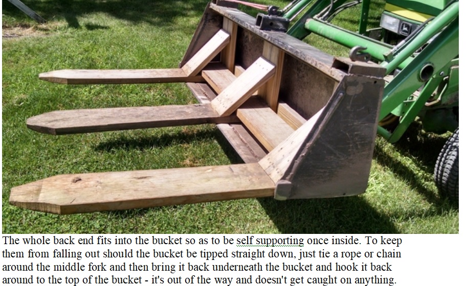

I would
  1. Clean out trash from landing area
  2. Remove sheathing from gable ends
  3. Use chainsaw to cut across tops of (2 out of every 3) studs on the side you are pulling from
  4. Attach chain or cable to top of that wall
  5. Pull it over (it should pretty much collapse on itself
  6. Buy or build a set of forks
  7. Take debris to a burn pile
Here's a pic of wood forks a fellow TBNr built.
  • Wood Forks.pdf
