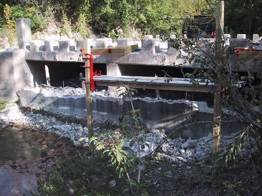

I have made a good bit of progress on this project and will update it. I have attached a picture of the current state of the wall. I used an electric jack hammer and as you can see in the picture, pump jacks for a scaffold. The scaffold was the key to making this work as I could not work on top of the wall without it.
I bought a Harbor Freight jack hammer for $400 and thought it should last at least 90 days for this project. Boy was I wrong. I went through three of them before I spent another $400 to replace the motor with a Bosch motor. It turns out they just bought a Bosch jack hammer ($1350 new) and tried to make an exact copy of it except for cosmetics. Well as I already knew, the Chinese cannot build motors period and especially not for severe applications. If you are thinking about buying one of these bargans - just be forewarned that you will be sorry.

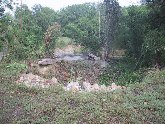

I still have a little ways to go on the wall but now the bridge is a bridge again and I started work on the really hard part of this project - fillinging in the washouts on both sides of the bridge. After clearing lots of trees and brush from the South side of the bridge I was left with a dished out area about 35 feet in diameter and anywhere from 8 feet to 4 feet deep. It took approximately 95 yards of fill which I dug and moved with my tractor to ge this side passable. The attachment is a before picture after the vegitation was removed.

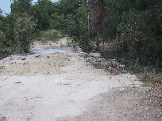

Another before view.

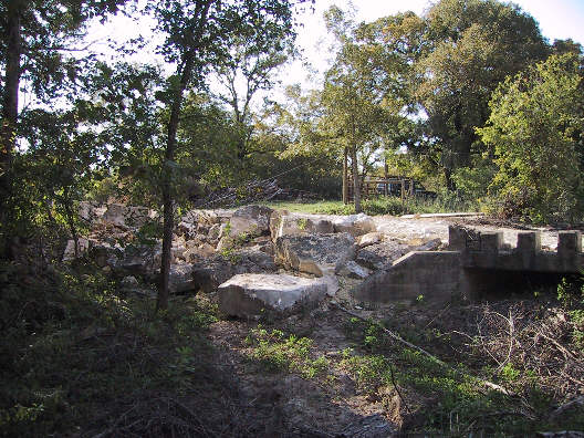

This after the fill was moved.

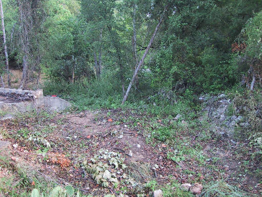

This is the backside of the filled in area showing some of the boulders and rocks I placed for erosion control. A few of these boulders tested the limit of my tractor to move them. There were a few hairy moments involved.
