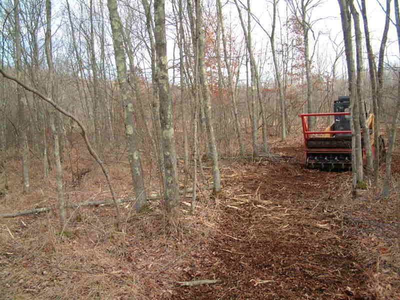

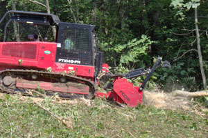

I like my Fecon...I was in 6"-8" swamp maples all day yesterday...gettng rained out today...since I am in a swamp..

Looks like the jobs that I get alot.The trees on your immediate left, as you are seated, are my normal size to mulch and clear. Only lots more and closer together. Thanks for the pics. I will post my new website in a few days as soon as my videos get posted.
