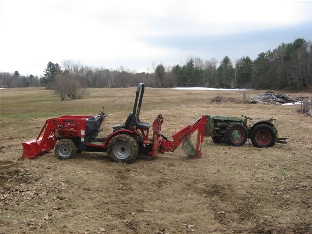

Well, finally got some photos to post, I know that is the rule when you buy a new tractor. So far just digging a few stumps, some rock removal/moving and cleaning up my yard. Although, my neighbor came over to see it the other day and he wants to try pulling a hay rake with it this summer! I told him I'd be willing to give it a shot, Ive never taken part in any Ag tractor activities and I dont know the size of the equipment. From what he says, you need a pretty good speed to pull it at therefore im skeptical that it will have enough power to pull it at the speed needed in high range Hydro. I'm very impressed with my tractor overall, but the high range hydro won't blow you away.

Nice tractor you got there... congrats. What is that tractor in the second pic?

That is my other tractor - its a 1967 Holder AG3, 33hp two stroke diesel, full time 4 wheel drive articulated tractor. I aquired it from a family member about 5 years ago, who hadnt run it at all in 10-15 years. A little cleaning and new fluids and it runs great! I've never seen another one in the states. It was built in Germany. Its quite a machine and a lot of fun.
