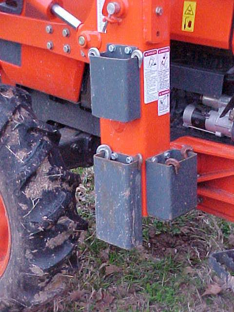

It looks like you need a chain box. This is square tubing with a strap cross the bottom. This keeps you from accidently dumping your chain.
That looks like a good idea I think I saw that pic. somewhere on here before but I had forgotten about it.These tractors are so "compact" its hard to find a place to attach something where it won't interfere with moving parts.
