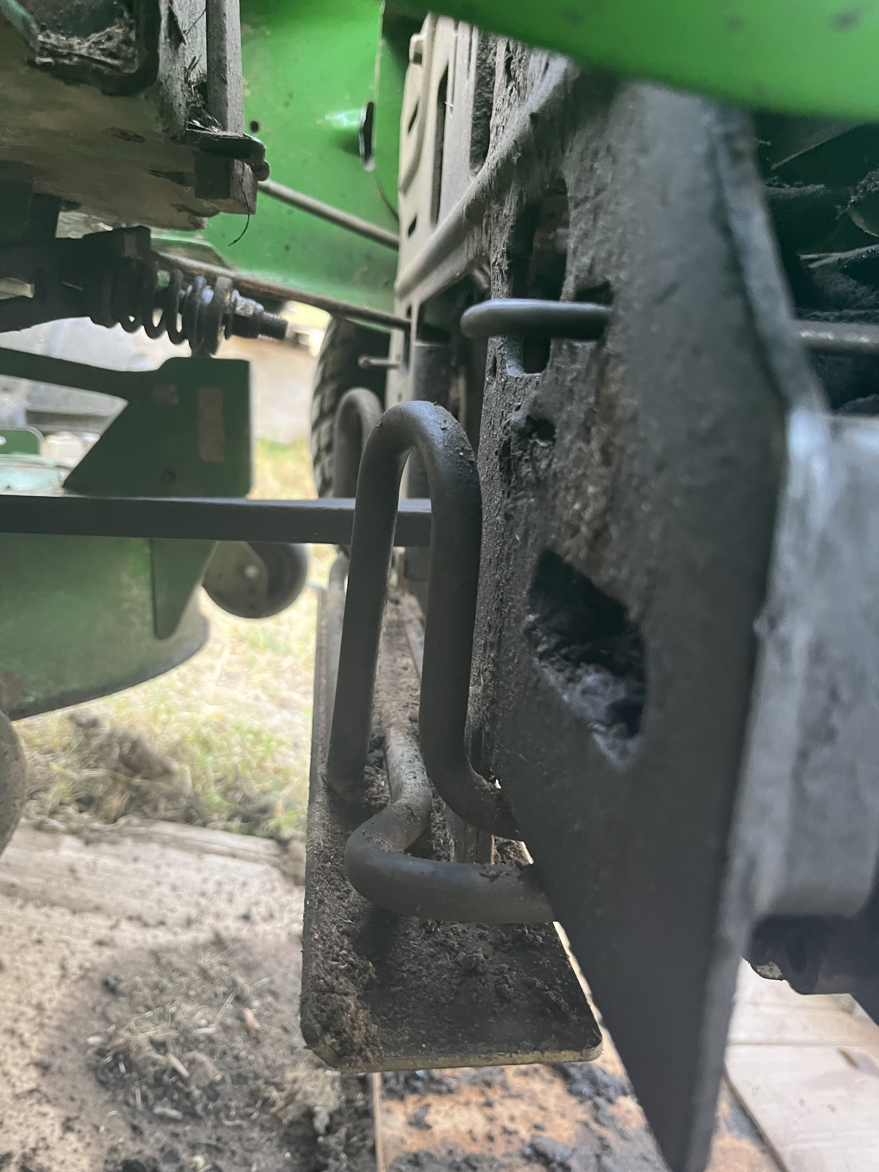

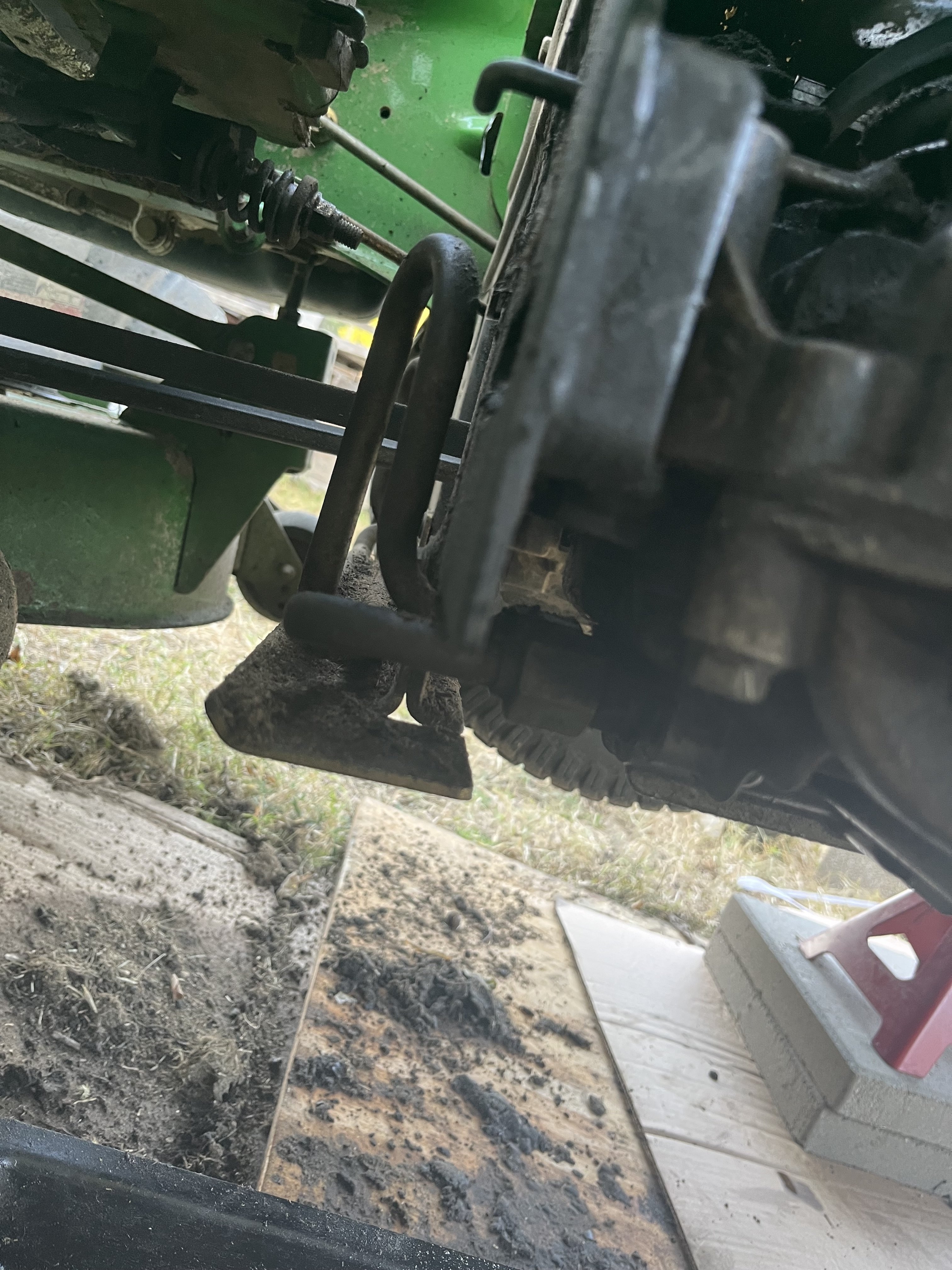

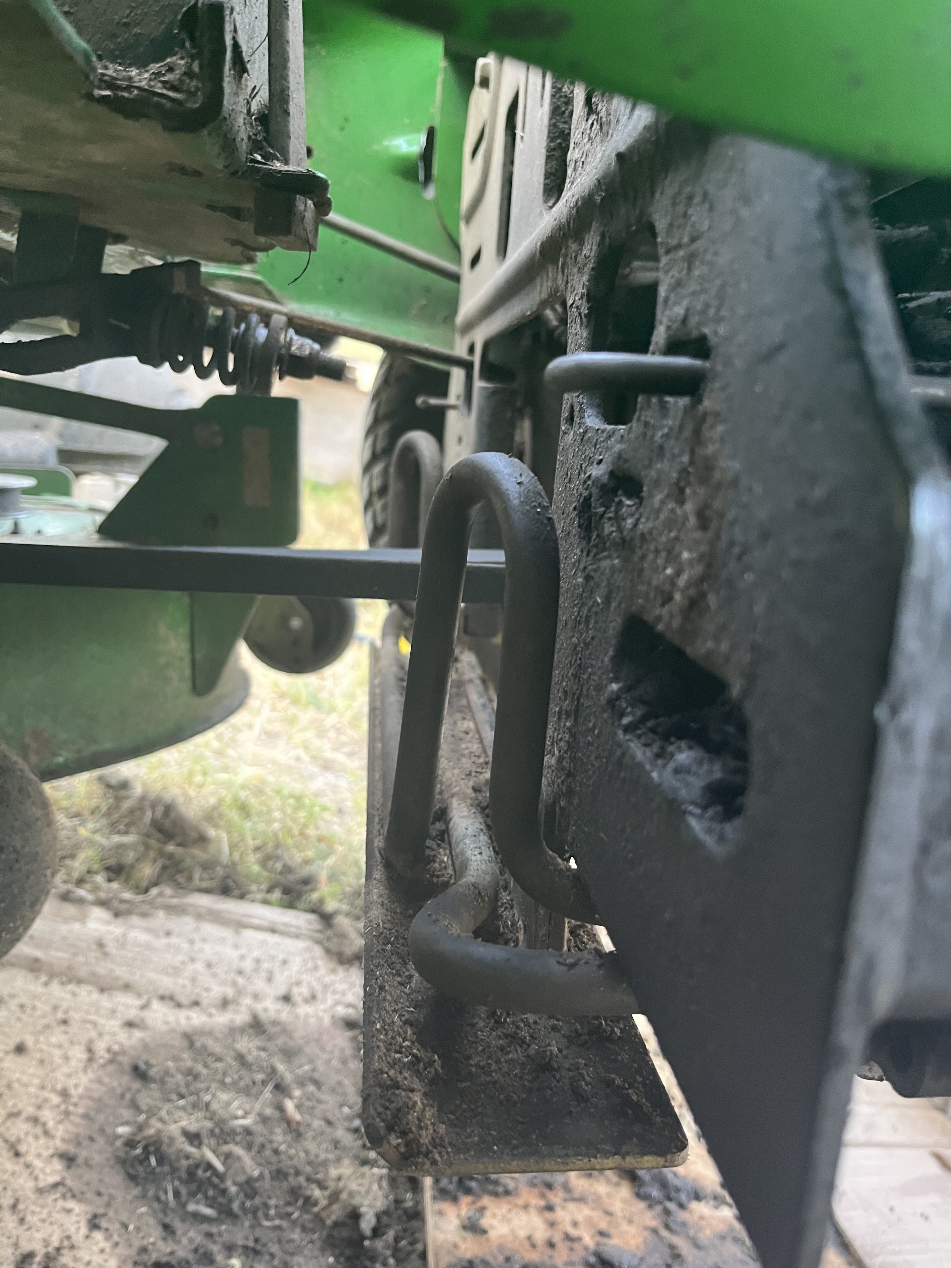

Changing oil and filters,noticed a leak in left side transmission.Aftre changing leak became worse.Trying to remove transmission,watched a couple utube videos.My model seems to nave a recirculating system,two pipes,deck side going to and from other transmission.These lines apparently need to disconnect to remove transmission.Must be old works that has been deleted?tia

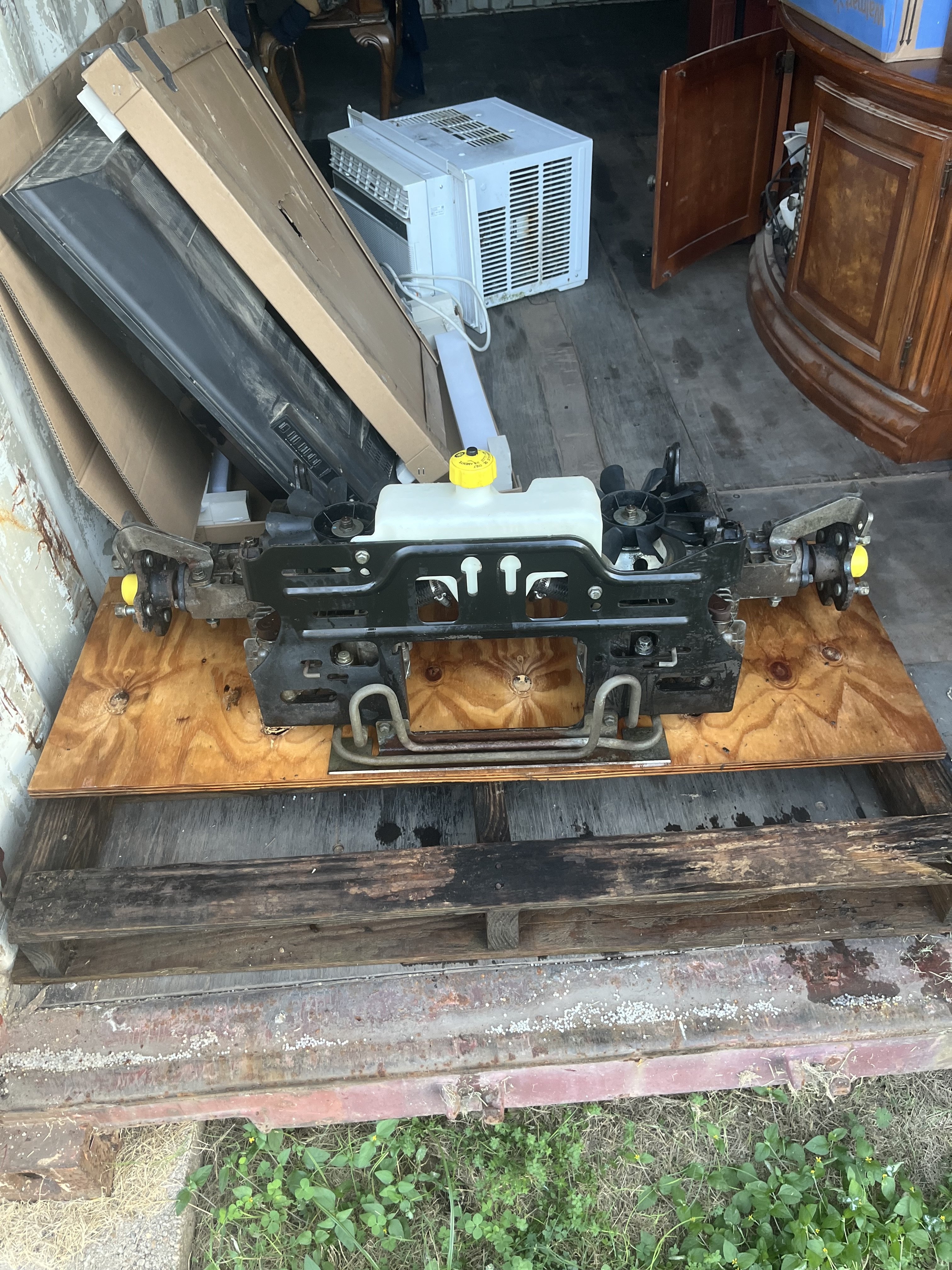

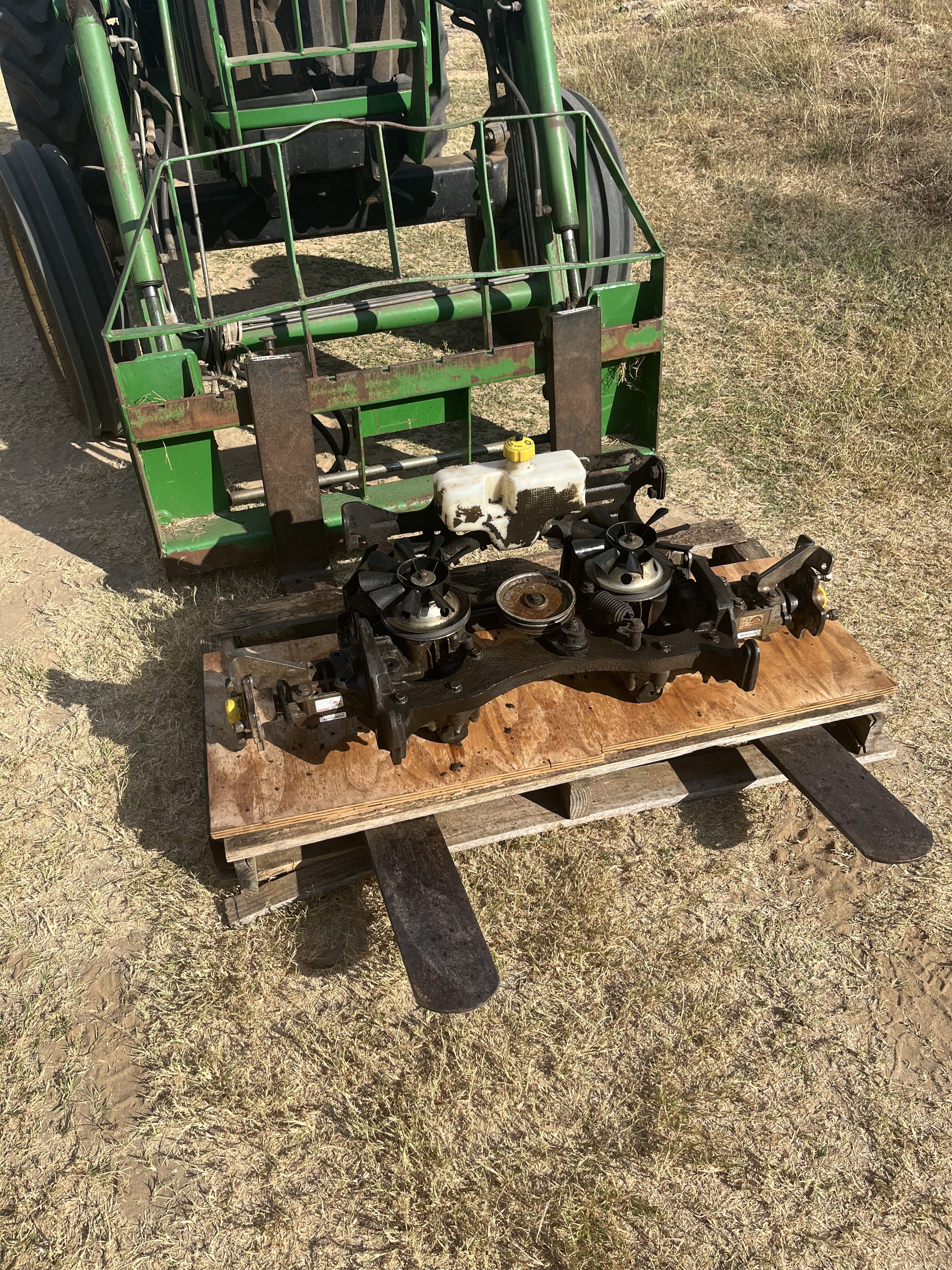

I think they can come out as a pair when you remove the crossmember, reservoir etc.
/ 2009 Z920A transmission

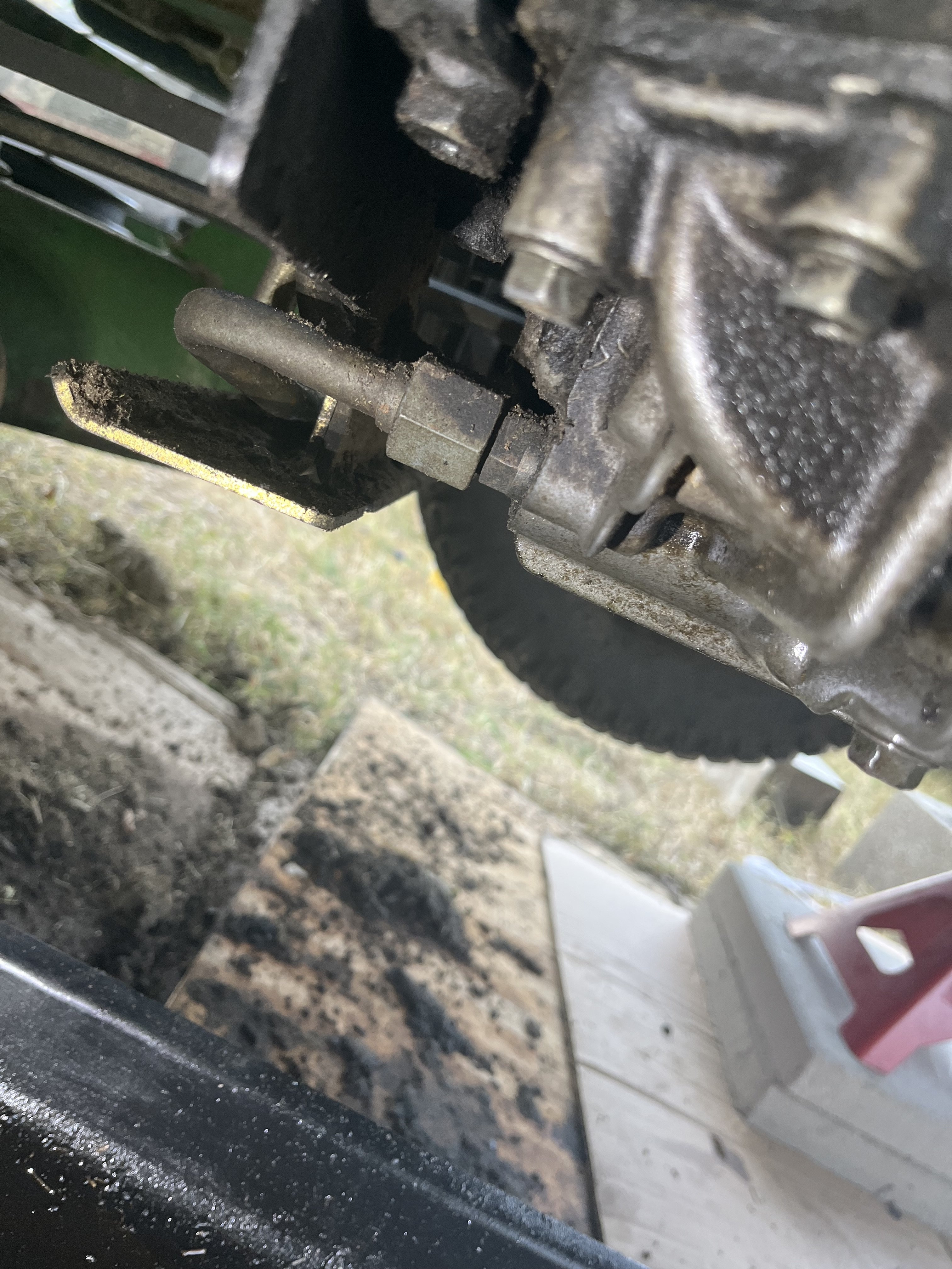

Yes easier to remove both on the crossmember in my opinion.Cleaned up now need to find leak and decide whether to replace other seals will at it. Owner is 16 yo and been a good one!
Found the problem,plastic cracked!Now to get new parts and reassemble.
