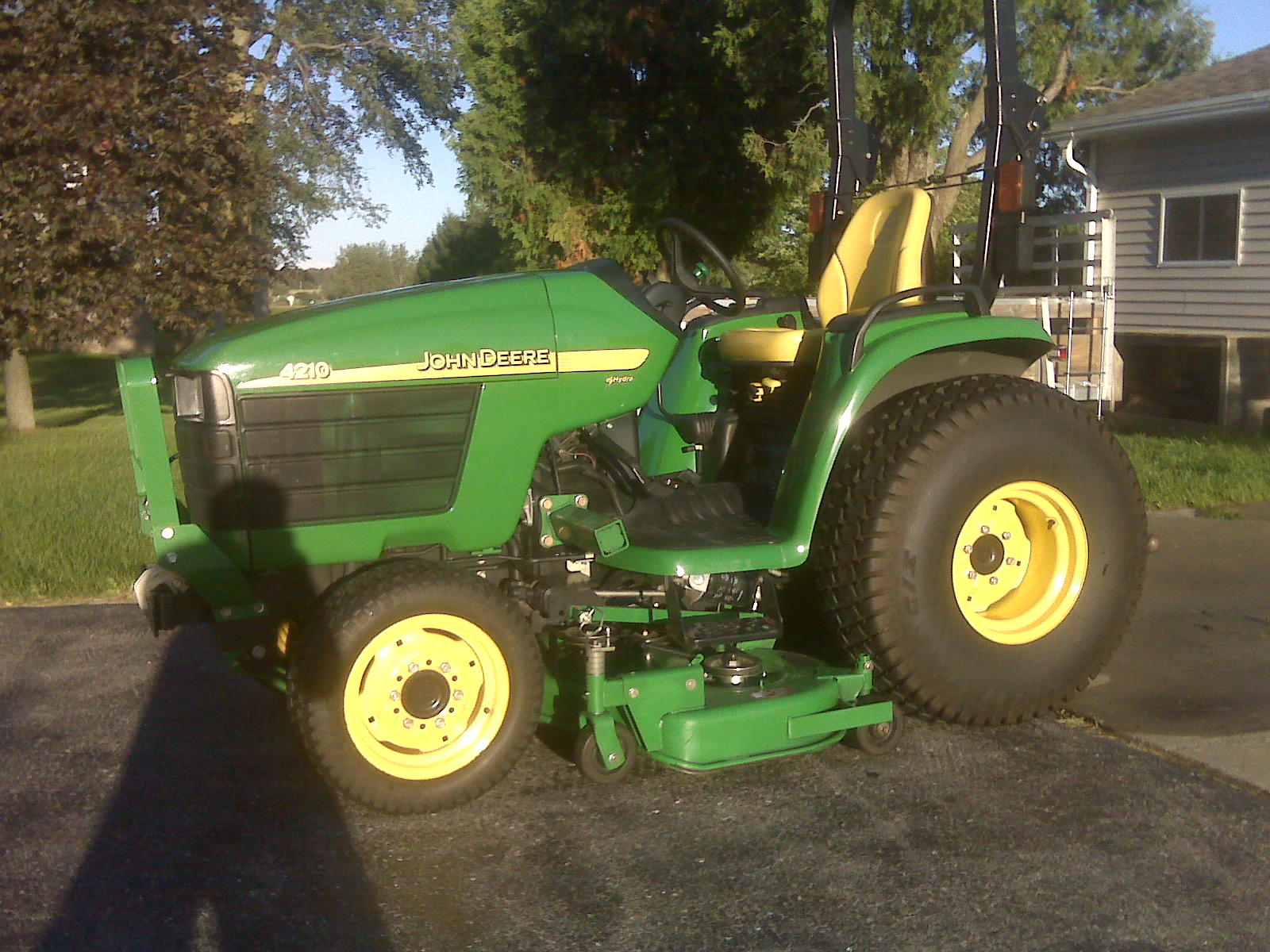

In April 2003 I took delivery of my 4210, it came with a 60 inch 7-Iron deck, the 420 FEL, and a 72 inch Frontier rear blade. I really had no idea what to expect as far as reliability, because it was my first "real" tractor.
Until yesterday, aside from regular oil and filter changes, two hydro system fluid and filter changes, one air filter, one fuel filter, one coolant flush and refill, and one new fan belt, plus a new battery, my green machine has required NOTHING, repeat NOTHING, in the way of repairs, only the routine maintenance listed.

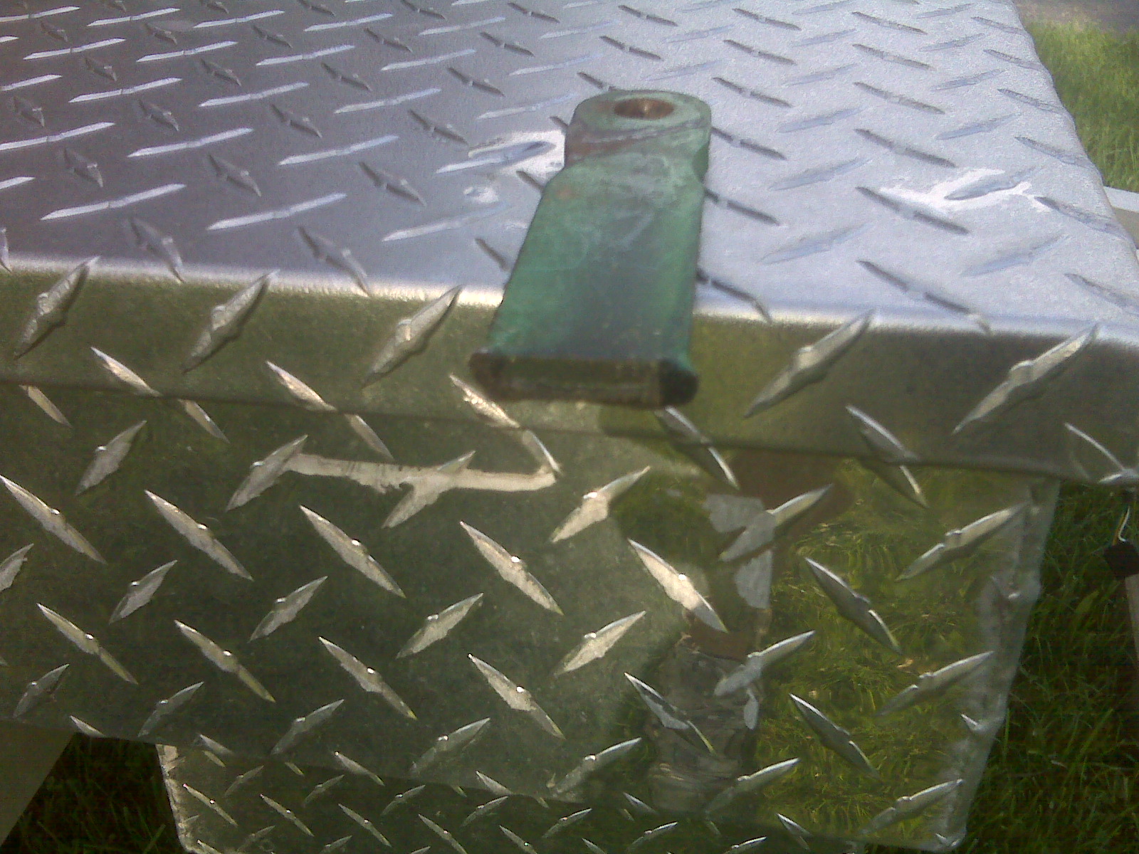

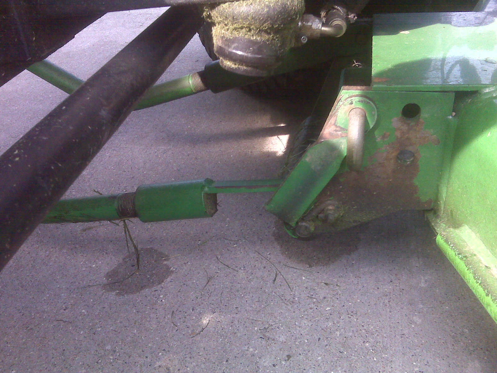

Before beginning mowing yesterday I did the customary fluid checks and eyeballed the tractor to see if anything was amiss. Much to my shock, I spotted a broken draft arm clevis, Deere only welded one side of it and it flexed and broke. The other clevis was supporting the entire front deck weight, and there was still only a 1/4 inch difference side to side!!!
I raised the deck with a jack, and swiveled the unbroken side of the clevis around to support the deck with the J-pin, and will have both clevises rewelded this fall after I remove the deck for winter.
Man, I should really be upset, my Deere FINALLY gave me a real, honest, MECHANICAL PROBLEM, and it only had 881 hours on it....:laughing: :laughing:
If I ever replace my 4210, it will be with another John Deere....you can be SURE of that !! :thumbsup:

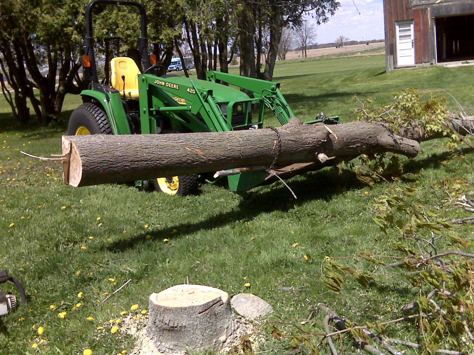

What do you use it for besides mowing?
/ Deere quality--nobody builds better !!
Grading, backfilling, moving half ton rocks, hauling yard waste, brush, firewood, gravel, topsoil, hoisting shingles to roof level, getting people unstuck in the winter, plowing my near 1/4 mile driveway of snow, clearing the driveways of 5 of my neighbors in the winter, excavating soil for concrete slabs, moving large tree trunks, etc.

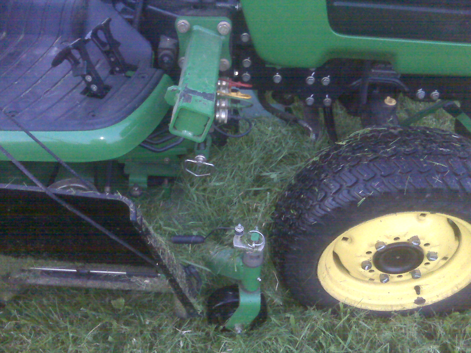

Thank you for asking about the mower. it is a 60 inch 7-Iron, probably have about 650 mowing hours using it. I just replaced the OEM JD blades this year, and the OEM deck belt looks good for another 5 or 6 mowing seasons. Aside from the broken clevis, ZERO problems.
However, I have posted elsewhere in this forum about my issue with the cutting height of the deck, and advised other members who are considering a tractor/mmm purchase to check into the cutting height before they buy. The same deck installed on the next larger model (4310) will cut a maximum height of 6 inches. Mine is limited to 4 inches maximum, which creates a HUGE headache when it rains frequently where I live. Many times I cannot mow because it has rained so often, and the deck is next to worthless at recutting clippings. WORTHLESS !!! It simply vacuums up the already cut grass and blows it out the discharge chute. The attachment shows the problem clearly...I was recently cutting 6 inch high grass, perfectly dry, at maximum 4 inch height. The clippings just build up on top of the uncut grass and the front of the deck pushes them up onto a pile. No matter what RPM I use, what speed I travel at, chute up or down, and nearly new Gator blades, I still end up doing a HUGE amount of raking to get the clippings off the lawn. And my grass is not THAT thick. How I wish I had the extra two inches of cutting height, but aside from this problem I love my tractor.
If only it would just chop the BLEEPING GRASS UP BETTER it would be perfect.

Not sure how Deere missing a weld is a good thing, maybe its just me. What else did they overlook? I don't get it...Manufactures with better quality control and don't miss welds in the assembly build better!!

The clevis would be difficult to weld on both sides of the tabs because they are so close together. They could have welded both sides of one tab and then done the outside weld for the second. When I have them rewelded I am going to ask them to add reinforcement between the tabs to eliminate the flexing.
BTW, the installation manual for the deck front draft arm assembly is WRONG, period, if you have the FEL and grille gard on this model tractor. You cannot rotate the draft arm lever as described, because it hits those components. And the moron who originally assembled the draft arm at the dealership did it wrong, so the tractor as delivered could only cut 2 1/2 inches maximum height.
