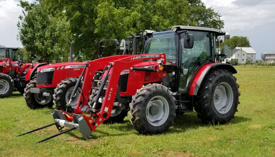

If weight isn't an issue, I think the MF 4707 is the best value 75hp utility tractor on the market right now.
My only negative on it is the turning radius on tight corners.

I watched the Massey video of the 4707's powershuttle having a neutral position so you can control everything with your left hand
with what looks like a light effort control.
Your left leg isn't used for anything. That sure got my eye, just what I'm looking for. But do the others have it?
Perhaps I should ask this in another thread about powershuttles but would be interesting to compare the OP's two models noted.

The MF has declutch functions on shuttle shift lever and 6 speed lever. On shuttle shift, simply lift lever and shift 6 speed trans or just stop. On the 6 speed lever, there is a side button. The shuttle shift is also adjustable in sensitivity. Smooth or aggressive. Very nice features
The RX7320 is similar. Powershuttle lever is to the left of the steering wheel. To shift from forward to reverse simply lift the lever and move it. No clutching. To shift between gears in the same range there is a button on the gear shift. Simply press and shift. No clutching. To shift between ranges one needs to use the clutch pedal. I don't believe the range changes are synchronized. I always stop when I change range.
The sensitivity/speed at which the tractor decelerates/accelerates when using the power shuttle can also be adjusted. There are some buttons for that.
The RX7320 has 4 gears in 3 ranges where I believe the MF4707 has on 6 gears in 2 ranges. I can see the benefits of both.
