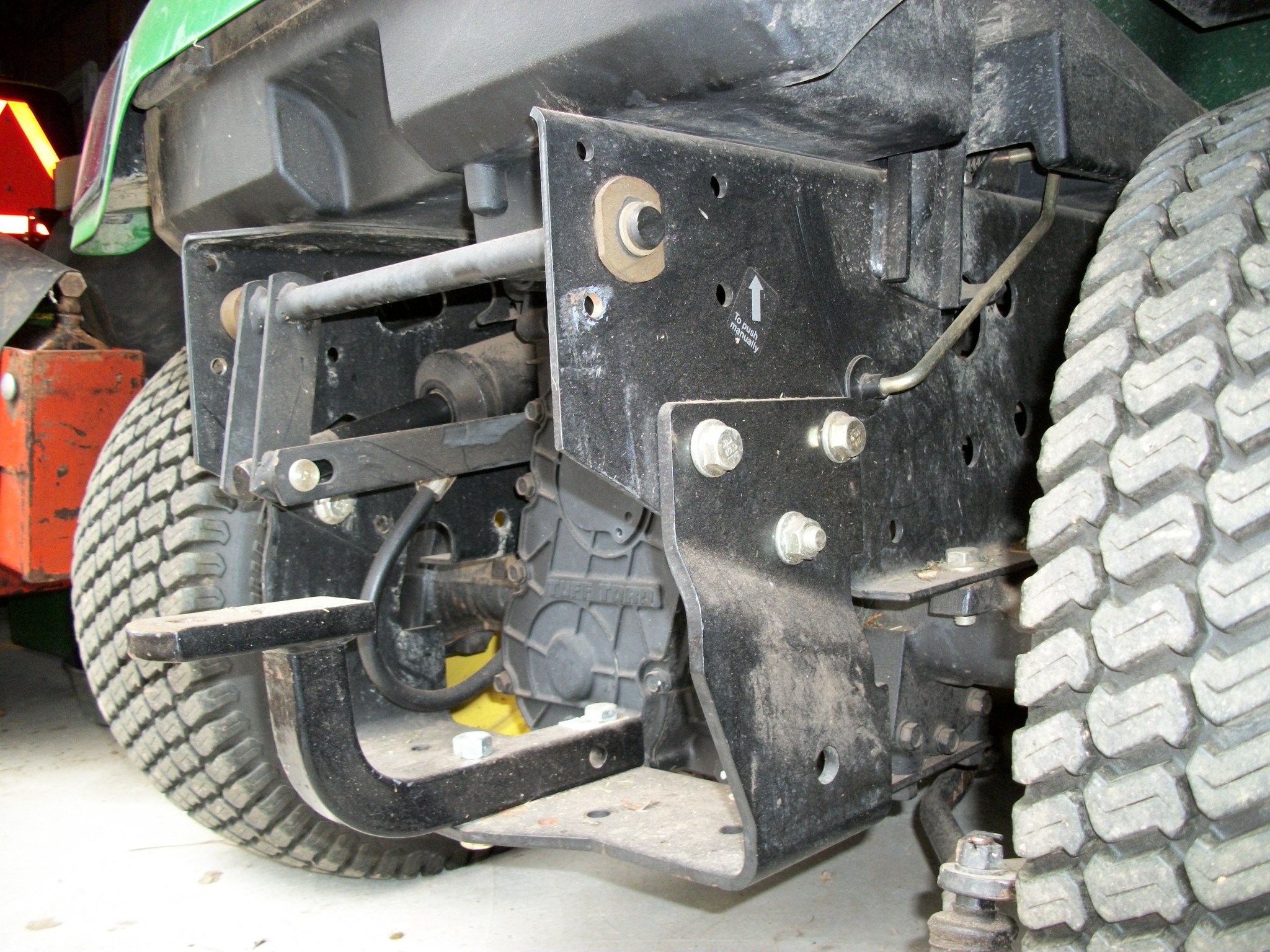

I got a used MC519 for my 455. It didn't come with an attachment for the 455. So, my question is for anyone who has this setup, do I just need two bolts(with some type of spacer) for the two holes in the side the the hitch bracket for the MC519 to attach to? IS is there another bracket I need.

I'm not exactly sure what you're referring to when you talk about a spacer for the bolts. I have a 455 with MC519 cart. Look at this picture of my rear end setup and see if that helps. I just have the standard 2 bolts.
Do you have the parts that attach the blower assembly to the mower deck?
There is a front hangar bar that attaches to the deck, a chute guard on the deck, and an additional sheave on the outside blade spindle where you attach the pulley from the blower unit.

Thanks, that REALLY helps! I have all the parts for the deck, just no sure how the cart attached to the tractor at the back. It looks like I just need the two bolts to connect the MC519 to, but I want to make sure, so I will look tonight.

Scott, look carefully at the picture again - the bolts are not attached directly to the rear tractor frame, but rather to a separate U-shaped bracket that bolts to that rear frame. And in this installation, the hitch ball is used to hold the bracket in place - I just use a bolt on my 455 / MC519, but it's the same idea.
You'll need that bracket and the attaching hardware.

Yep, very good to notice that Tim. I guess I forgot the dealer installed those bolts and bracket many years ago and just assumed it was on all 455's.

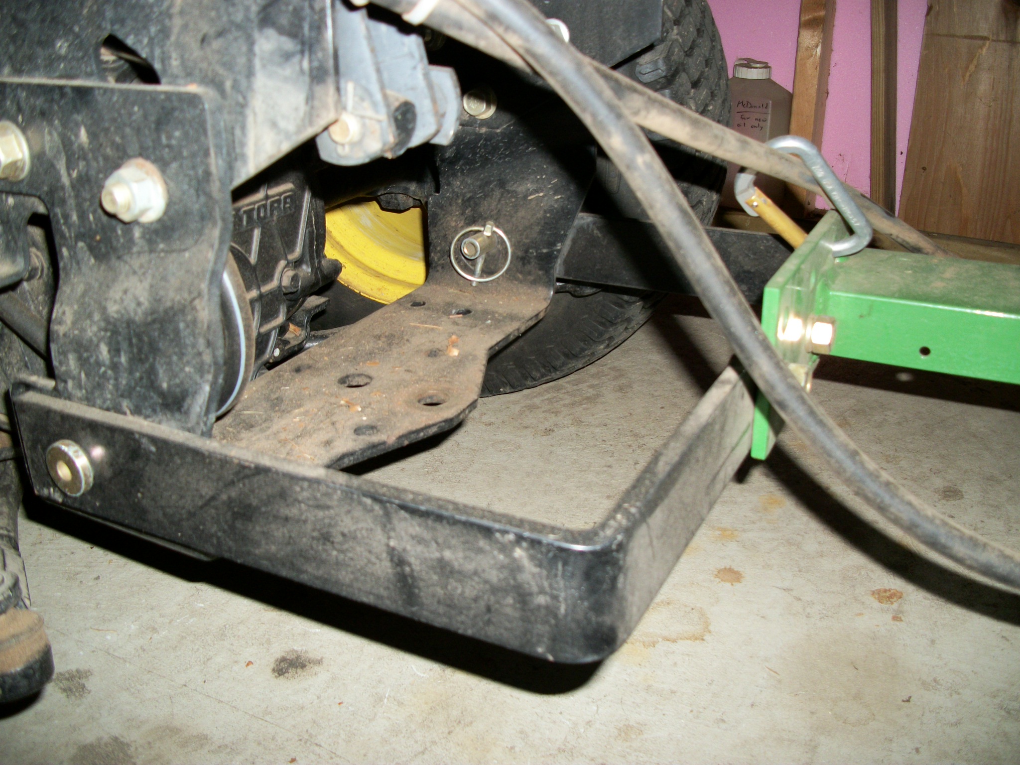

I tired of the bracket that came with the MC519 cart that had the hook and sliding lock (too often it came unhooked and bent things up real quick). So I had a piece of flat steel bent that would molt to the cart and then just dropped pins in to the standard rear frame of the 425/445.
Pics here are of the bracket on the 425 and just the frame on the 445 where you see the holes where the bracket attaches.
I don't lose the cart anymore, and hooking up isn't much different than before.

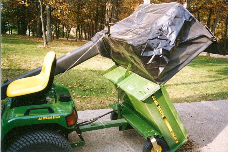

Having the 3 pt, seems that something could be designed that would open the cart top when the 3 pt was raised so the cart would dump. May even be easier to design with the addition of the hyd. top link.
I bought a hyd. dump for my cart years back, and not having to get off to dump the cart is a real treat.
You make a good point, as I am adding a hydraulic top link next week or so. I could install a diverter at the back or simply unplug the top link and hook up the lift cylinder hoses and set it up as you have done.
I appreciate you posting the picture as it makes it easy to see how the cart hooks up. I think it shoult adapt to IMatch easily. I have a horizontal drawbar that has been sitting in my shed for 15 years, looks like a good use for it.
