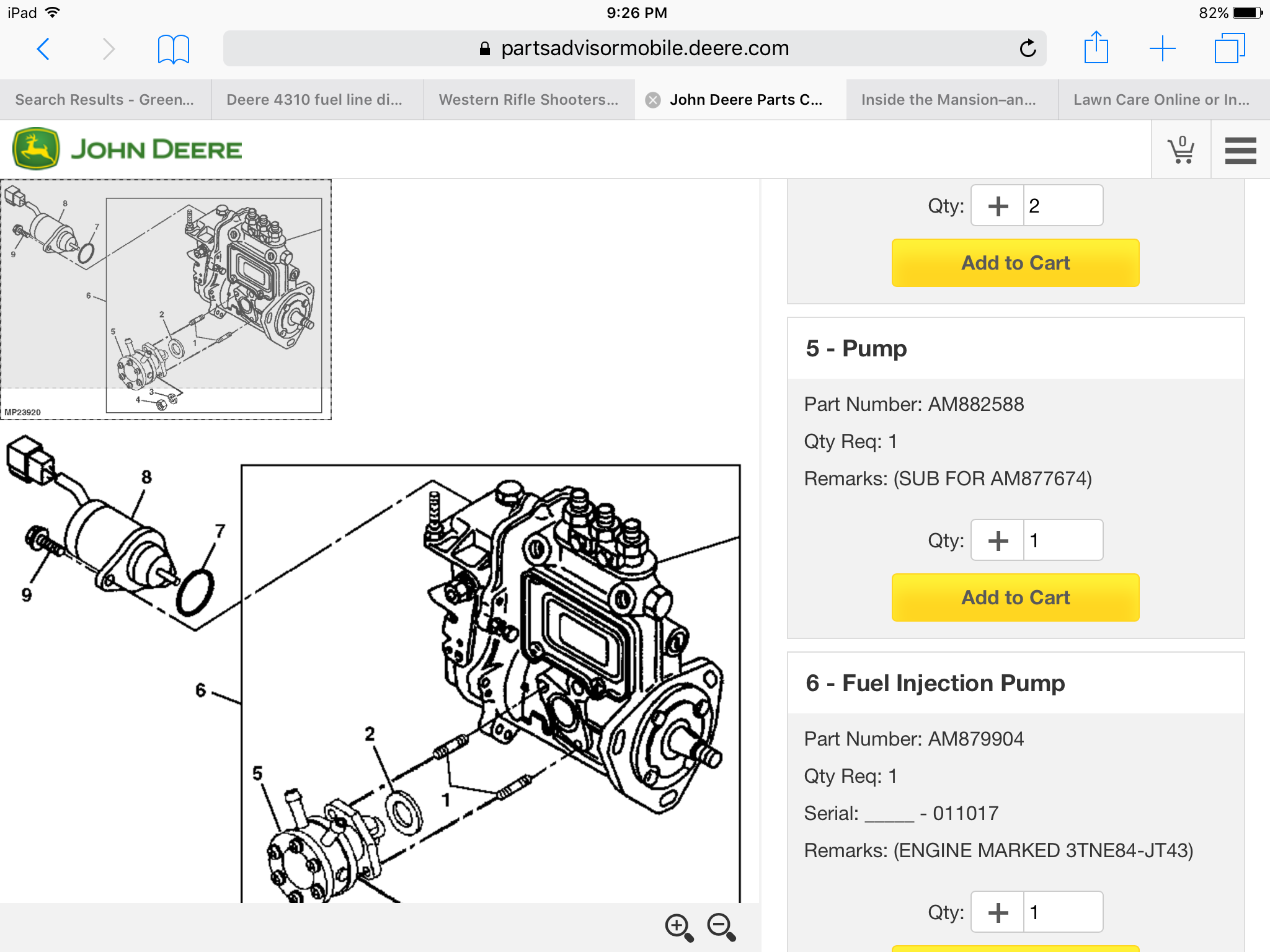

I have changed the fuel filter, changed the fuel in tank, replaced selenoid, prayed and wept a little. I have manually filled the line from fliter to injectors and it will run until that fuel runs through, but no fuel moving from filter housing into line. The filter housing is full of fuel by me. Any advice would be apreciated.

either your screen is plugged in the tank or the fuel pump is so worn it has zero suction.
   / Deere 4310 fuel line difficulties #4
Lift pump. Part #5

Pull the lines off the lift pump#5.. have someone spin the engine.. FEEL if its sucking one way & blowing the other..
IF SO.. reinstall the lines.. MAKING SURE they go on the correct way..
Loosen the return line banjo bolt on the injection pump & Pressurize the fuel tank w/ a little shop air..
Spin the engine while doing this.. the air should be dispelled & fuel should come out of the loosened return line bolt.
Tighten.. NOW, loosen the lines AT THE INJECTORS & spin the engine until fuel squirts out & tighten..
