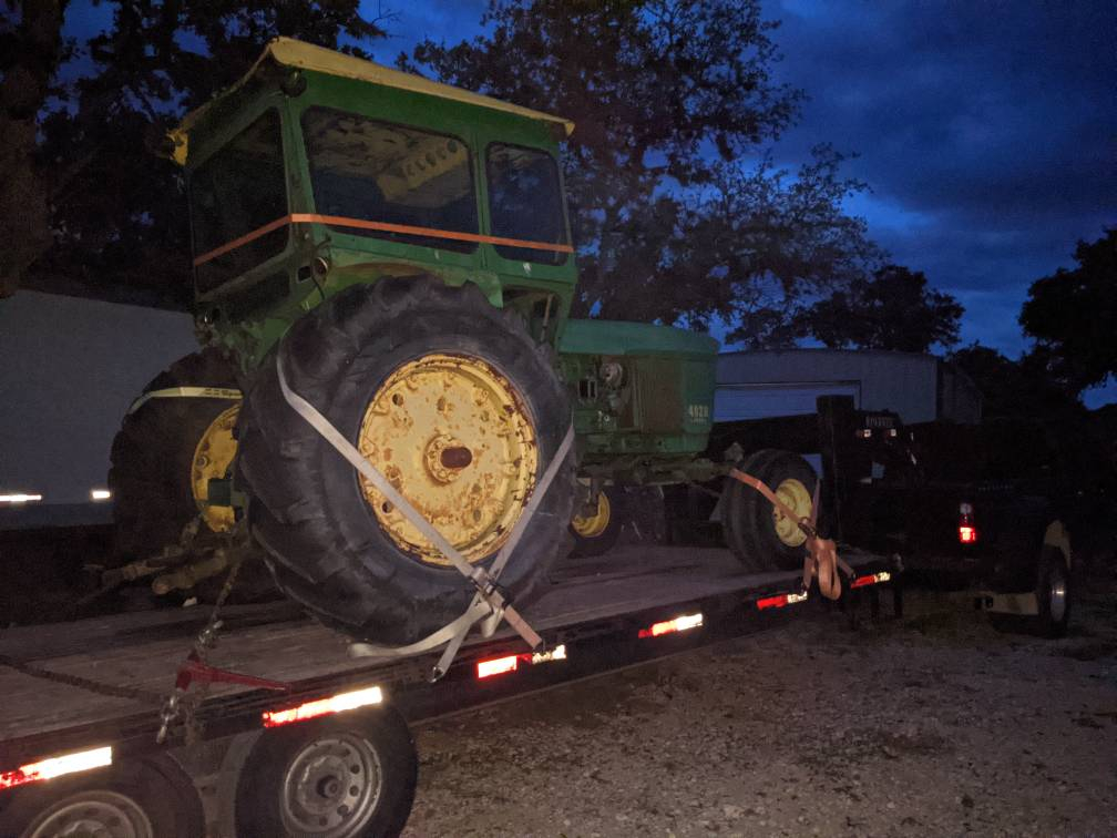

Just got it home...by the time it was all said and done, we paid roughly $7500 for it.
   / Deere 4020 #18
Congratulations. I bet it will serve you well. But do fix that AC.
