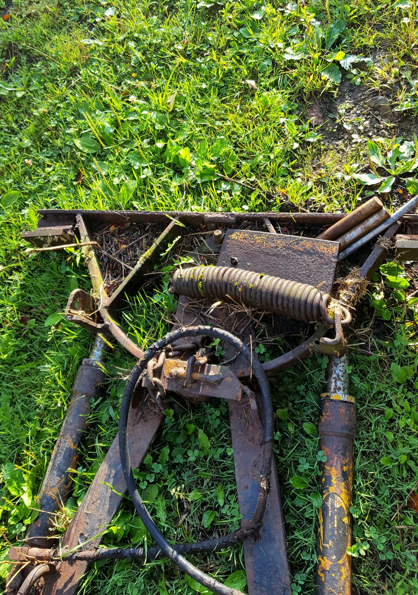

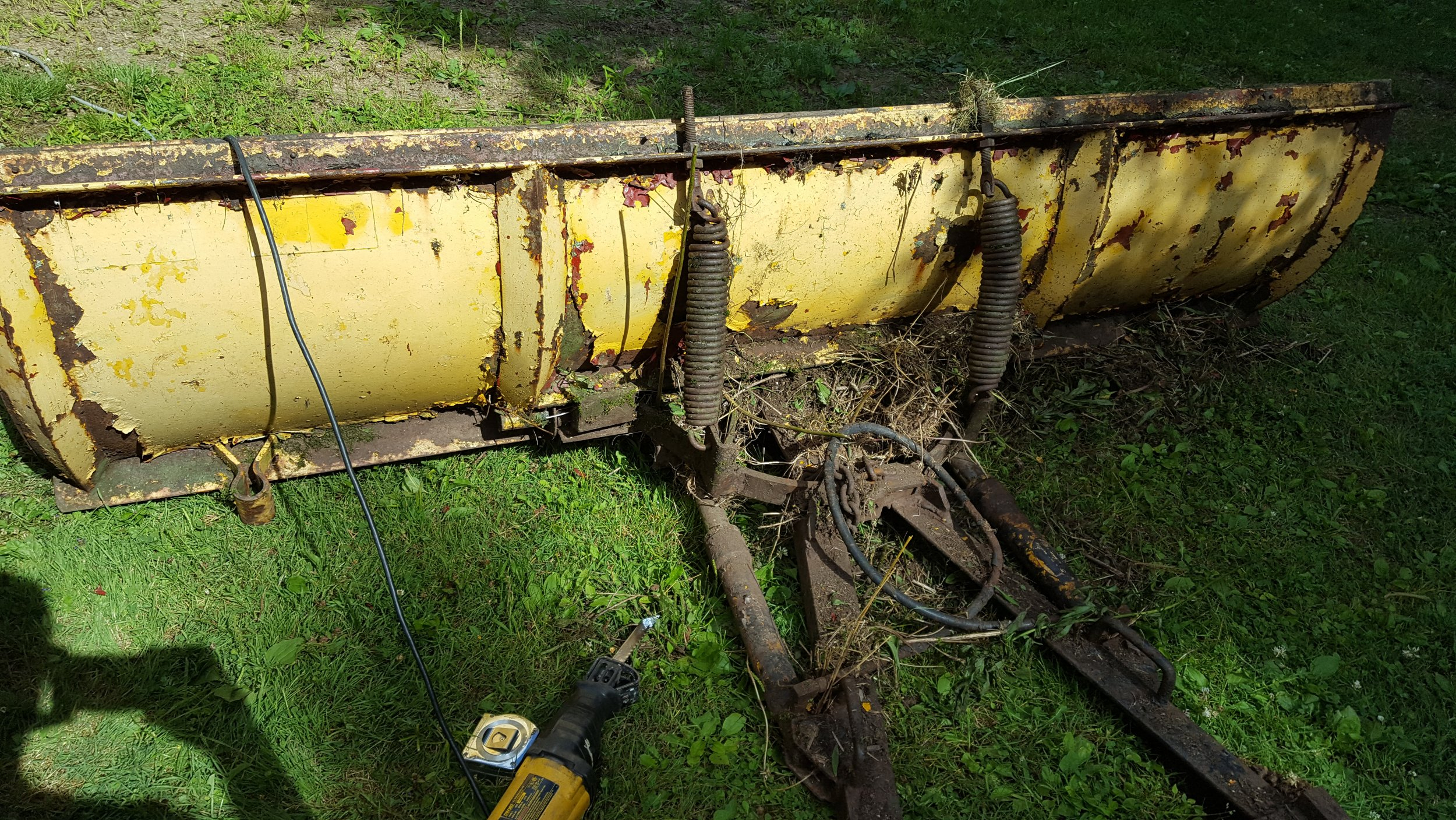

I was very disappointed with the stock deere 54" snowplow. So I set out to adapt a Meyer's 8ft plow. The plow was old and pretty rough. Challenge accepted.

I cut it down to 72", removed the the old mounting hardware.

The blade had alot of rot/rust so I removed the mold board and cut it down to 20 inches tall.
/ Deere 2520 snowplow
Problems already. By shortening the blade, I had to remove the skid shoes. And the trip springs are going to be too long

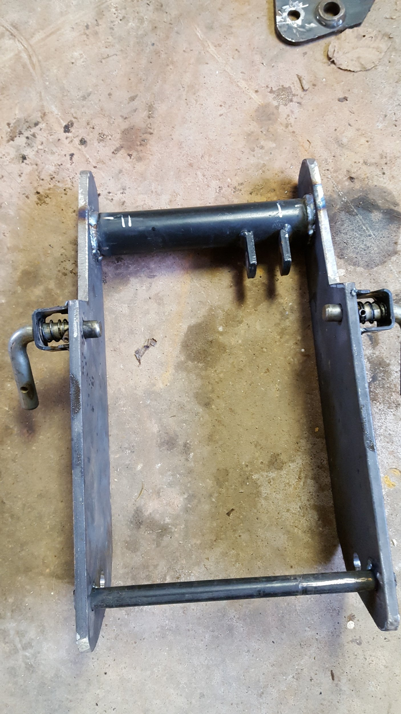

Time to mock up the new mount. I made two curved "ribs" that are welded to the plow the width of the quik tach. This is the 1st attempt to mount the springs. And test it out.
The springs trip way to easy, and the factory yoke/mount was so light it bend and twisted. Cut some 1/4" plate and make it stronger.
