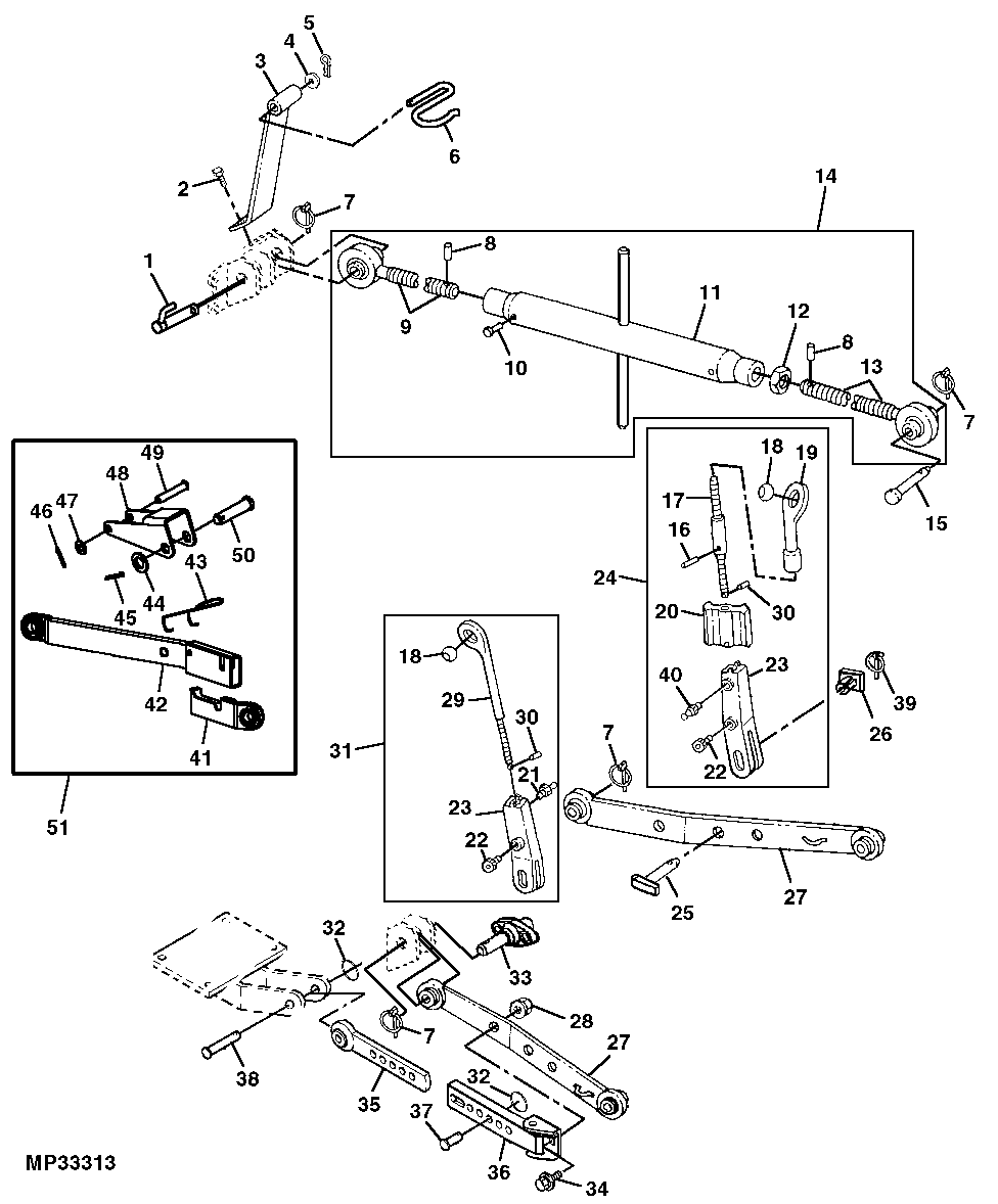

Measuring from pin to pin the lower arms are 29 3/4" long. The telescopic links I am referring to are the ends of these lower hitch arms, they can be unlatched and pulled out a few inches to make hook up to implements easier. Once hooked up you back up the tractor to lock the ends back in the fixed position.
Trying to hookup a heavy Gannon box blade with clevis pin set up is much easier when you can move the link ends around. The telescopic link option for a 4x20 Deere was about a $330 option, for that you get the new set of lift arms in a long flat carton. You simply swap these out with the standard lower arms shipped with the tractor.
Point is the lower arms from a 110 or 4x20 series should work the same. Brian sent me a message this afternoon about this and the sway bars are slightly different as the new design uses the round bar vs the older flat style bars. Both of my tractors are on a job right now but I will look at the sway bar set up to see if there is any differences that would be an issue.
   / Deere 110TLB 3 point hitch #32
I've looked at Brian's website and am planning on using his T&T implements, however a little confused about what you're saying "telescopic links". I don't have a good grasp on the correct terminology of all the parts of the 3pt hitch parts.
Parts key #27 is regular non telescoping draft link. Parts key #51 is telescoping draft link simply move latch(#48) to unlock then slide link(#41) out to aid in attaching implement.

Hey guys, thanks for the help. Unfortunately I'm still having a hard time finding the right part numbers. Here's what I've found for that looks like a telescoping link. I can't seem to find the page that Tx Jim posted. Maybe I'm searching under the wrong model number, not sure...
