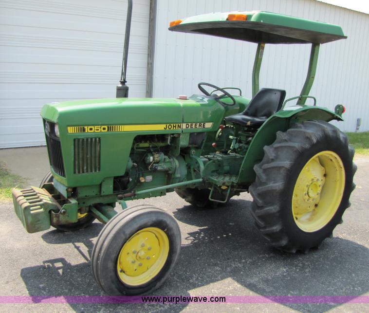

somewhat recently i purchased a deere 1050 with a bit over 2000 hrs on it, motor was rebuilt by a well regarded mechanic around here, she runs great but has a few maintenance items i have to replace like the brakes, clutch in a couple years, and the front axles bearings.
my concern and questions surround that front axle i have done all the digging i can but theres simply nothing and no one with first hand knowledge. the stub shafts after you take the front wheels off have roughly 1/8" of play overall which i take as wheel bearing need replacing, but the "knuckle seal joint" area has about a 1/16" of play from side to side is this play within spec? should include the previous owner replaced the seal there, but its clear he did his best but doesnt have much experience. i may be wrong but i think there could be a missing wear sleeve or collar, is there one on an 88' model?
and better off safe that sorry i do intent of replacing the "wheel bearings" and new seals in those front lower gear cases. Is there supposed to be play between the stub shafts and the surrounding lower gear case? or is it similar to my sierra as a good and new set of bearings are rock solid tight?
i know this is 99 questions, but to help with very small engine oil weeps can i add a quality stop leak like lucas? and a piston on the backhoe boom is weeping and a quick connect, can i add the blue devil hydraulic oil stop leak and be safe?

The 1050 and the 336 are not identical but they do share most of the same front axle parts and a few other parts. The front axle should not have nearly that much (if any) play. All of those gears need to mesh correctly and consistently and that is not possible with that much movement. There is a good writeup on replacing those seals below which also shows the gears & bearings

I, personally, haven't ever used that sealant but I know a lot of people have had good luck with similar stuff if the leaks are caused by dry seals. It probably won't fix the leak at the quick connect but some new orings or some teflon thread sealant (depending on where it is leaking) should.

i looked at the spindle you guys sell, i read your notes at the bottom about the front loader basically destroying the early ones so yanmar upgraded them twice. assuming mine being an 88' mine would be the upgraded-upgrade one? still not massive overkill as the rest of the tractor is, yet just good enough to be good?
/ deere 1050/ yanmar 336d same exact tractor? common issues? #12
I'm happy to help in any way I can. I'm not sure what version you would have but you should be fine as long as you take it easy with the loader work. Just keep it in the back of your mind that those front axles are not indestructible and bouncing around with a full bucket can cause problems.

I have a Yanmar 336D tractor, similar to the JD 950. "Similar" to the 1050 but no turbo charger. The front axles on mine broke. I replaced them with the heaviest Yanmar later edition units. I have had no problems since but I do not know if such units are available any more. I got mine perhaps 10 years ago.

Our axles are really only for the smaller 2wd models (YM1500, 1700, 2000). I don't think you would see any advantage on the bigger models like the 336.
Yanmar did 3 upgrades to that 4wd spindle over the years. If I remember right the last upgrade was sold as a heavy duty kit that included a new spindle, gear, and cover plate.

My parts manual for a JD 850/950/1050 shows the frames and axles and stuff to be swapable. Just that the engine for the 850 is a 3T80 and the 950/1050 is the 3T90 engine. The 1050 gets the turbo.
The JD1050 in the Yanmar is the rare YM4300. There are several here in the USA and Canada, but much more popular in Australia.
If you know how to poke around the John Deere service parts site, you can find all of the explode view part drawings with part numbers.
