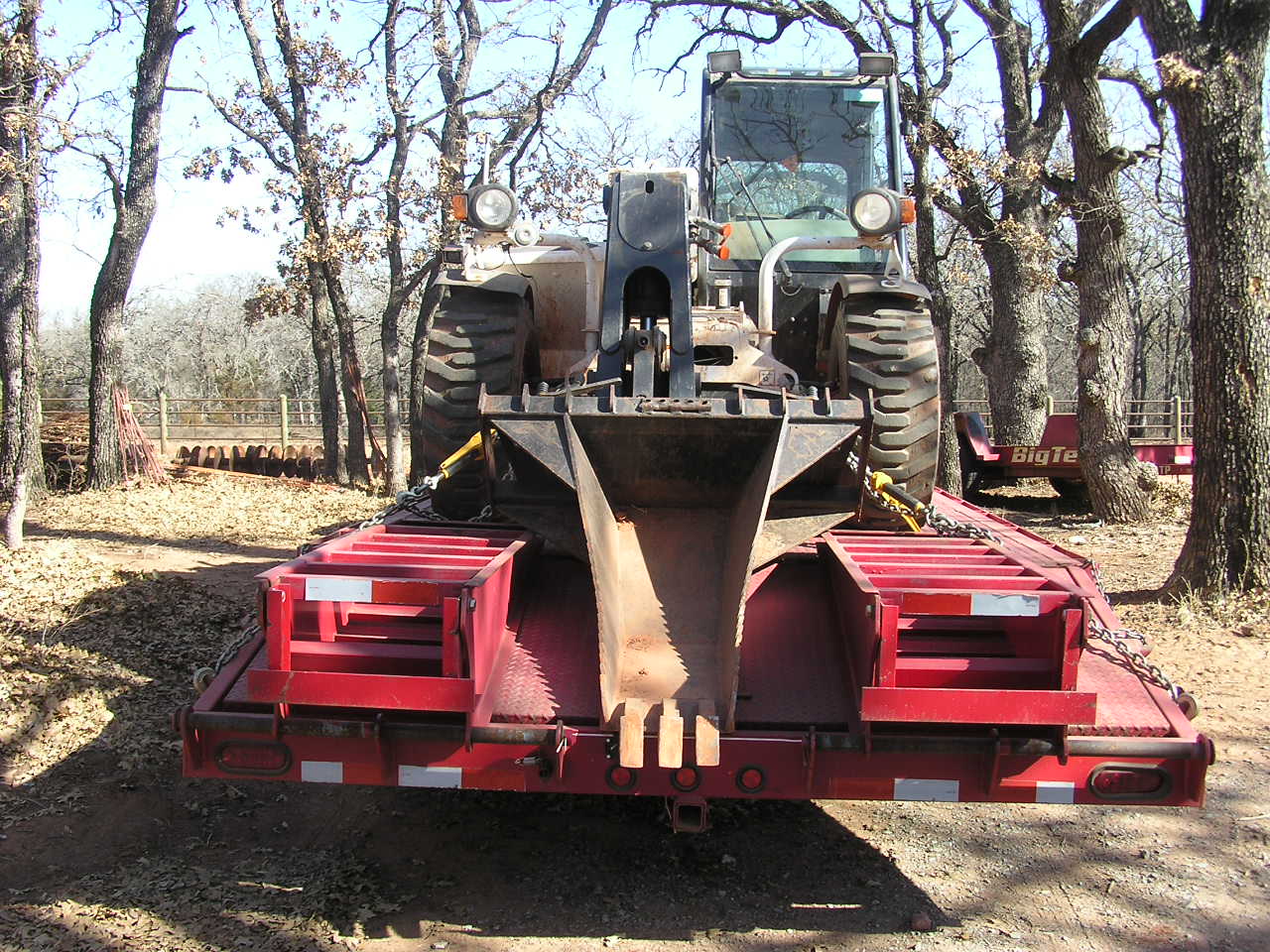

I tow a 20' (16'+4' dove) 10k lbs deckover regularly with my '99 f250. I haul trucks, tractors, logs, hay, junk, you name it I haul it... if you're gonna haul a tractor with loader and brush hog get 20'.
That's a 32" x 16' red oak on the trailer in the picture...

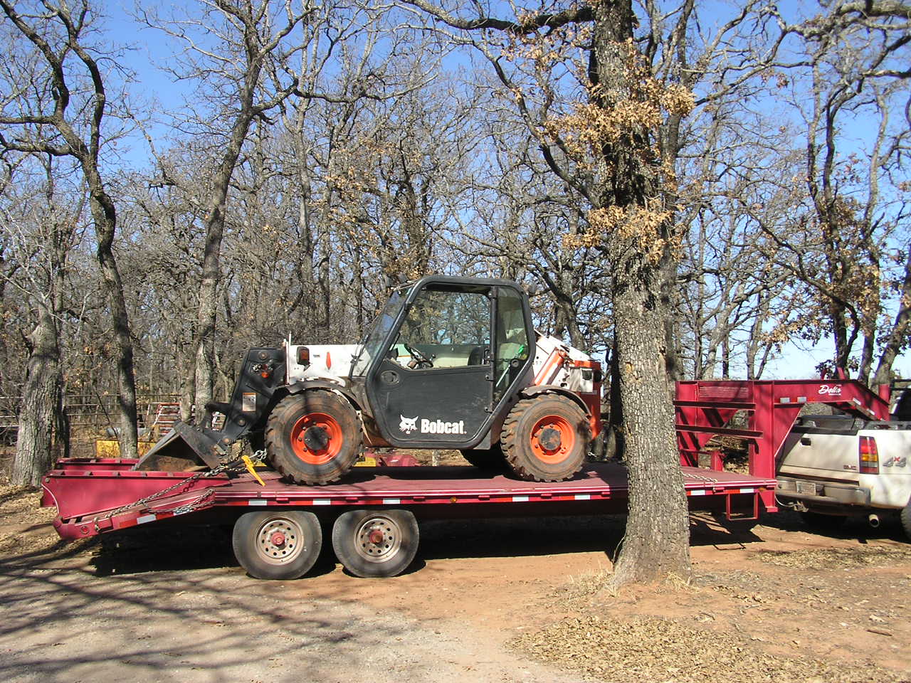

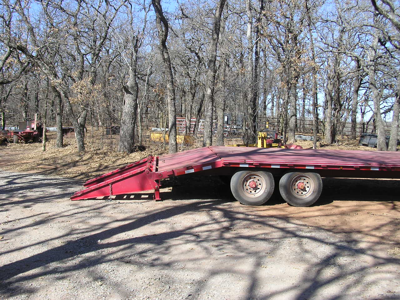

/ Deckover Trailer opinions and options #8

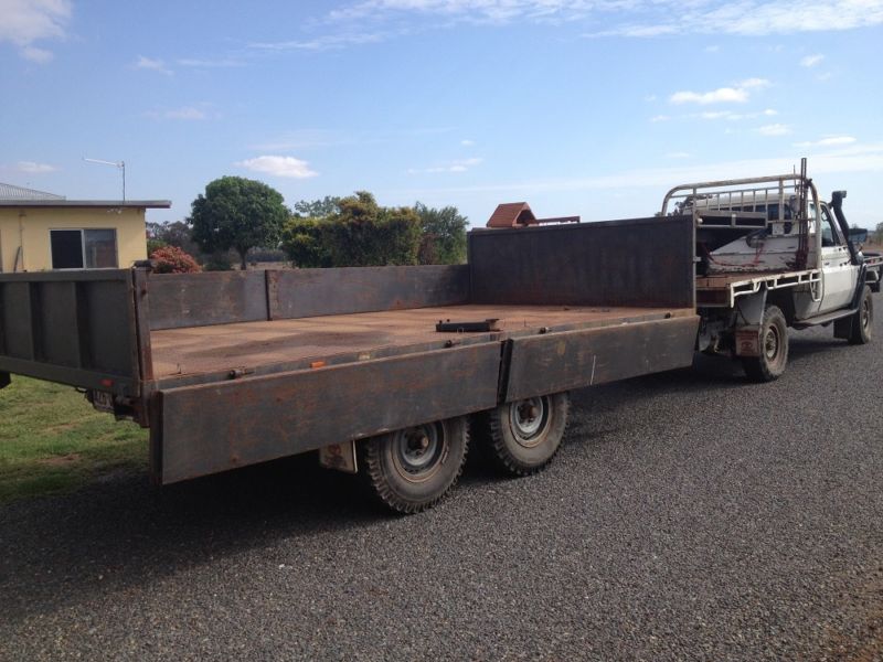

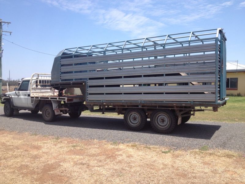

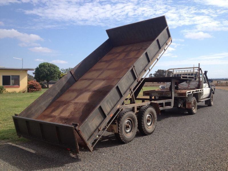

I'd second that - we run both ball hitch & much prefer goosenecks which invariably work out a far superior set up for ease of use (including control, stability, hitching & less strain on the tow vehicle) - as for ramps unless it's low loader dedicated to moving our larger earthmoving equipment we avoid dovetails & fixed ramps (primarily because of loss of usable deck space & the compromise of carrying around consistently the additional "non-productive"weight )
Below is our most versatile gooseneck which we made up c.10years or more ago & still going strong - c.10,000lb, 14'9" tipping lower deck with drop sides/8'2" fixed upper deck (over gooseneck) complete with a removable stock crate:

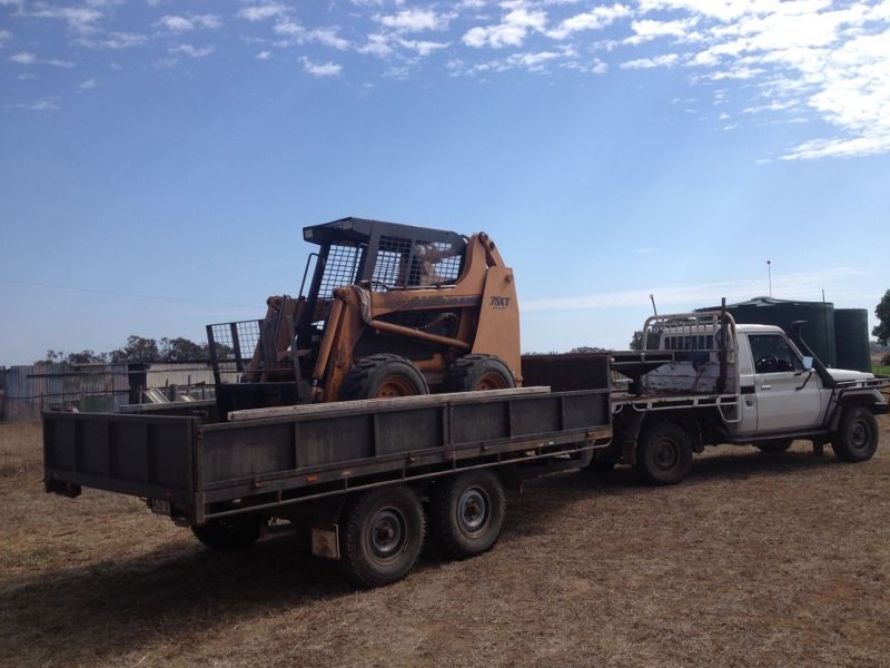

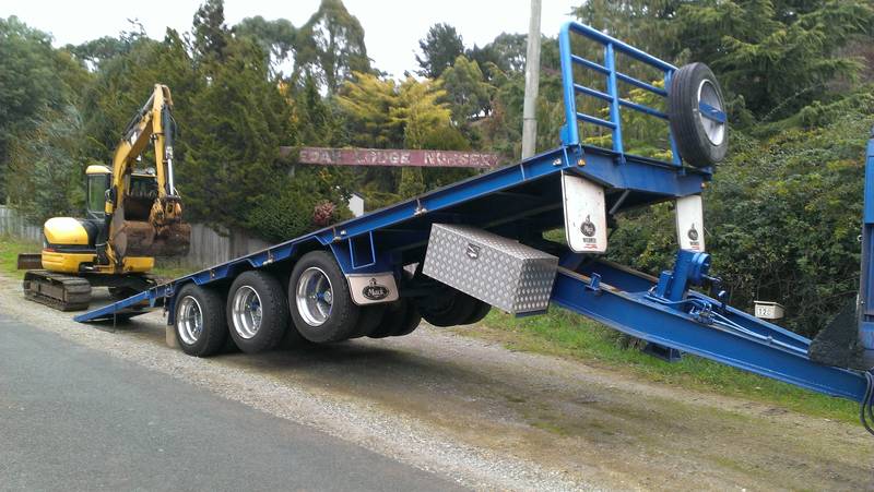

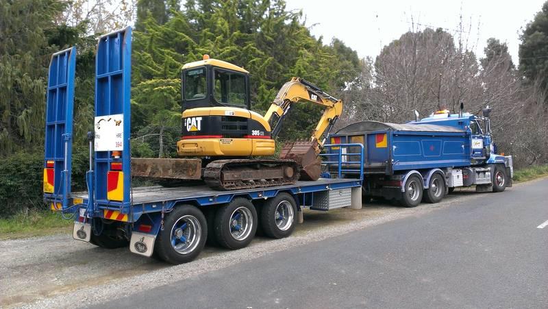

Following on from my post#9 & acknowledging the photo's below of one of our specialised trailers is far larger than probably what the originator of this thread had on mind, conceptually we are also considering building something similar in a smaller c.5T scale dual axle single wheel set up to move our skid steers around - IMO for fast ease of (relatively) safe/stable loading it's hard to beat (by lowering the ramp approach angle, minimising the ramp length & for track machines eliminating the ramp over tilt/balance - this set up lessens/eliminates the highest risk areas of the loading cycle being the source of most accidents/injury when relocating machinery )->
