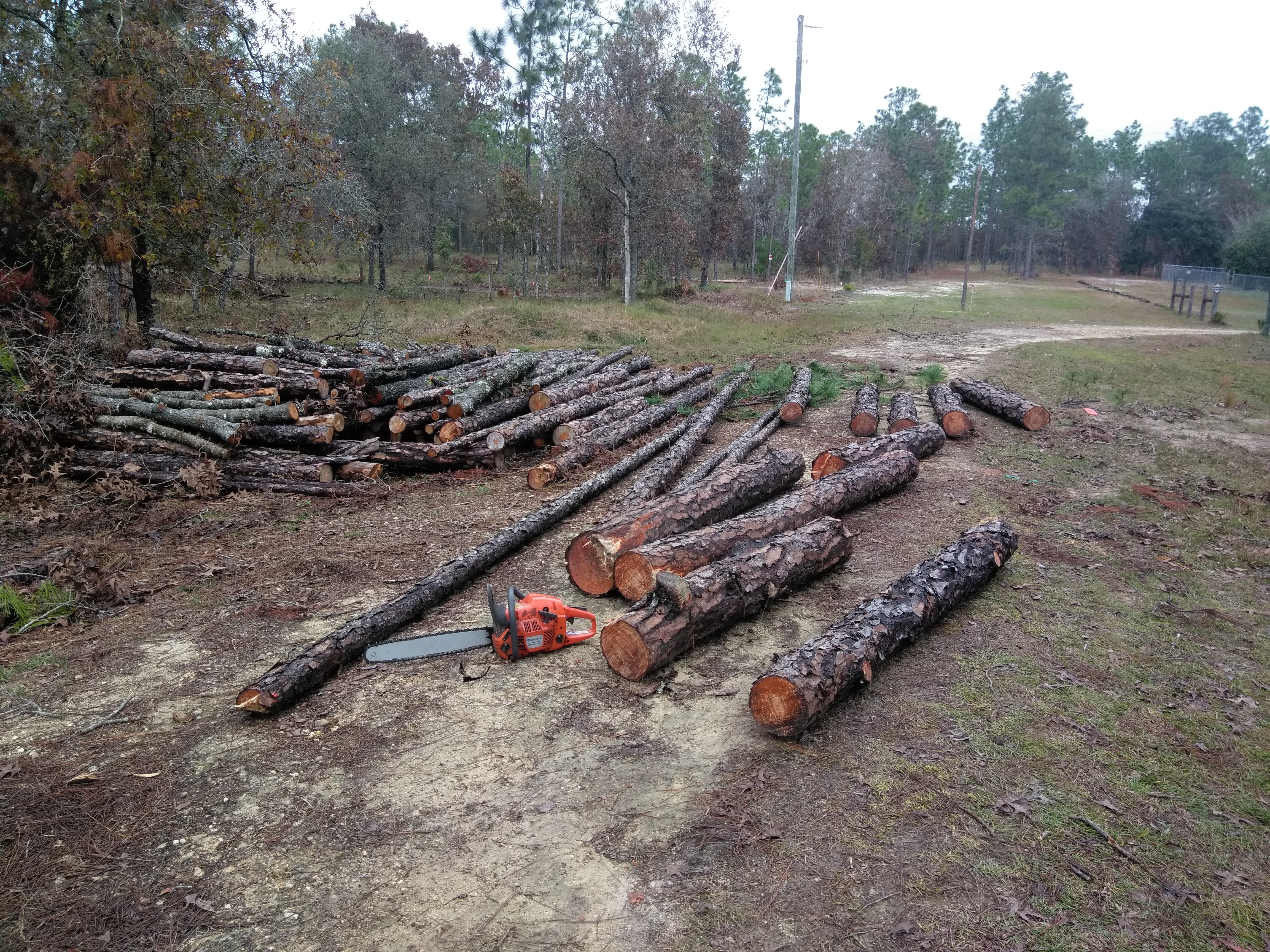

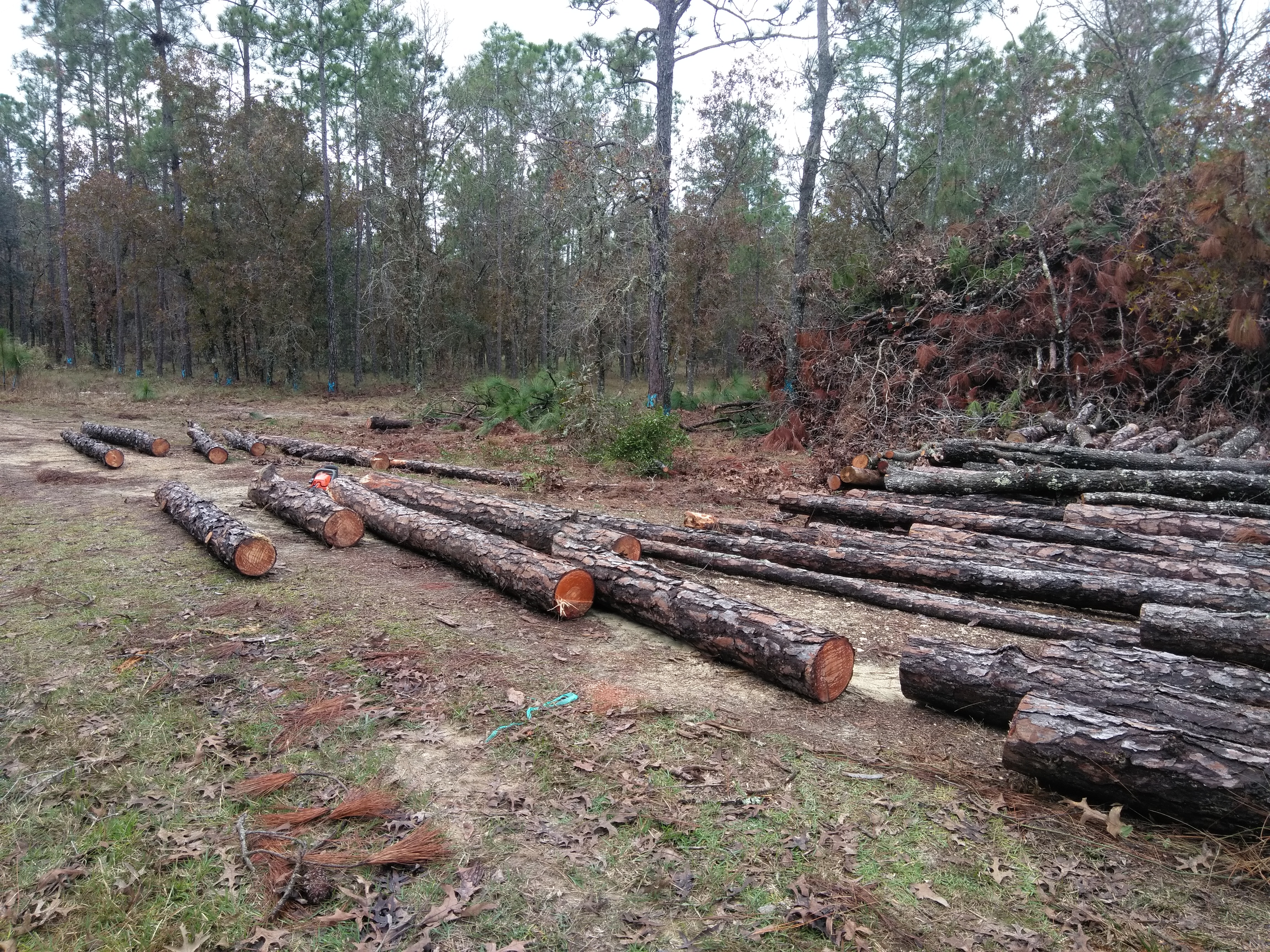

I tried giving it away but no takers, prob double that now, all pulled out with my little B series Kunota

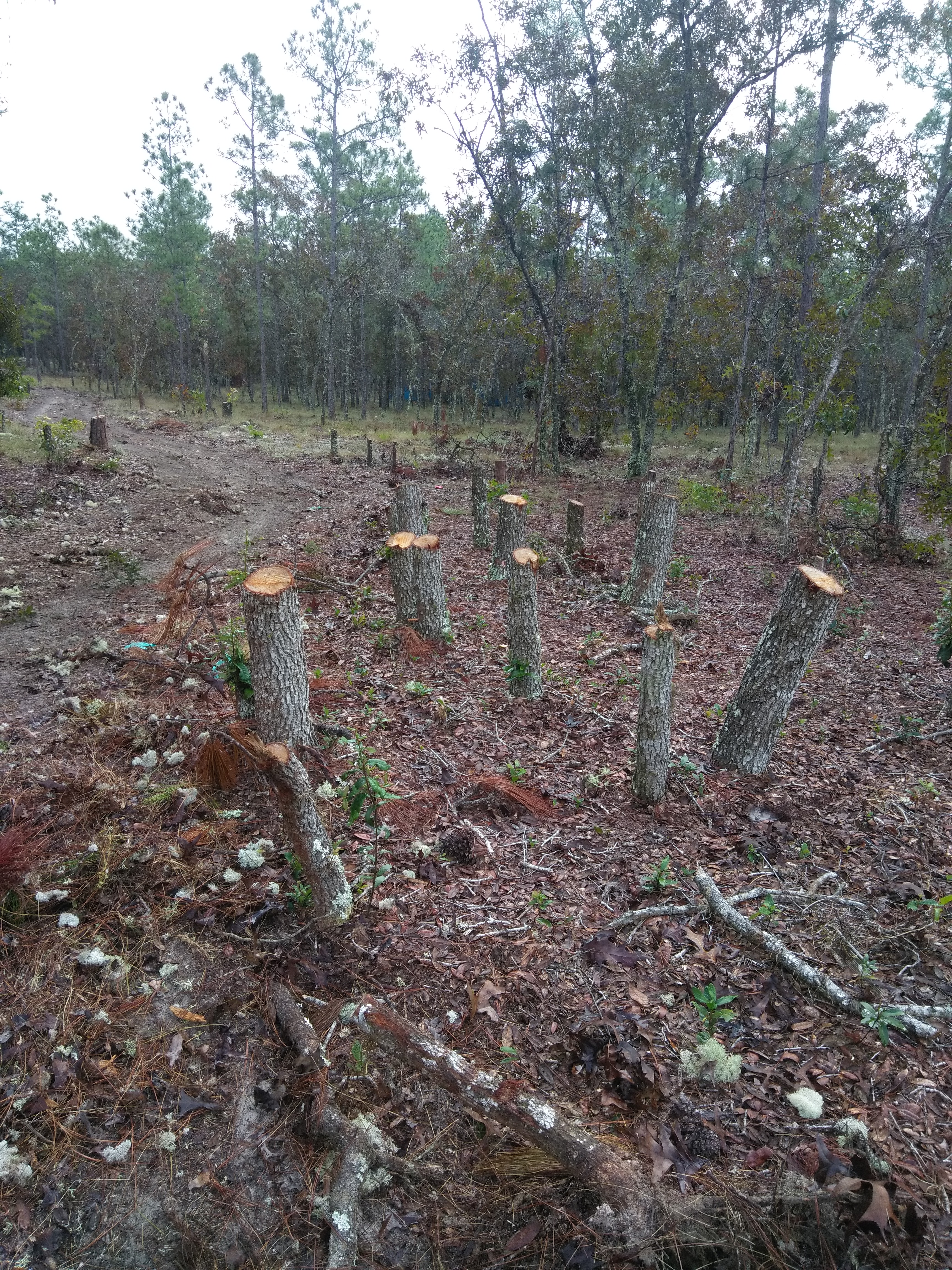

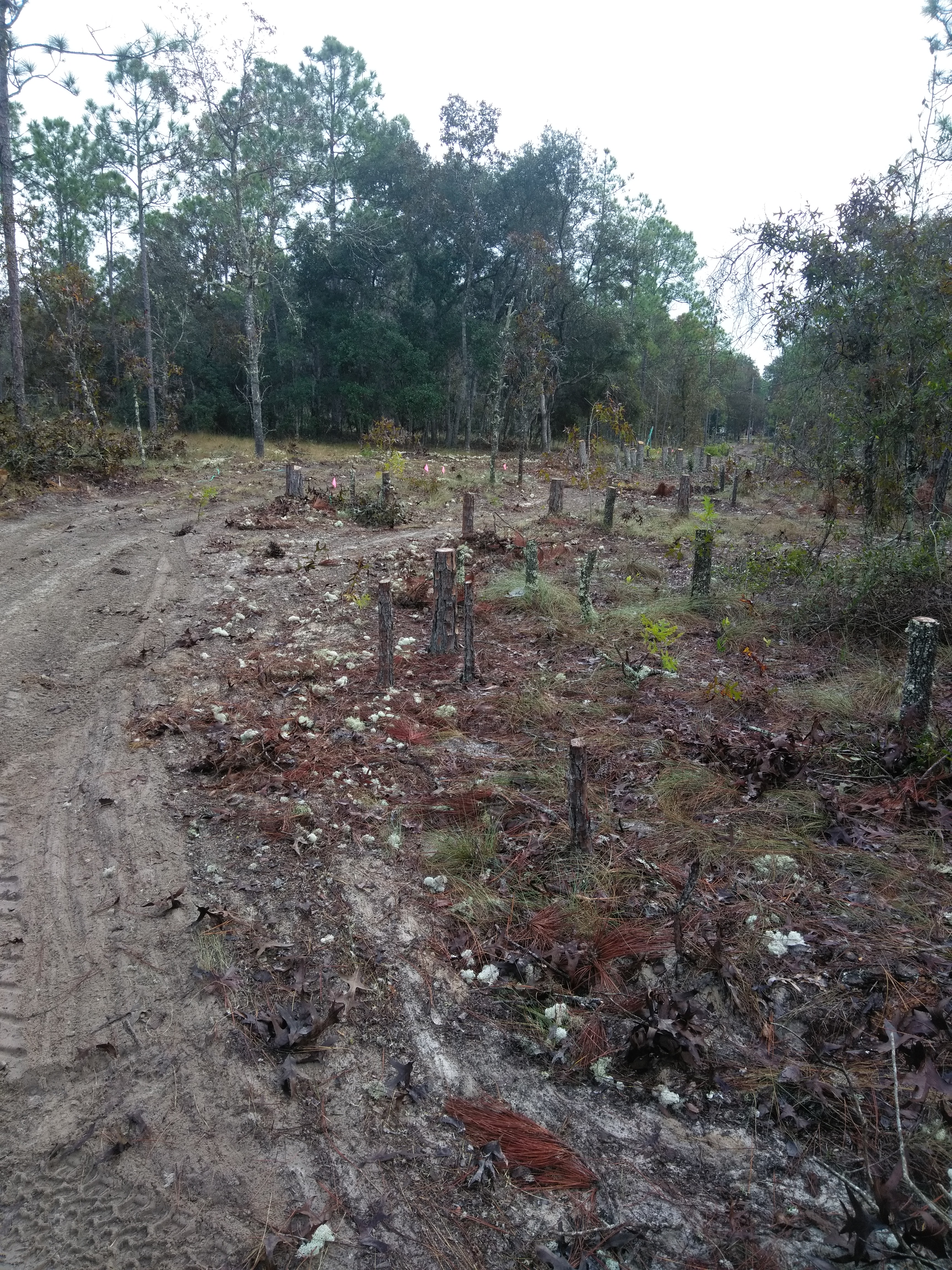

I have lots of oak as well but Im trying to save what I can of them

Wish I were closer, I'd come get most of it..

Nice pics stumpy.. its ok to call you stumpy right??:laughing::laughing:
