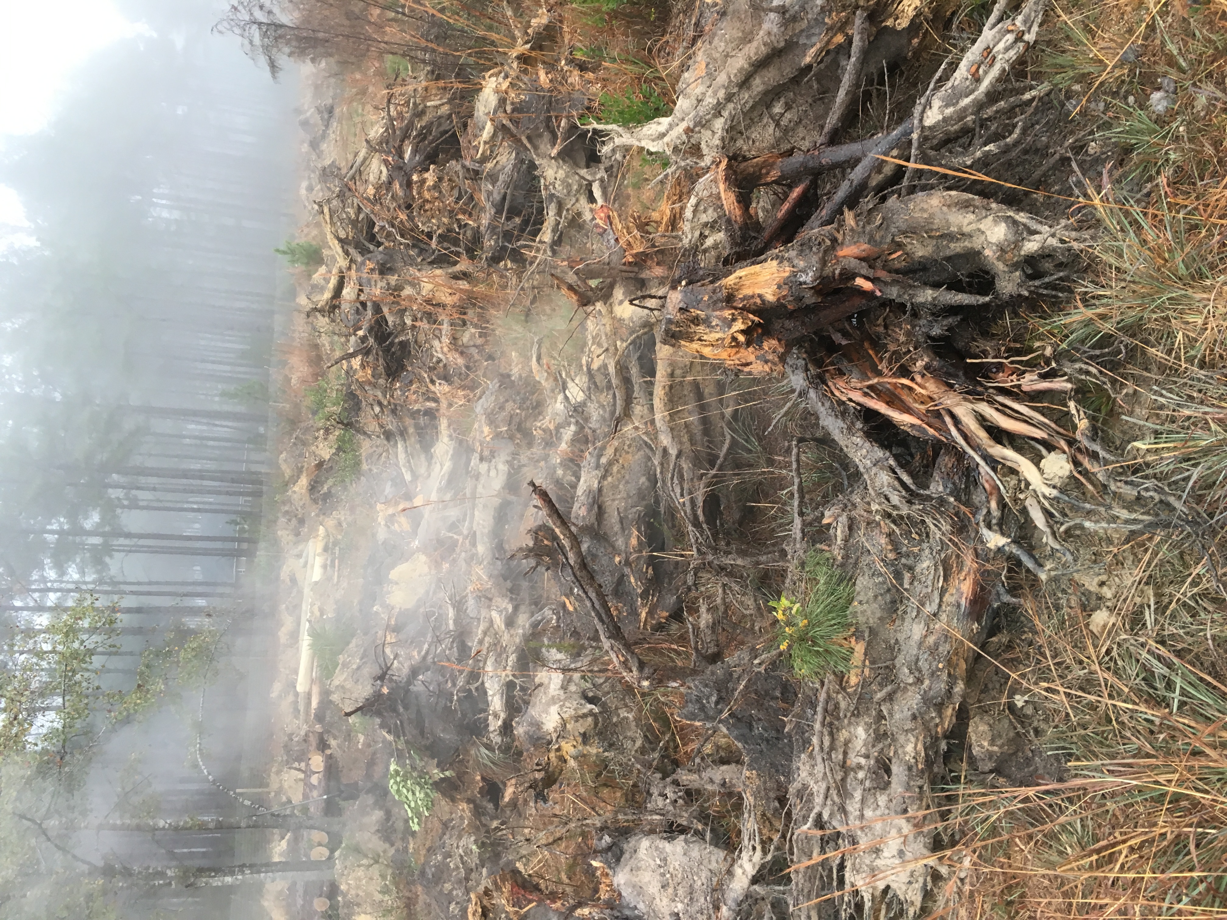

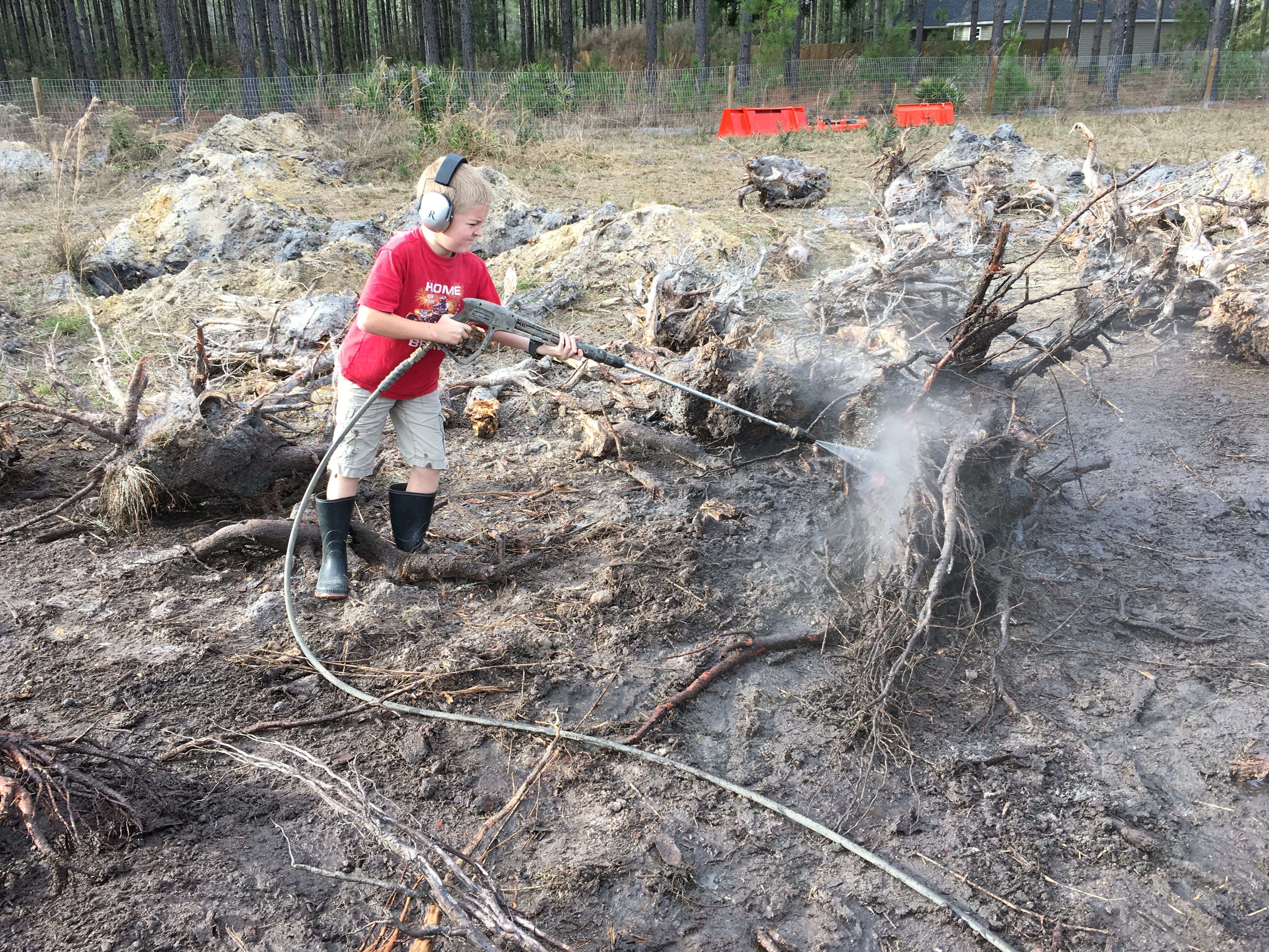

For me to get rid of a larger stump I just build a wood fire on top of the stump and when it's all embers hit it with the leaf blower. That gets it below grade and I can mow over it. You can also drill some holes in it to help the fire but evergreen stumps, when cut close to the ground, go quickly. Digging with a backhoe is tedious and leaves a hole that settles in and makes mowing difficult because the hole is hard to repair. I've done threads here on burning hardwood stumps and drilling some holes to help the fire.

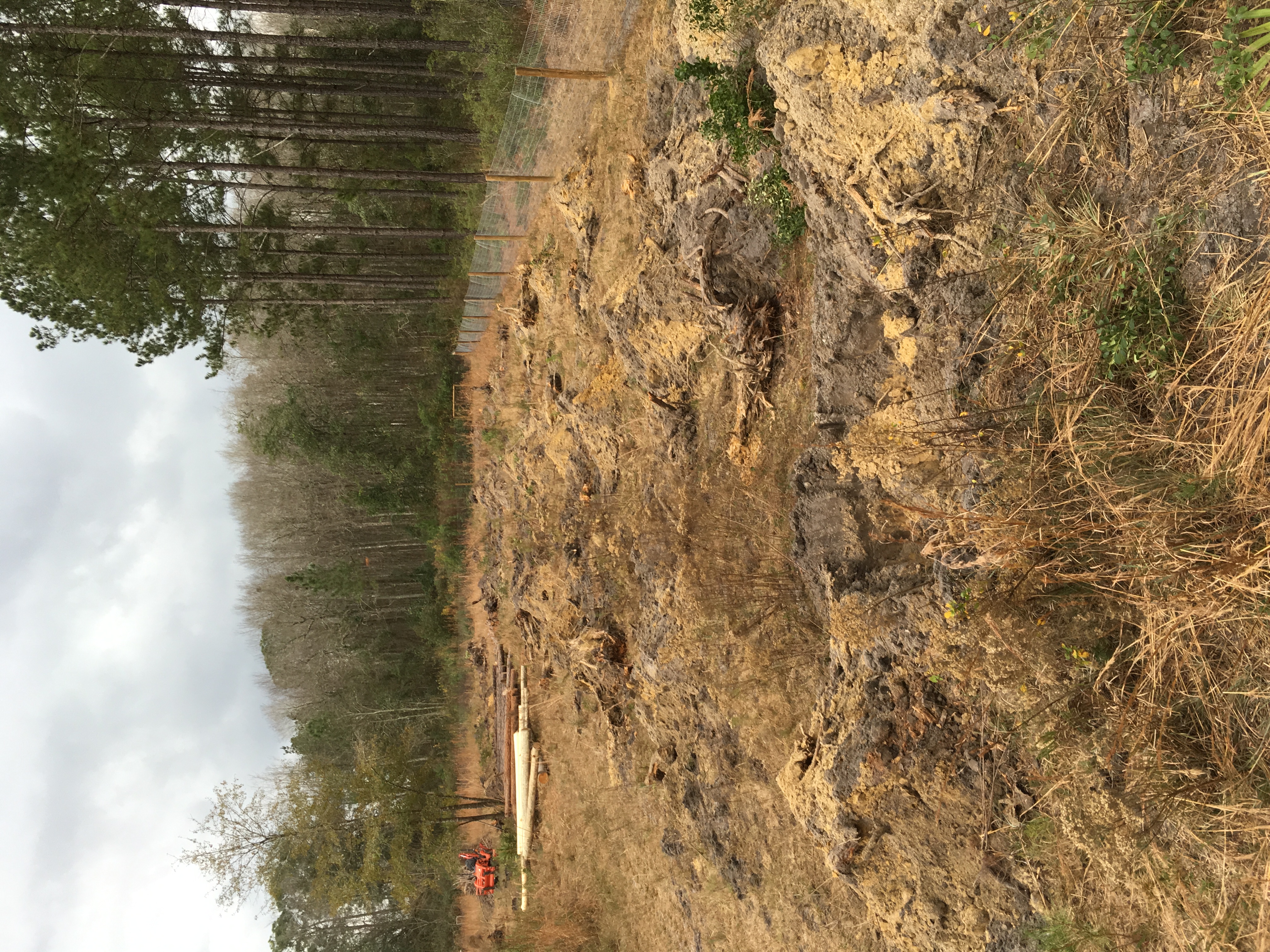

I will post a pict. for u tonight, no time now have to get to shop. Once I post this picture you will understand what I am up against.

My question is , what are you doing with that land after getting rid of the trees? if its been raining and that sand is wet you can push over up to 3 maybe 4 inchers. If you have no quick use for that land those pine stumps rot away pretty quick, leave em a couple feet high and push em over in about a year or three..

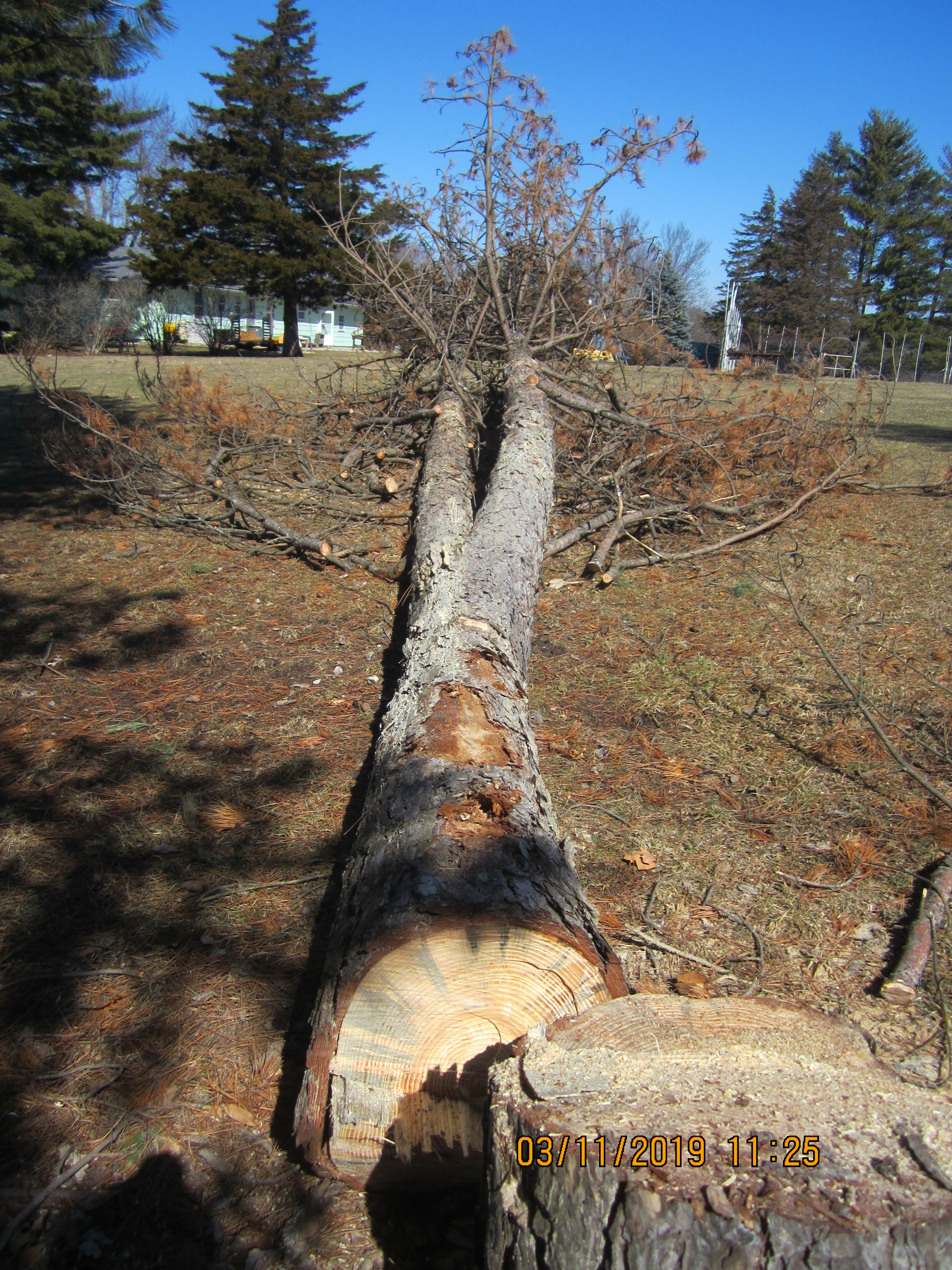

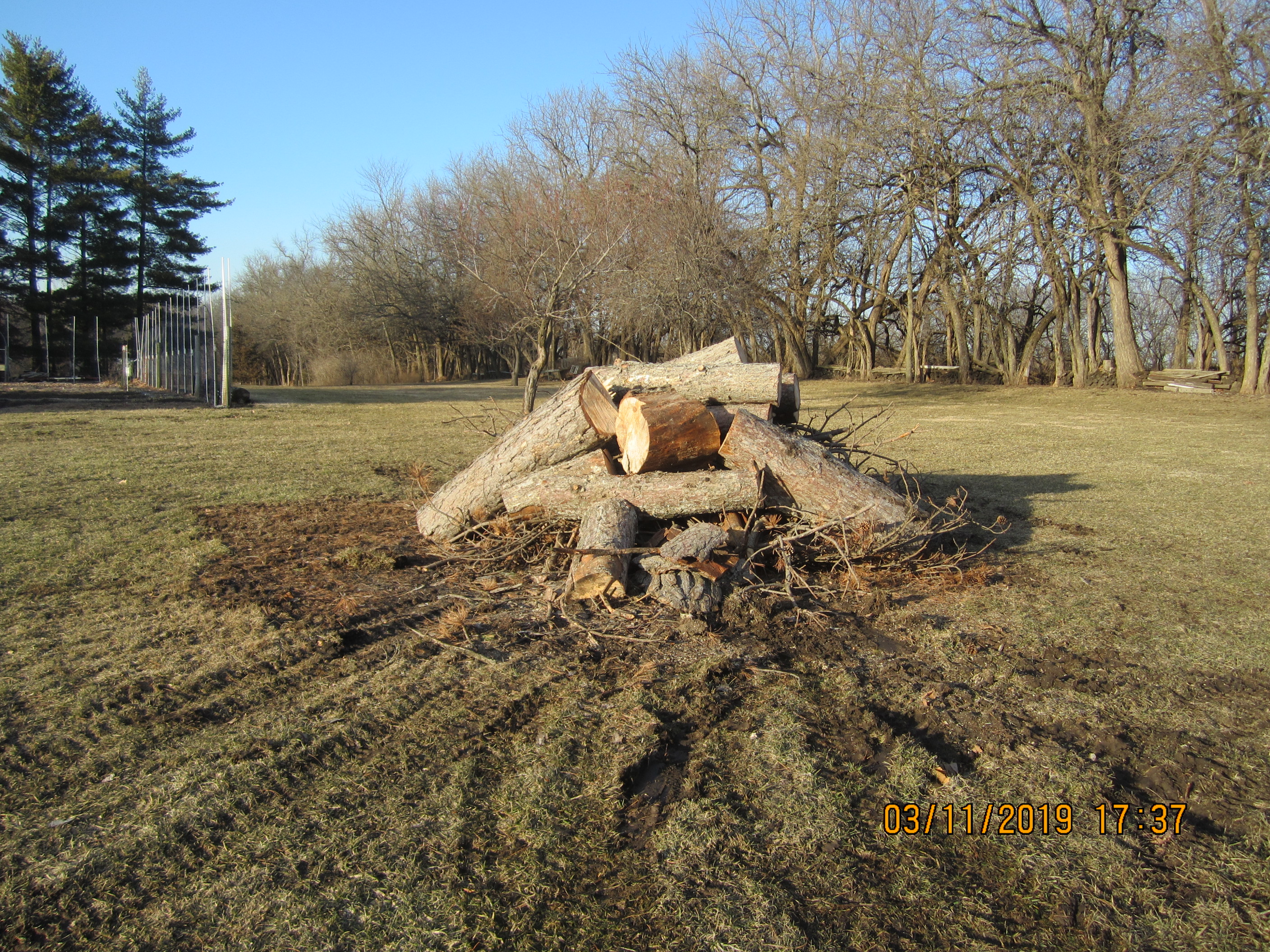

I don't recall that it was a pine tree but my wife's cousin next door had a tree he wanted dropped.
I dug on three sides of it, leaving the 4th side as sort of a 'hinge' to help prevent it falling back towards the house.
Otherwise, I simply dug on three sides, huffed, puffed and pushed it over.
Yeah, it was a bit nerve racking since "things happen" but it all went according to plan.
Since whole tree fell, it popped the root ball up.
Nice thing is, once I was done, I was done. HE was the one that cut the tree up & got rid of it. I got to MAKE the mess while he cleaned it. Doesn't get much better than that!
Much different!
THAT is not a pine tree.

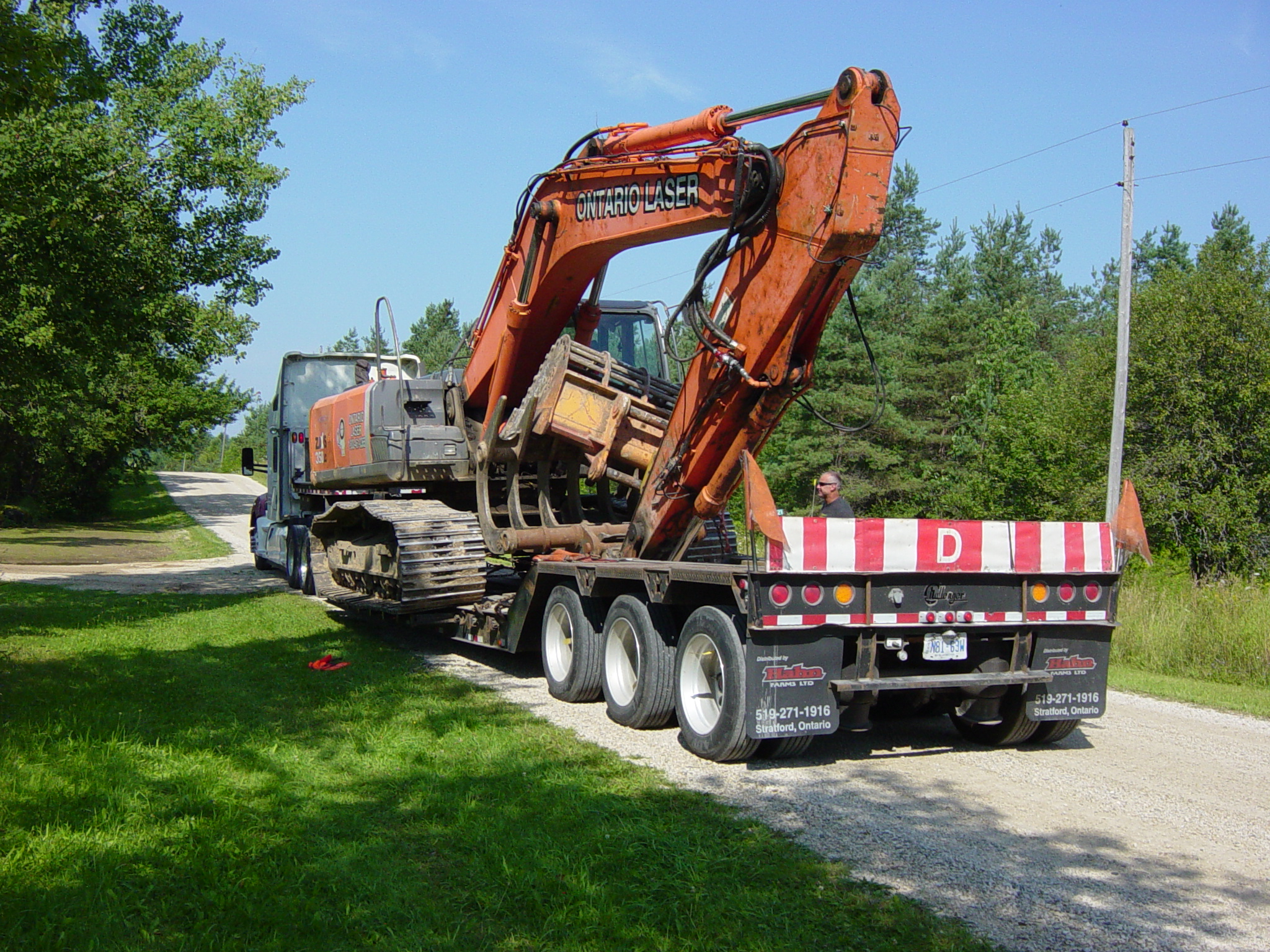

I just find them too slow and expensive to deal with pine stumps. And the hole and ripped out roots are a terrible mess. But, he had to work around trees that were remaining. So I thought a dozer would be better. Never had a hoe take out all pines, but I can't see it being any more efficient. A hoe isn't great for levelling large areas.
For the work done, I think you just can't beat hiring BIG IRON. Then do the finish work yourself.
