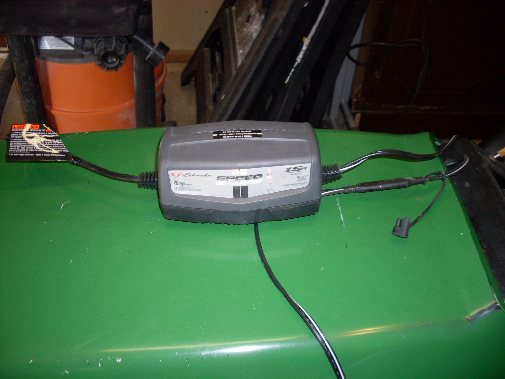

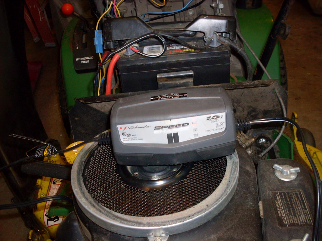

Now that everyone has corrected me on my previous post (and I do appreciate it...lessons learned), I wanted to update you on the trickle charger system. Its working flawlessly and no more dead battery issues. I've attached a picture of the unit and the quick-connect.
Since I keep this tractor in the garage, its always plugged in, however I do have a solar charger that I can use outdoors when I keep it out for a few days.
