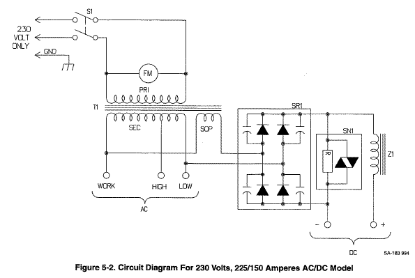

I pulled that out of a Miller ad. However I have wondered why the same welder puts out 225 amps AC but only 150 amps DC. I am sure the answer is simple and obvious but for some reason I have never run across an explanation.
I believe the answer is that question is the AC is being rectifier by a half-wave rectifier. If it were a full wave rectifier, it would be 225. The full explanation can be found in a basic electronics, or electricians book.
I thought that too but that begs the question why not use the full wave rectifier? Cost perhaps? Wouldn't it be nice to have 225 amps DC at your disposal for the price, that is if the cost of the full wave rectifier is not prohibitive.

Sorry JJ but I don't think so. Borrow an O'scope and look at the wave form or open the case and measure the RMS voltage (AC) on the secondary of the transformer (or autoformer depending on the design) and then with a true RMS meter measure the DC output. I think you will find you are in error.
Casey1, Most welding forum stuff revolves around what happens outside the box (including the setting knobs) rather than inside the box. The two are totally different knowledge bases.

I got curious, so I went and grabbed the schematic from Miller's site(see attachment). Unless I'm reading it wrong, they do use a full wave rectifier. I don't have a definitive answer on why the DC amp rating is so much lower than the AC amp rating, though.
Nothing wrong with your analysis, that is a full wave bridge circuit where the full voltage of the transformer secondary is expressed at the diodes rather than a two diode circuit with a center tapped secondary.

I agree.. and it looks like the current is based on what tap they are using to feed the diode bridge.... etc..
Soundguy
