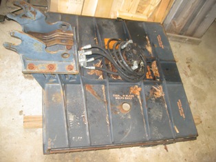

Have you ever had anyone put one of these on something like a Case 580 or Deere 410 backhoe?
I've thought about putting one on my FEL of my 410B.
/ Davco vs Diamond Mower #36
At one time I had a cutter that would have worked on the rear of your backhoe. Sold it a few years back though.

That would be pretty slick!

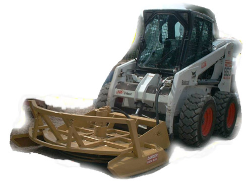

Right away I notice a few differences between the two though the Diamond appears, at first glance, to be a reproduction of the Davco. I'm not saying it is, I'm saying that their are some remarkable similarities in design.
What stands out as different, at least from the Davco I owned several years back, is that the Diamond is a three blade system whereas the Davco had a very large disc with 4 blades attached with a puck system. I believe the Davco blades were reversible.
The Davco's push bar was not on chains and it had a flimsy hinge system that didn't last long.
My Davco high flow mower didn't have a case drain on the high flow model. Once it spooled up, between inertia and the direct drive hydraulics, it took awhile to slow down after I cut off the hydraulics.
The Davco didn't have replaceable skids but the overall lines of the cutter could make me mistake the Diamond for a Davco and vice-versa.
The Davco was rated for only 4" but it had a 300 lb disc to provide the inertia for cutting heavy brush. The Diamond is rated at 10"? I would have to question the safety/wisdom of that. I've seen a Brown Tree Cutter come apart on large material.. sending half a blade flying over 150'.
I know I used my Davco in a manner not advised by the manufacturer (lifting up and letting it "chop" the tree down but I had to see what it could do.
I just hope whoever uses the Diamond has Lexan and nobody within striking range for expelled debris. Other than the safety factor associated with rotaries (all brush mowers to be honest), the Diamond looks like a very cool tool and I'd own one just like I'd own a Davco again for certain jobs.
Davco2.jpg My Davco.
