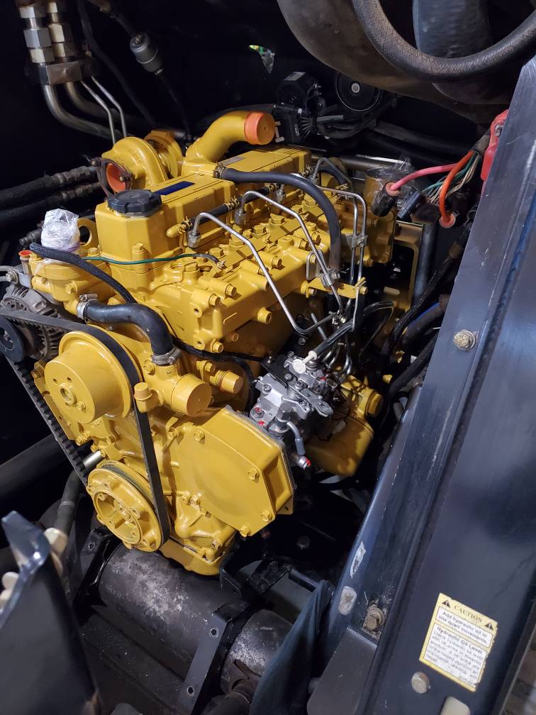

Prepare yourself for more work than imagined. It probably had a hydro lock.
   / Dangit... Accidentally caused myself a bunch of work (engine repair) #12
Thought i'd make my annual appearance, what have you found?
#13
Full rebuild... Spun bearings and damaged 2 rods with excessive heat.
New crank. 2 (of 4) new rods, new pistons, bearings & seals, bored .10 over but head and block were checked and were good. Rebuilt the fuel pump and injectors. New water pump. All new gaskets & seals. Probably more I can't remember now.
After the rebuild, she was losing coolant. Turned out the head gasket had a defect. Took the head back off and replaced with a factory CAT gasket (the first head gasket was 3rd party) and all is good.
Expensive adventure...
