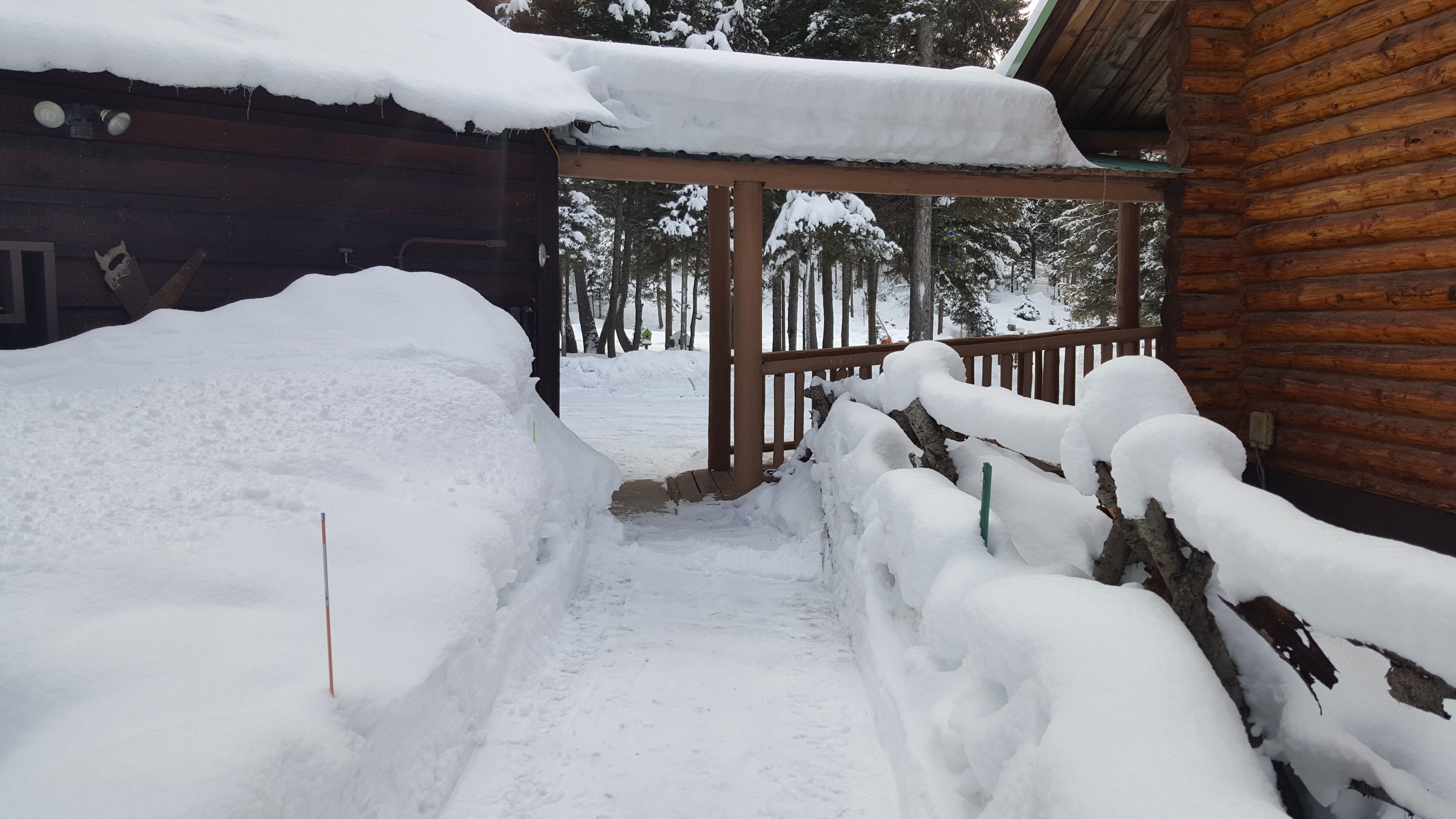

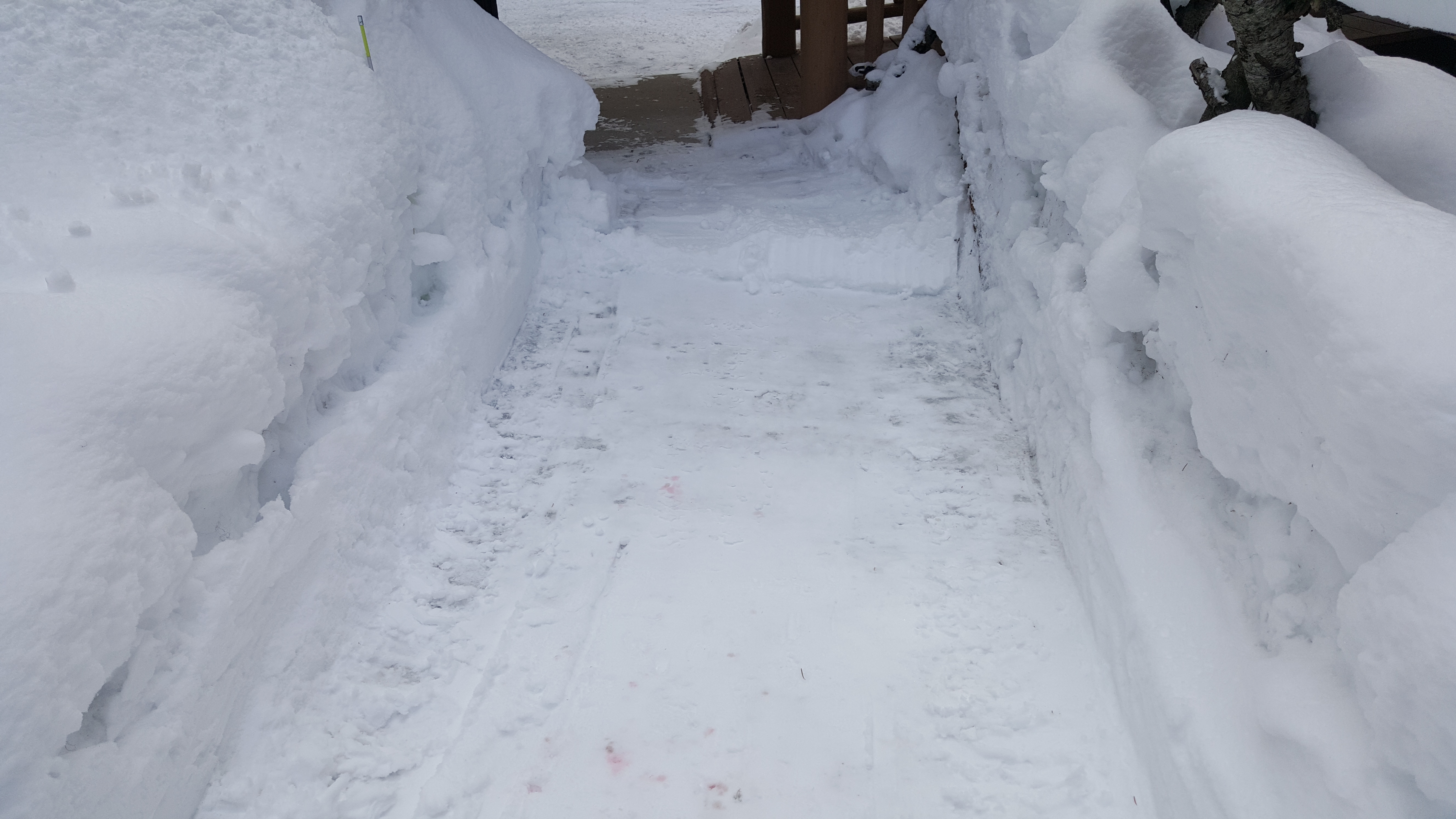

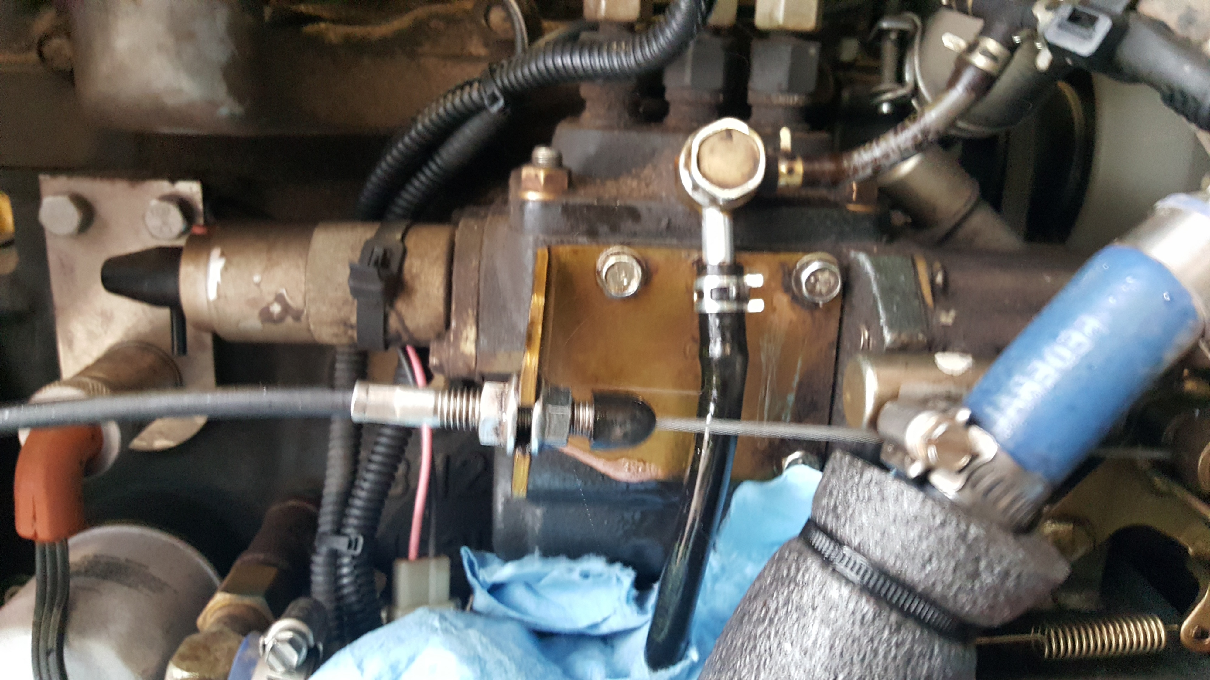

I know this Ghost Thread is about 3 years old, but I'm bringing it back to life, as I believe I have the exact same pin hole fuel leak as Pixguy had.
I was searching thru my repair manual thinking I would replace all of the rubber fuel lines since my tractor is over 10 years old with 660 hours, but it appears MF has lots of short/medium/long hoses...
I think I'll cut/shorten the hose (about 1.5") to remove the pin hole leak and reconnect the hose to the existing for right now to repair the fuel leak so I can finish snowblowing tomorrow.
I would appreciate others to comment about this issue and the repairs that you have made.

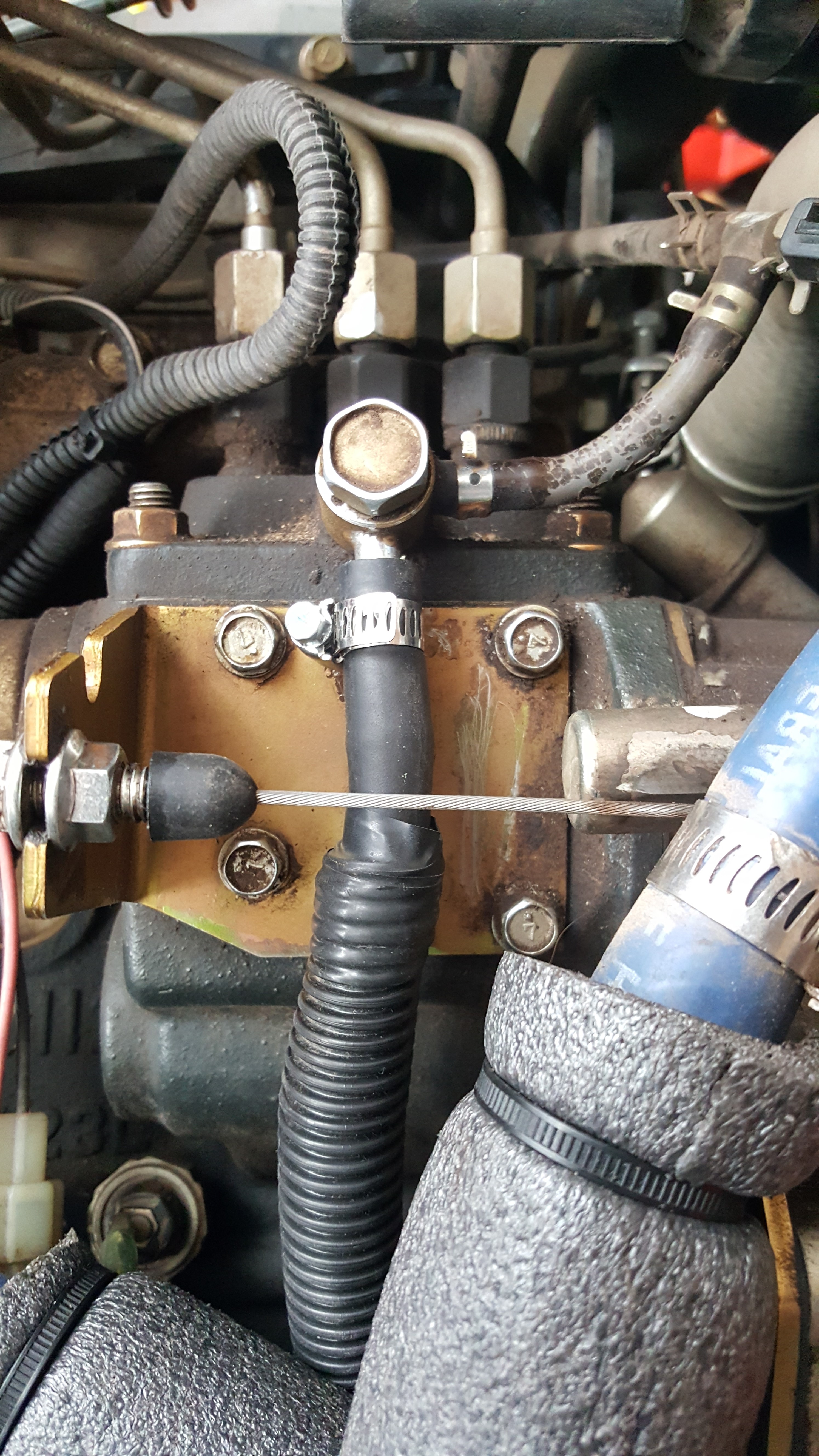

The first pic is where I noticed red dyed diesel drippings on the snow, maybe hard to see.
The second pic is similar to Pixguy's pic but shows a tiny stream coming out of the rubber fuel line just above the throttle cable and going to the left while the tractors running.
The third pic is a close up that might be easier to see the red dyed diesel drippings on the snow.
I also believe the pin hole leak is located where the split wire wrap material stops, and MF taped this area with electrical tape.
Thanks, KC

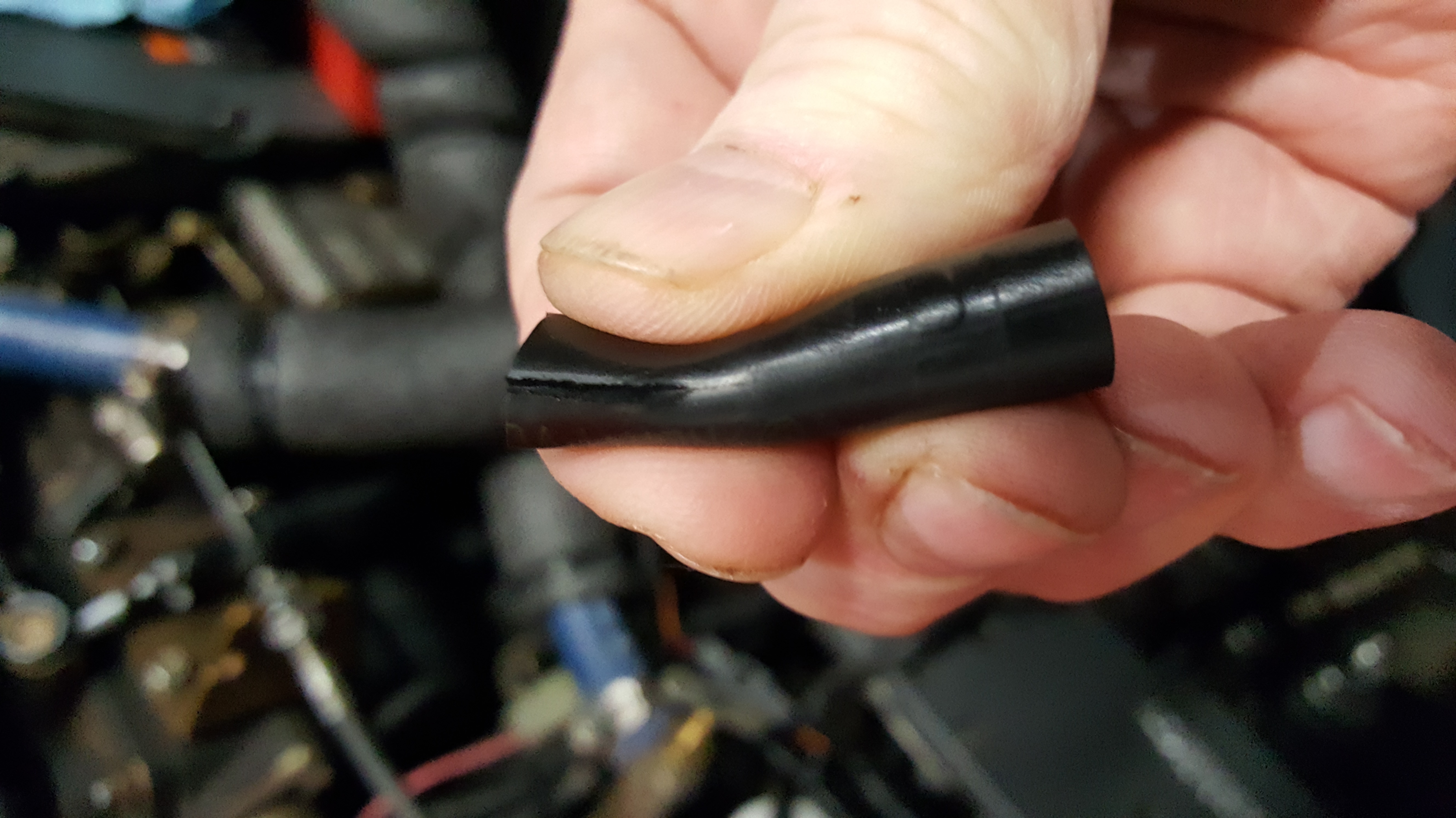

Today I cut about 1.5" off of the fuel line and reconnected it, size maybe metric but looks like 1/4" diameter will work.
The pin hole leak looks like it came from a crack along the hose (another crack is 180 degrees around to the other side).
First pic is of the identification markings along the fuel line.
Second and third pics are of the removed damaged piece of the fuel line, showing cracks (or cuts?) along the hose (the deepest crack is where the leak was).
KC

That seems to be a common failure point. I had a similar small leak on my GC2400 right where the fuel hose connects to the fitting and cut off about the same amount and reattached it. I'll have to keep an eye on it as it probably will happen again based on these reports.

It appears from my MF Parts Book that there are 2 rubber hose fuel lines going to the engine.
It seems the one I have a problem with is MF # 4264890M91:
07mm (0.275") I.D. x 12mm (0.472") O.D. x 800mm (31.5") long and it connects to the fuel pump that's located under the floor panel.
The other rubber hose is a MF # 6250349M91:
06mm (0.236") I.D. x 10mm (0.393") O.D. x 1900mm (75") long and it appears to connect to the top of the fuel tank.
I believe I may get a piece of replacement hose and a hose coupler with clamps and replace as much of the line as possible without for now.

Yes that would make for great access to also remove the floor panel, but I have a Simms hard sided cab and I did not want to remove the cab in order to remove the floor panel.
What I did was remove the plastic cowling screen under the dash and also the small horizontal screen near the fuel pump which gave me enough access to replace this fuel line from the fuel pump to the engine.
I purchased about 4' of 5/16" I.D. (OEM I.D. was 7mm or 0.275") fuel injection hose with clamps, and 4' of 3/4" split wire loom for the replacement parts.
I installed the new parts as similarly installed by MF, split wire loom around the fuel line hose and electrical taped both ends.
I decided on the 5/16" (0.3125") diameter hose instead of the 1/4" (0.25") hose because the metal tubes that the hose slips over each have a pretty large expanded bell area for the hose.
In the future, I'm going to order and replace only the MF fuel return line parts (#3,4,5,6,7,8) on page 72 shown below as they are located next to the engine and they look like they show wear from heat .

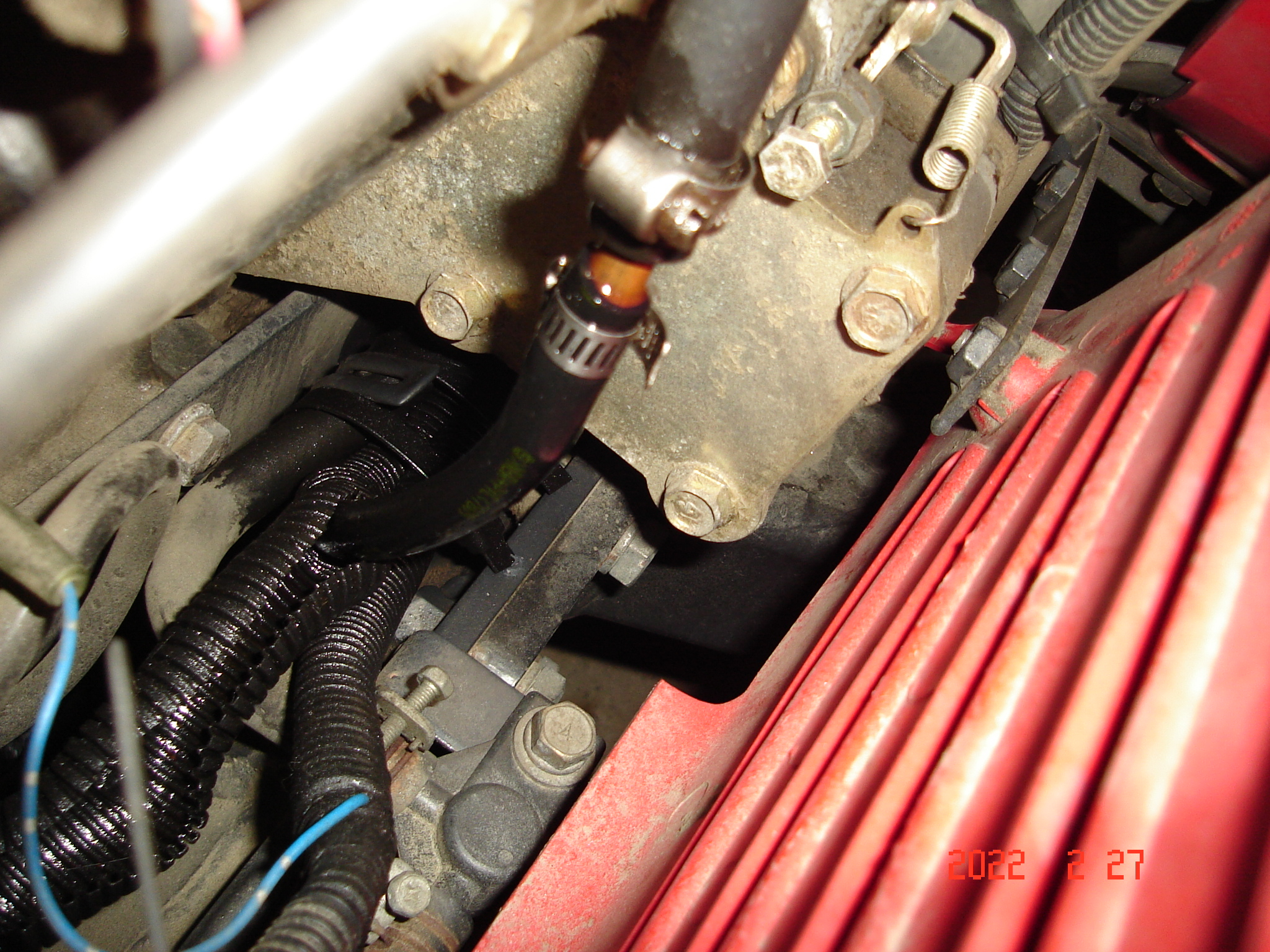

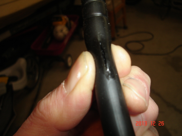

And in case people didn't see it... My 2310 had a leak in almost the same spot back in 2013 -- a bit lower, however. Interestingly, I couldn't see the damage until I squeezed the line -- then saw the vertical split.
I just cut out that last 2"+ section, spliced in a piece of 1/4" copper tube, re-used a good section of hose to re-connect. It does, however, still weep a bit, so that's not the best fix. I really need to replace that whole line!
PS -- I see, by the pic I just took, it's weeping again....

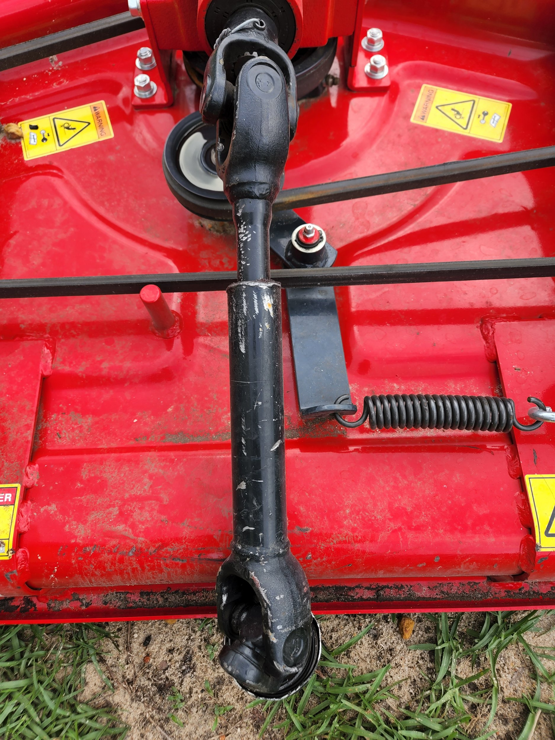

My fuel line ziptied to the left bottom framerail by MF was cut after I thought I fully attached my MMM PTO... well, it came off and ended up cutting it. Good thing that heavy armor wire wrap was put on to protect it (j/k). As exposed as thr fuel lines are under the mower, you would think... that it would be better protected. I went to my local Ag Supply store and bought a foot of hose and some clamps, cut the line in half where it was cut, slipped the new hose on yo each end of the cut line, and clamped it on snug. Done deal.
Now to figure out how to put a keyed PTO shaft, onto a non-keyed shaft. This was how I got it new on my 2326 MMM. Pic for ref after some persuasion to get them together. Dealer couldnt grasp that one side was keyed, and the other side wasnt... making it near impossible without damage to get them together. I think I will have to spring for a new half after I figure out if they installed the right shafts together. Do any of you have the same MMM? Is one side of your shaft not keyed (attaches to MMM) and the other half keyed (attaches to tractor PTO)?
