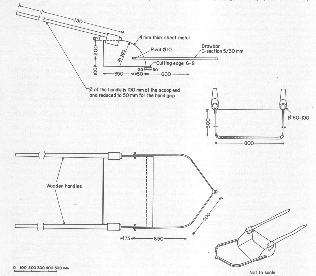

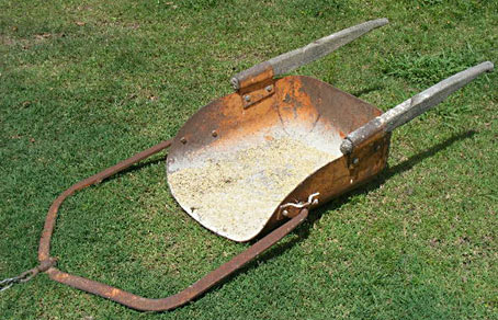

This is what my Grandfather used. :D

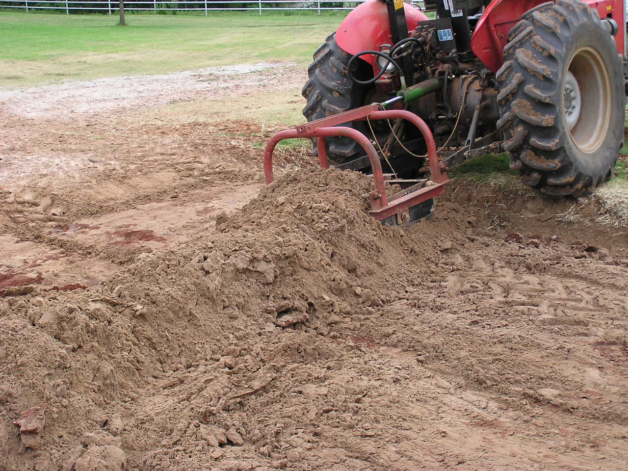

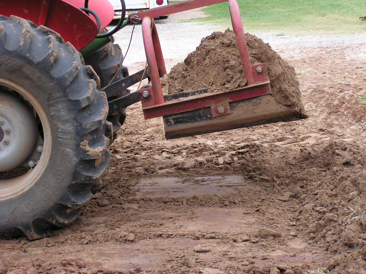

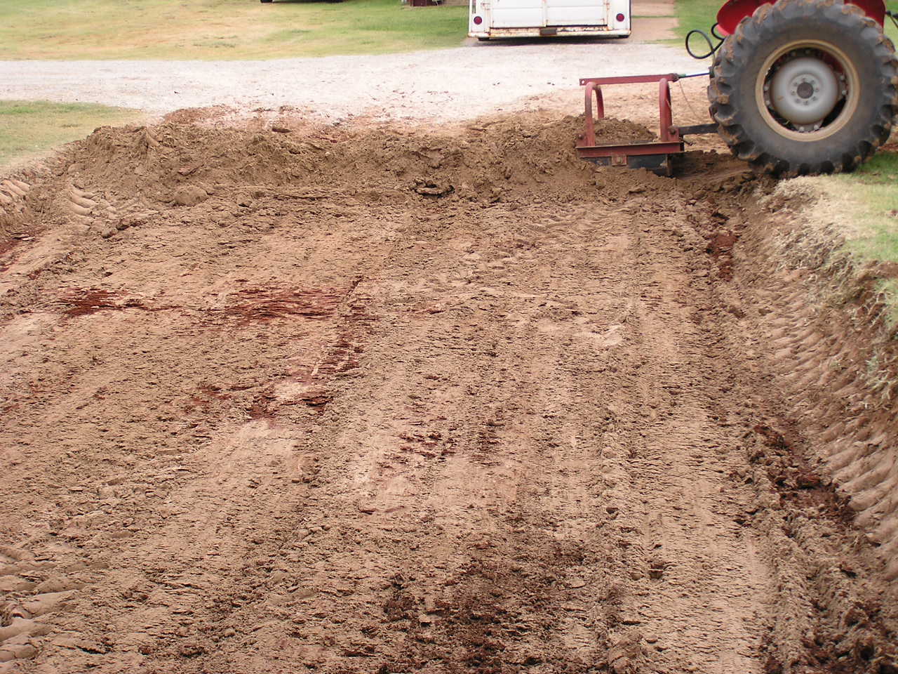

This is what I used in the past.

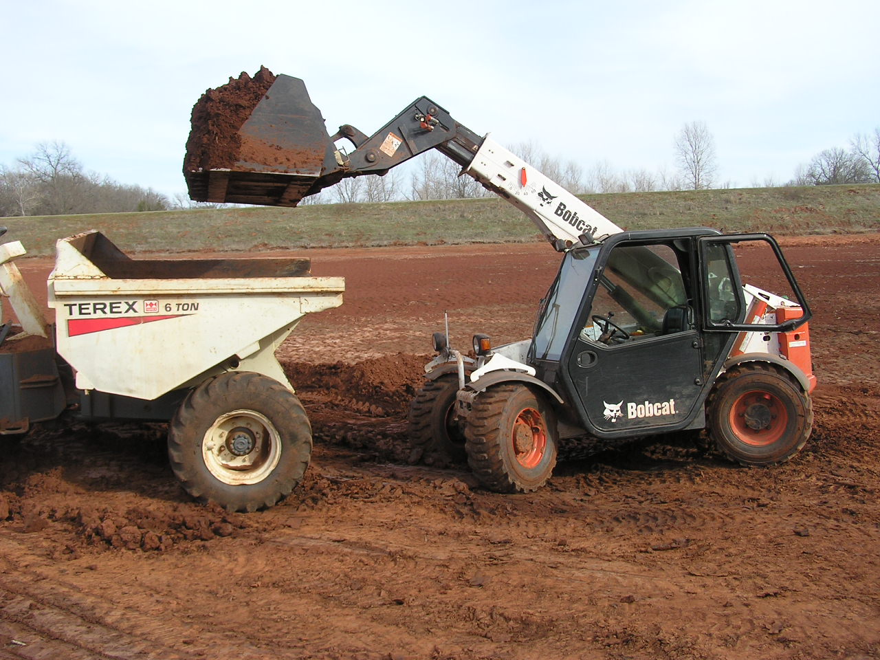

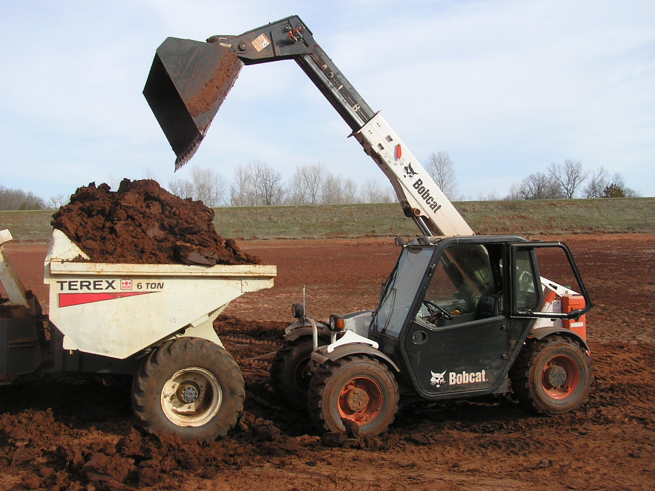

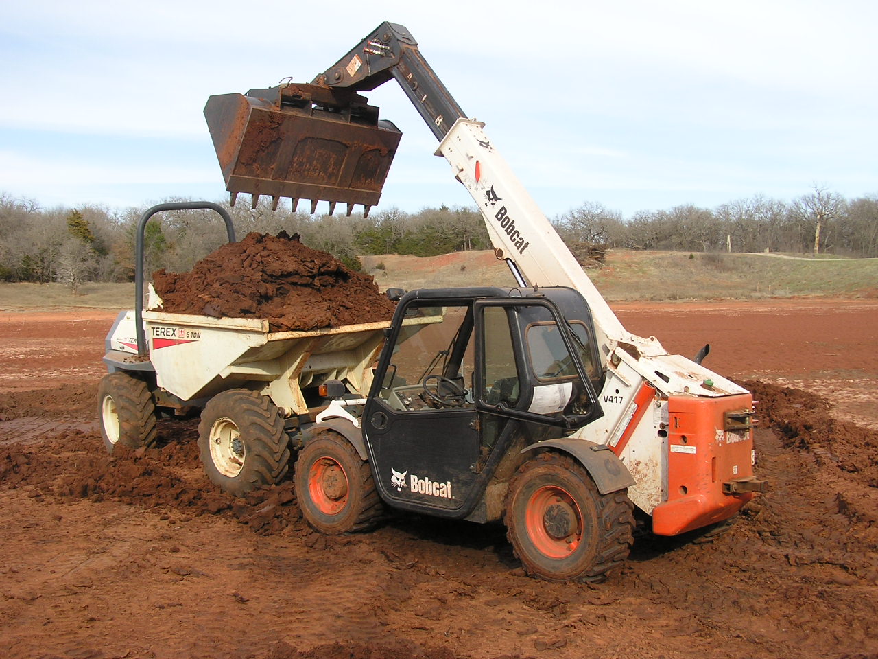

This is what I use now, a one cubic yard bucket and a Dumper.

What do you use for a ripper?
From what I can make out from the pictures you are cleaning out an existing dam which appears very shallow. Most dams I have constructed if 1000cu/yrds or over are at least
10ft deep or deeper. Measurements for a 1000 cu/yrd dam are 90x70ft top, 30x10ft floor, 10ft deep, batter slope 1 in 3.
There was no way these dams could have been built by conventional methods without the use of a good ripper, the possible exception may have been a self elevating scraper.

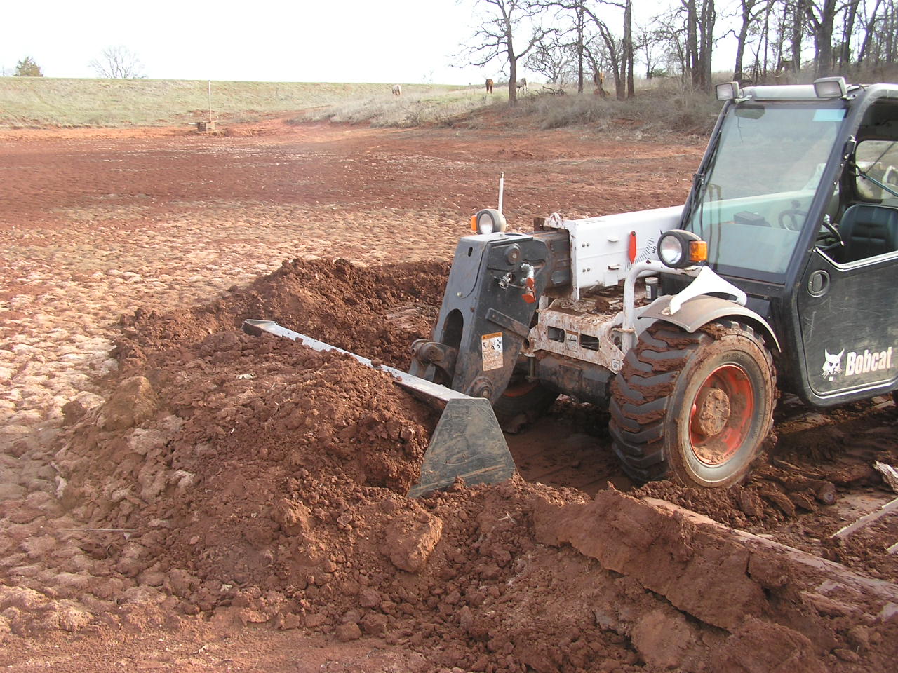

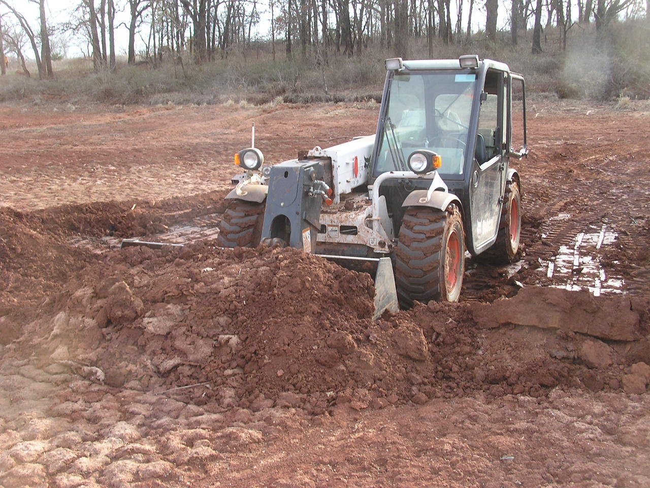

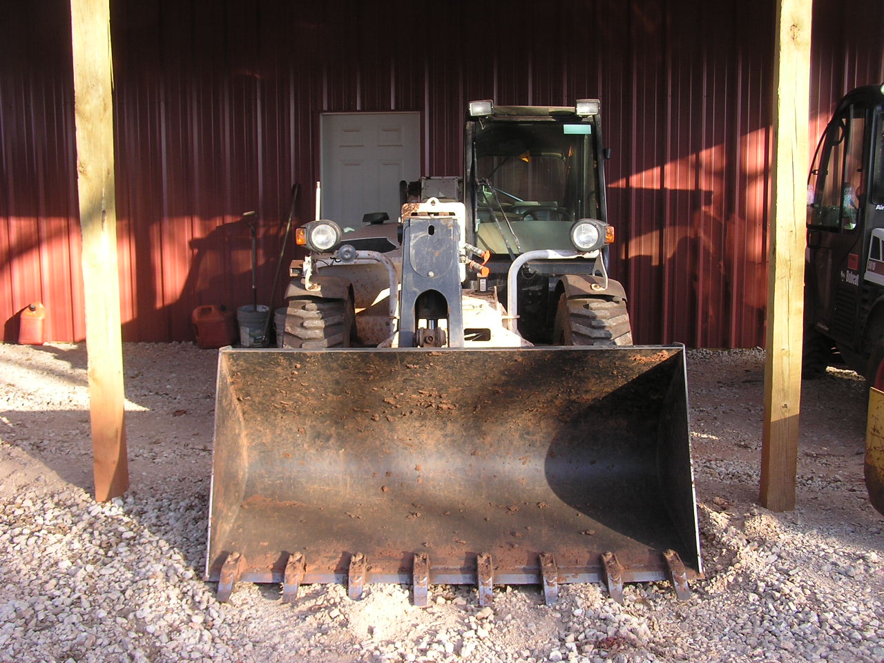

Don't use a ripper, just the teeth on the 6' wide bucket.
The V417 is 6' wide, 6.5' high and 13' long. Tire size is 14x17.5. Top speed is 15.5 mph, drawbar pull is 7,000 pounds and it will lift over 5,000 pounds!
I angle the the bucket down slightly to pull down as it moves forward and give the tires more traction. In the pictures you can see the teeth marks in the red clay. Look between the tires in the first picture and beside the machine in the second.
This area was never excavated as part of the flood control pond. I have the drain valve open and am removing dirt to fill some low spots by the barn.
Here is what the V417 and the toothed bucket will do in sandrock.
Hard to tell from the picture, but it is about 3 feet deep.

I'm most impressed with that Bobcat. Never thought they were capable of digging like that.
I loved working with the big scrapers on short haul projects like landfills, dams and road cut/fills, because you can dig and build your fill with the same machine. But, my thought on your project is that even as good as that Bobcat digs and loads, an excavator and couple dump trucks would move dirt a lot faster than a small scraper. Of course if you're working alone, I can see where a small scraper might be a better choice than running back and forth between machines.
Good luck with our build.
