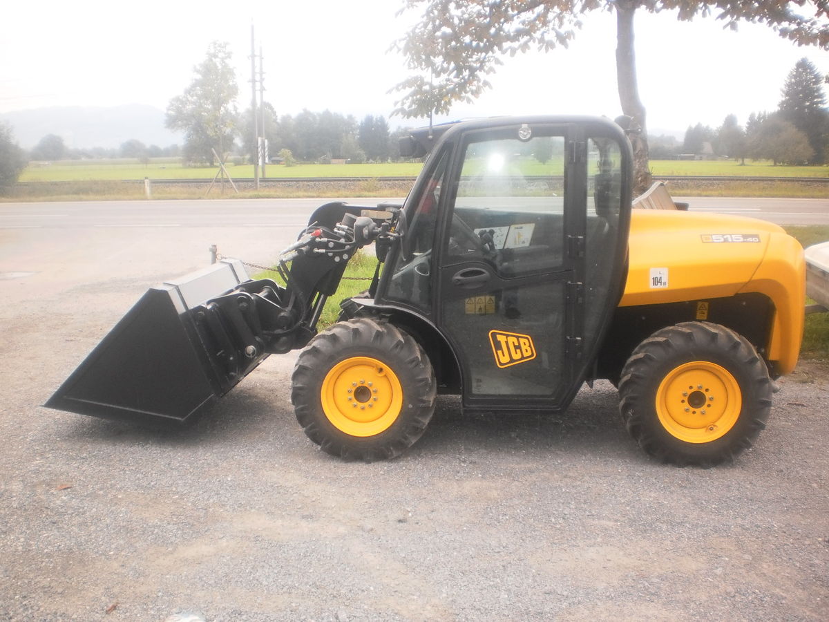

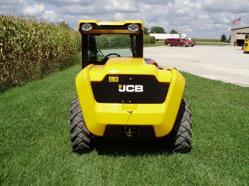

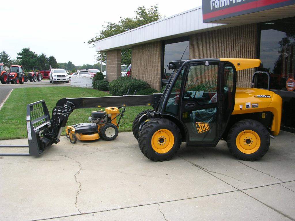

Have you considered a Compact Telehandler?
I think this is the smallest. The JCB 515-40 can lift 3,300 lbs up to a maximum lift height of 13 ft, 2 in.
Compact Telehandler Showcase - Compact Equipment

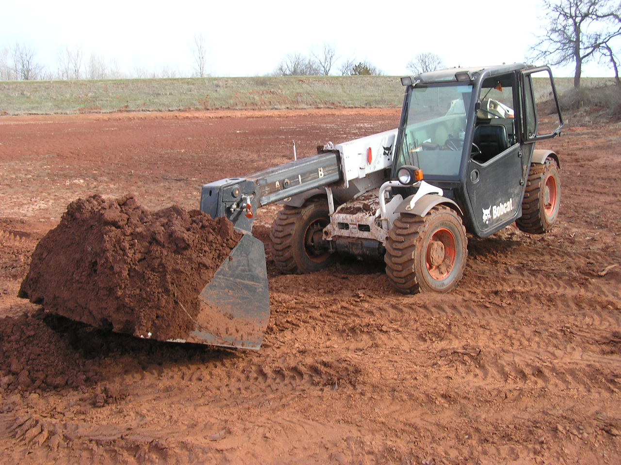

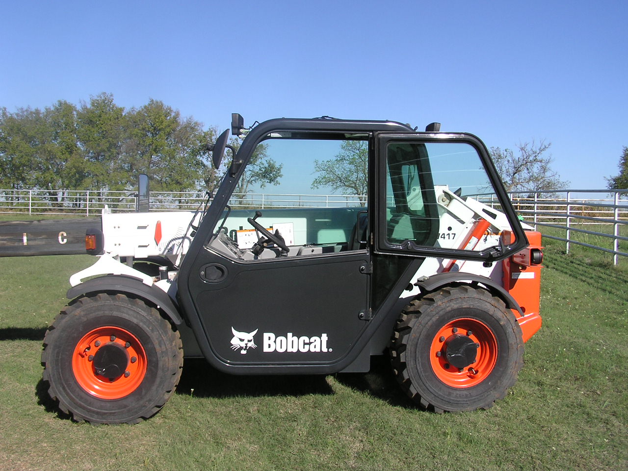

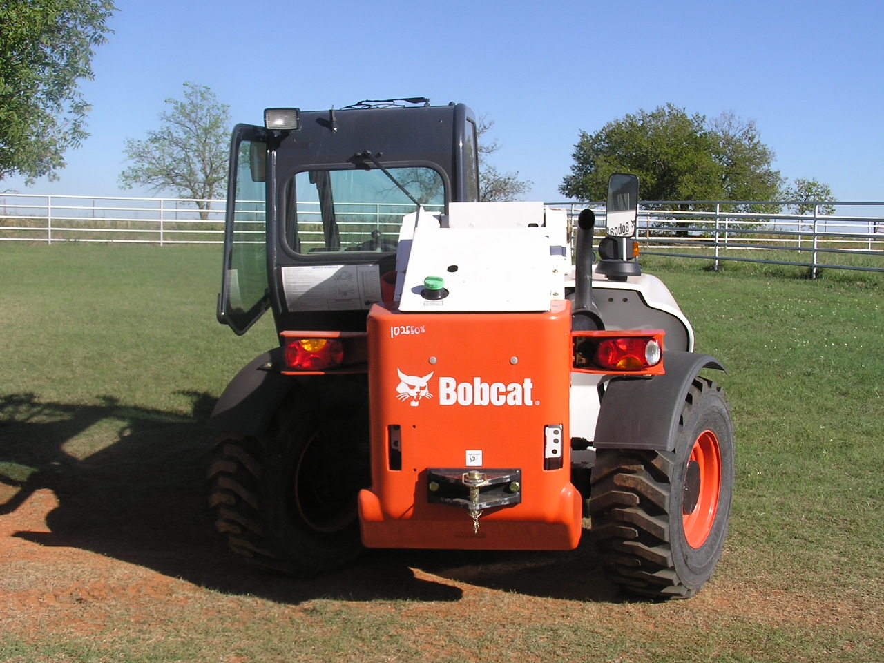

This is the one that I have, a Bobcat V417. It is 6' wide, 6.5' high and 13' long. Tire size is 14x17.5. Top speed is 15.5 mph, drawbar pull is 7,000 pounds, boom breakout force is 6700 lbf, bucket breakout force is 4700 lbf and it will lift over 5,000 pounds, 17 feet high. It has a skid steer quick attach plate, so your attachments would fit it.
