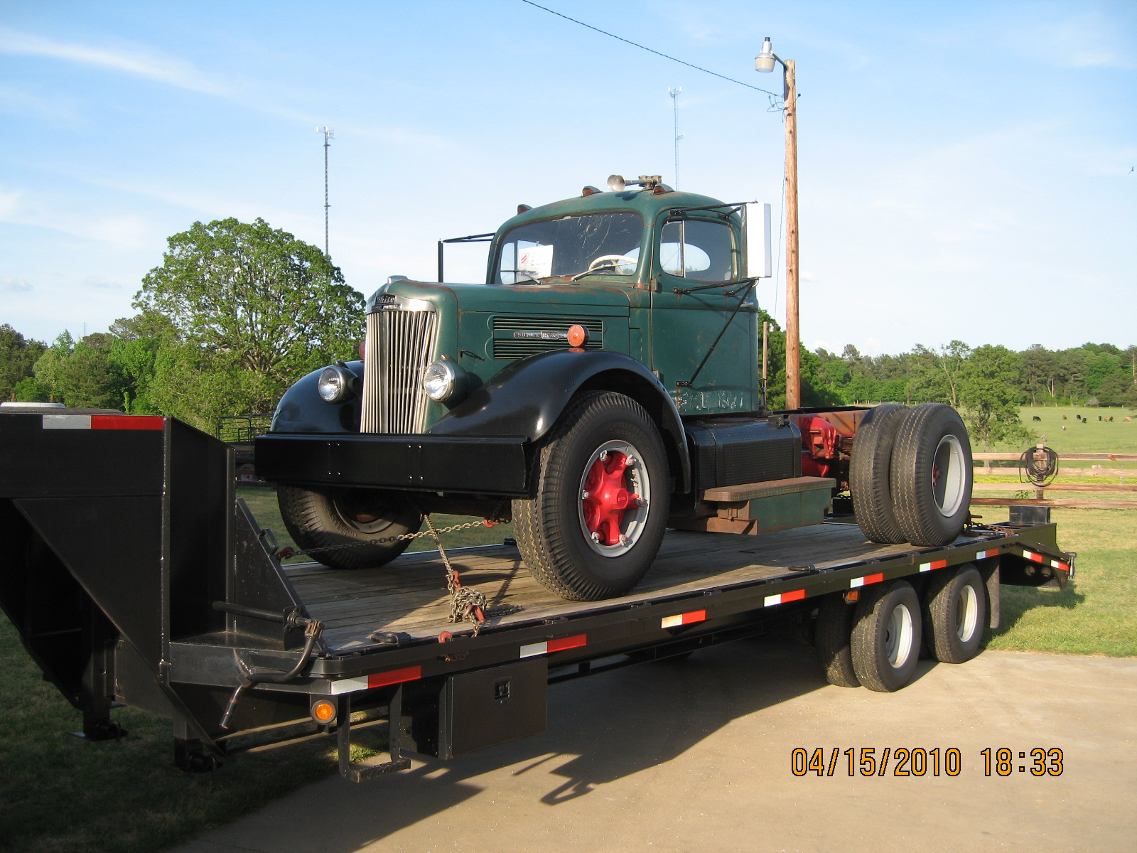

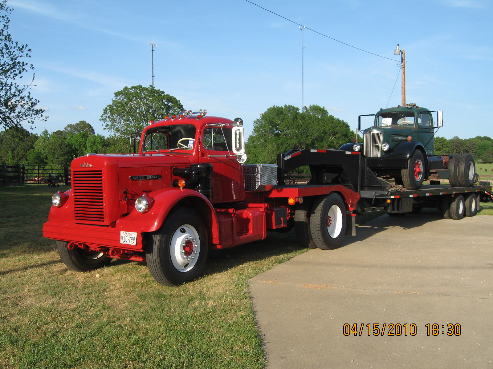

I've got D rings on my trailer but I usually just wrap the chain around the stake pocket, keeping the chain inside the rub rail and either hook to the stake pocket or back to the chain.

Isn't your tractor on the wrong side of the trailer? Although, it probably gets terrific fuel mileage that way :D
It gets great mileage that way. Red, on the other hand, doesn't do nearly as well.
You have opened a new can of worms.
I'd love to see more pictures of both of those tractors. Very nice looking machines.

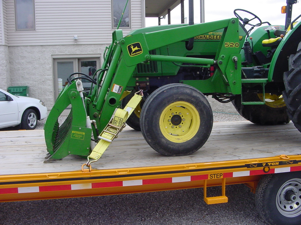

I have both rub rails and D rings. Both come in handy. I find I use the D rings most though unless I'm using chain. Most of my tie downs aren't the flat hook so D rings work well.
