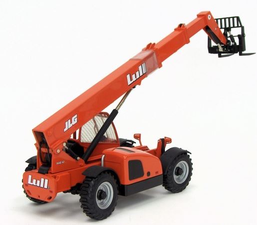

Makes sense. So I can limit the retract rate by limiting flow, the easiest way would be to restrict the hose size. Is this typically how retraction rate is controlled? eg a boom fork lift or boom truck.
I'm designing a hydraulic system and am having retraction speed challenges.
42' 9000 LB FORKLIFT - Runyon Equipment Rental

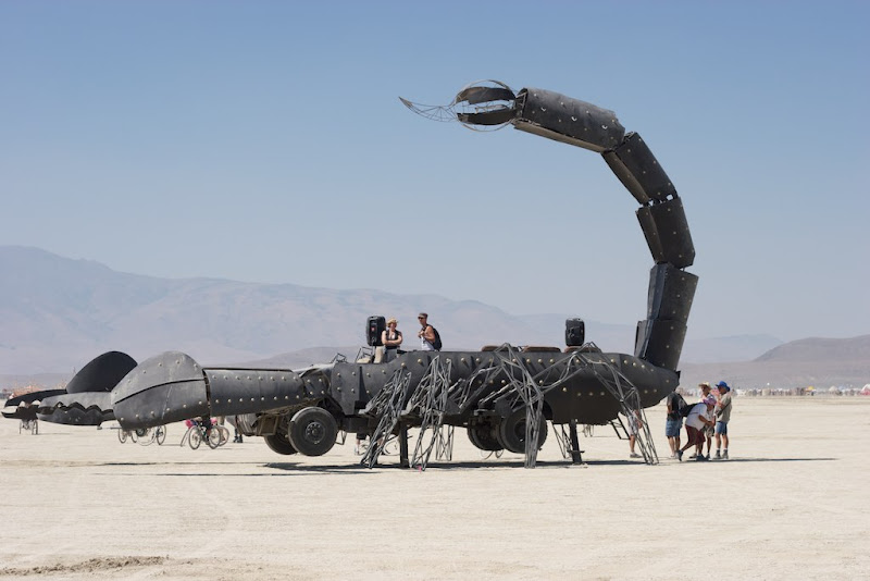

I'm looking to slow the speed during the compete travel. Gravity is working against me in this case so I am in a "runaway" condition. Reading about counterbalance valves it looks like this might be the right application for one. This will create back pressure on the cylinder to control retraction.
It seems like a needle valve will give me more fine tune adjustment on the retraction.
The tail lowering is what I'm working on: http://lh6.ggpht.com/-KU-Roo_bFHg/T.../uI33KZ7UdR4/s800/6117802511_5958062cc0_o.jpg
