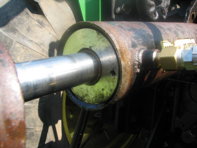

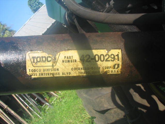

This is the cylinder that has been used for a top link. It was used cylinder and retrofitted years ago and has worked fine except it has always leaked a little. Getting worse and it is to the point it needs rebuilding. The rod end cover had two 1/4" bolt holding it on which I removed. I put the two bolts back in the cylinder to screw it out. Turns freely but does not screw out or in? How does it come out? Where can I get a rebuild kit? I have looked with no luck? This is the first cylinder I have tried to rebuild and I'm already lost? Thanks for any help, Mitch

Does the gland push in? I am thinking there is a internal snap ring that keeps the gland from coming out.
You probably won't be able to get a "kit", but once it's apart the a local hydraulics shop should be able to match them up. If you chose to buy online you will need to be able to accurately measure the seals, A great place to buy from is www.herculesus.com

Kenny nailed it. Spray some good penetrating oil around where the gland meets the barrel, wait about a half hour, and tap the gland down the barrel until you see the internal snap ring. Remove the snap ring and use the rod like a slide hammer to knock the gland out. Oh, one more thing, get that brass fitting out of your system.

Used Kenny and Andys directions and it came apart easy. I will take it to the hydraulic shop next week to see if they can match up the seals.
The fitting are for sure brass. They may be the high pressure ones like J.J.'s talking about but I'll change them out while I have everything apart just to be sure. Thanks, Mitch

I took the cylinder parts to Coastal Equipment & Hydraulics in Cantonment, Florida today. Wally was the guy that helped me and did a first class job of getting everything I needed and took the time to show me how the seals fit. Total bill $47.48 including new steel fittings. Everything went back together without a hitch. I hooked up the 6' bush hog and left it hanging for over two hours with no leak down. Thanks again for the help. Congratulations to you KennyD on being the member of the month. It is easy to see why you were chosen. Mitch
